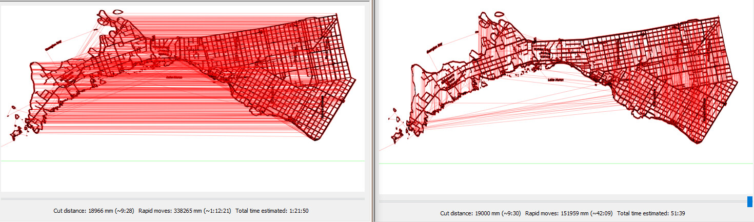

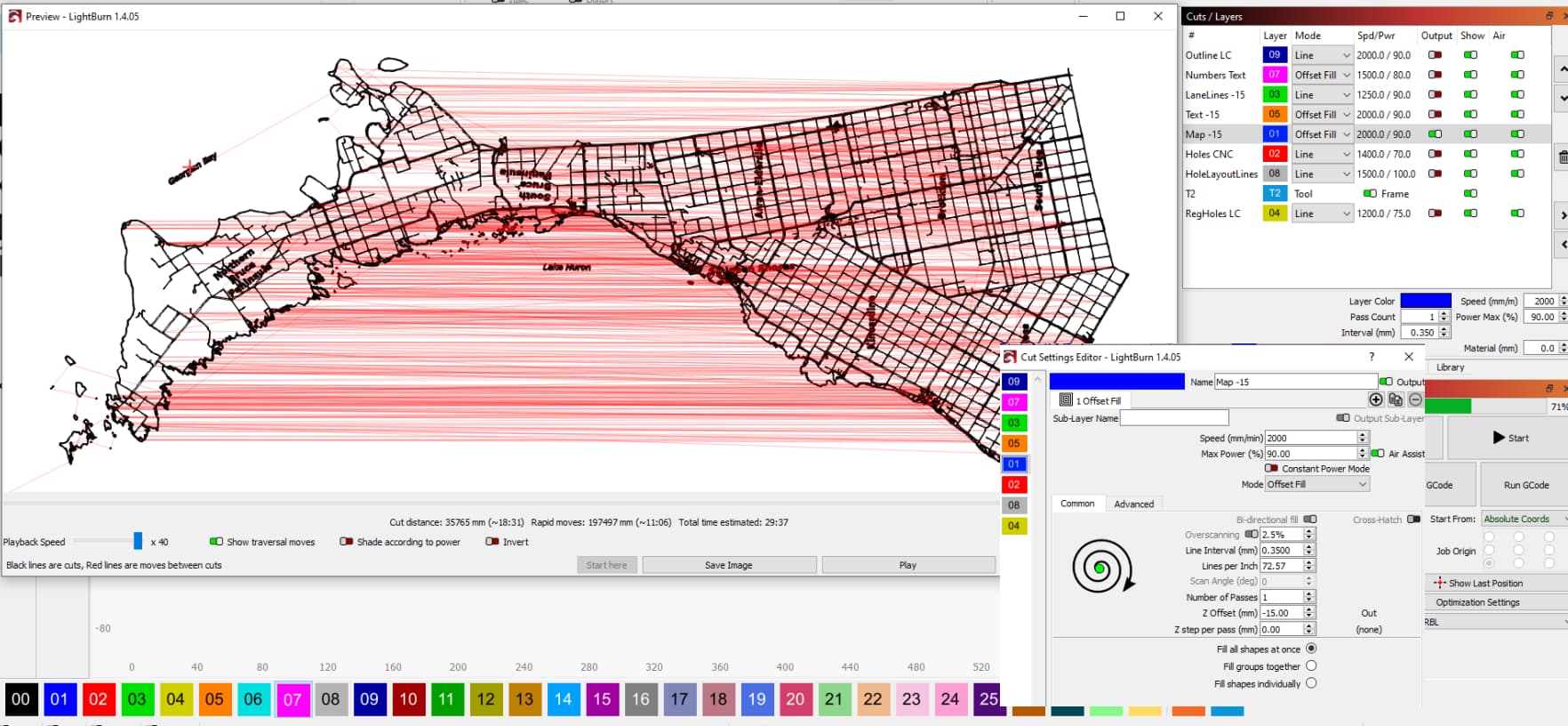

I’m hoping someone can make some suggestions on how I can optimize this Offset Fill map. I have adjusted almost every parameter I can find in Optimization Settings and in the Layer properties but it still has a crazy amount of Rapids (travel).
Go back to Fill and select FLOOD FILL from the advanced tab. Some shapes do not play well with Offset…
Thanks for the quick response. I was optimistic ant tried your suggestion. Unfortunately it was much worse.
At 0 and 90 degrees, Rapid/Travel time went to 9:28/1:21:50 and 42:09/51:39 respectively.
You can also mess with the fill shapes and see which gives best results.
What do you have for optimize settings? Some shapes are inherently bothersome for the program. You may want to cut the project in half left-right and print as two or even three separate objects.

Probably you have chosen offsetfill to achieve some thickness of your lines.
If you separate the text from the lines in different layers, you can defocus your laser until the desired line wide, Power also needs to be adjusted to the changed focus.
I think Offsetfill is not designed for the type tasks like what you work with.
I have done what Bernd suggest (line mode, defocused) with nice line quality up to about .5mm wide and acceptable line quality (soft edges) up to about 1mm wide. I have never done it on something this intricate, tho. I did it to save time on a repeat job. It has widely and irregularly spaced “accent” lines across an entire nested workpiece that is otherwise all thru cut outlines. Although, having a powered Z makes it a breeze. If I had a manual Z, I’d probably do it differently.
An offset with approx. 0.2mm and a little defocusing will also do it, it takes so the dopeled time but can achieve slightly sharper edges.

and the Rapid moves time only changes by a few seconds.

LB certainly does struggle with generating tool paths for large complicated shapes like this one.
When the object is rotated 90 the travel time goes from 11 minutes to 4 minutes.
So it seems LB has a left-right bias when generating tool paths that I can’t beat out of it with any cut or optimization settings. Theoretically, the object’s orientation shouldn’t affect the tool path generation.
Yep, defocusing is a is great time saver but doesn’t have much of an impact on Rapid/Travel move times.
The original image shows the cut settings where it is defocused by 15mm allowing for a Line Interval of 0.35mm.
I think I’ve lost you. If your entire road network is in line mode there shouldn’t be that much empty travel.
Which theory is this? If you rotate it 90 deg, the travel path is much shorter… The red lines are the transversal movement. If you preview them, the paths will be shorter and therefore quicker.
Sometimes it’s worth rotating the material and the graphic, then engraving in the most practical and quickest direction.
Simply put, the more time it spends over the area that need to be lased the quicker it will run. As your shots show, it’s transversing a large area with no actual work being done… it takes time to do nothing.
