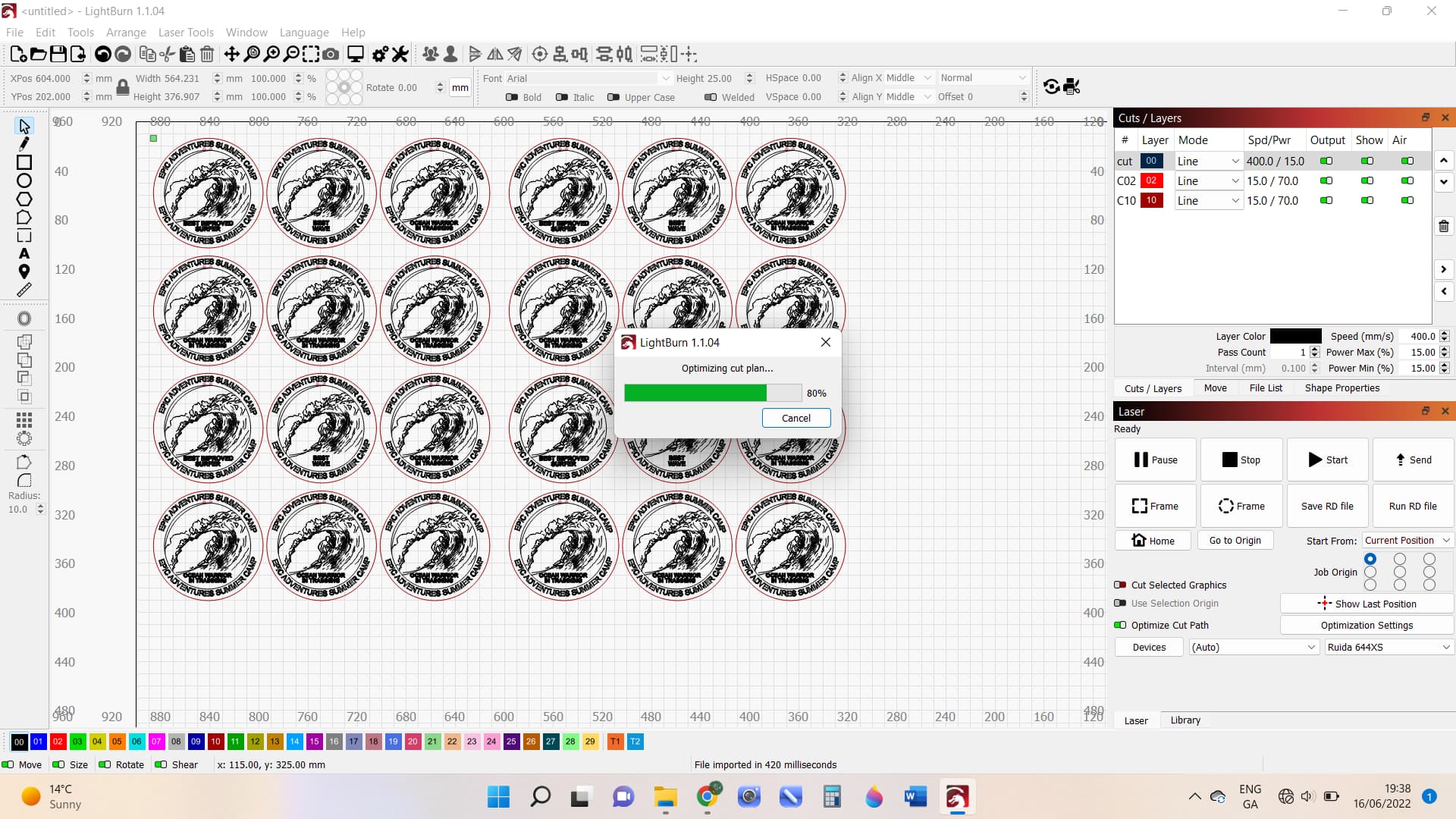

Optimizing cut plan takes forever after downloading new update 1.1.04
please help
ive just downloaded the new update and the optimizing cut plan is stuck on 80 odd % for ten mins now
any ideas please
the op settings are on default
Please post this file, so we can take a look. You could also try this as a ‘Virtual Array’ to see if it produces faster. Modifier Tool - LightBurn Software Documentation :slight_smile:

still takes forever, ca 30 mins
The file didn’t attach. I’d like to see what’s happening here too.
