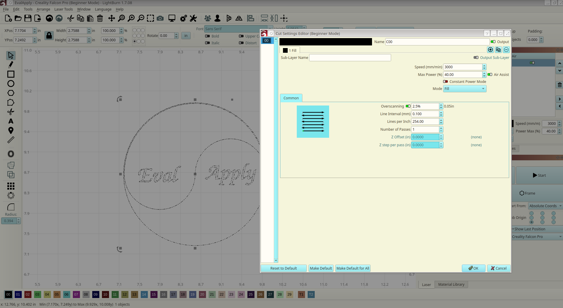

That looks exactly like what I need.
However, it appears that it’s in an “advanced” tab that I don’t have.
You are in ‘Beginner Mode’, switch that off via general Lightburn settings (the Cog’s icon)
Thanks! All is well now and I’m making substantially faster projects.
