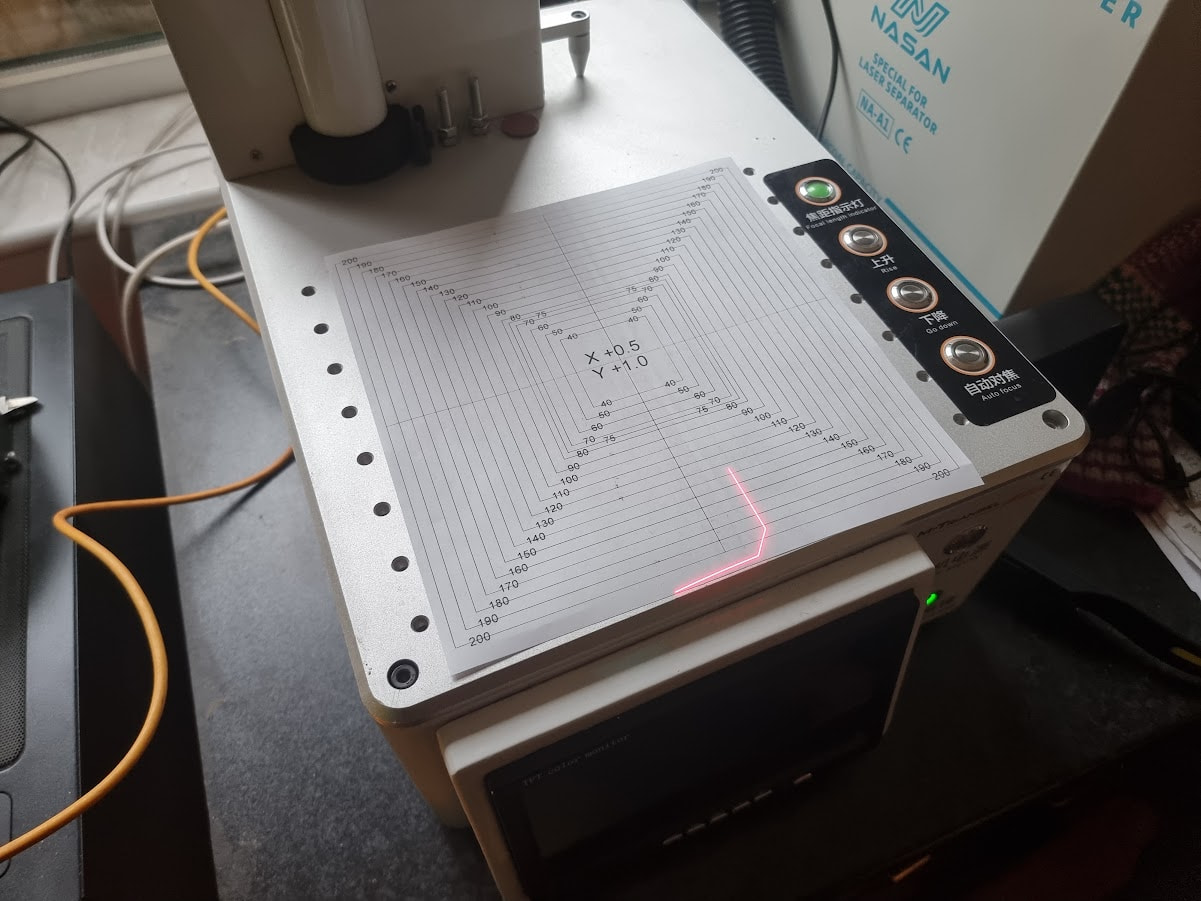

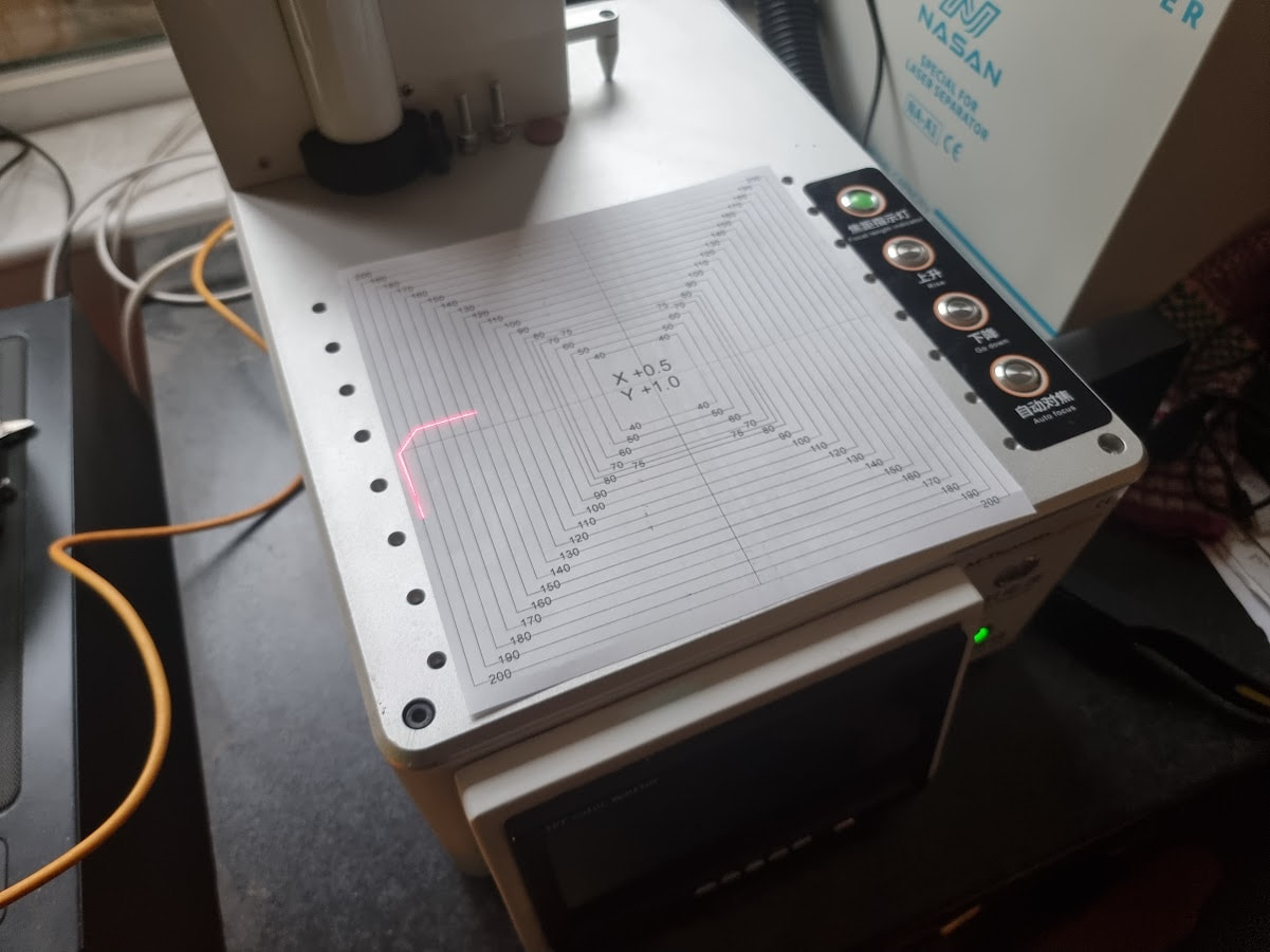

Trying to do 9point lens calibration, but it frames way off-centre and way off scale.
Machine detected as BSLfiber, origin left-front (lower left corner). Working area set to 175mm (lens size), box to output auto-sets to 150mm. It frames on lower left corner, nearly off the plate and way smaller than 150 (100ish?). Any way to shift all of that to the middle of the plate ?
I’m not given any options to move calibration area ?
If i draw in a square by hand, center it to page it will draw centered.
Below is how it frames before burning 9point test.
I guess manual alignment it is for me. I cannot force LB to do the 9point test at set size in the centre of the workbed. It always frames lower left corner much smaller than its supposed to. Focus is correct for the lens installed (F254-175).
Might have something to do with weird control board, i’ve no clue what it is, just that it is detected and functions in LB (BSLfibre). Another weird thing is is that i cannot change framing speed - changing numbers doesnt change anything.
