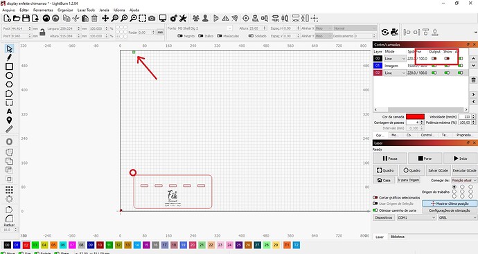

Origin of disabled/invisible layers
There is some way to make a disabled, invisible layer not be takken in account by origin calculation.
Im new to lightburn, and i like to be able to disable/hide some layers and cut only the visible/enabled one. I dont use lightburn as controler. I use it only exporting the gcode to a sd card.
You can do this by enabling ‘Cut Selected Graphics’ and ‘Use Selection Origin’ in your Laser window, then selecting only the graphics you wish to output to your laser.
