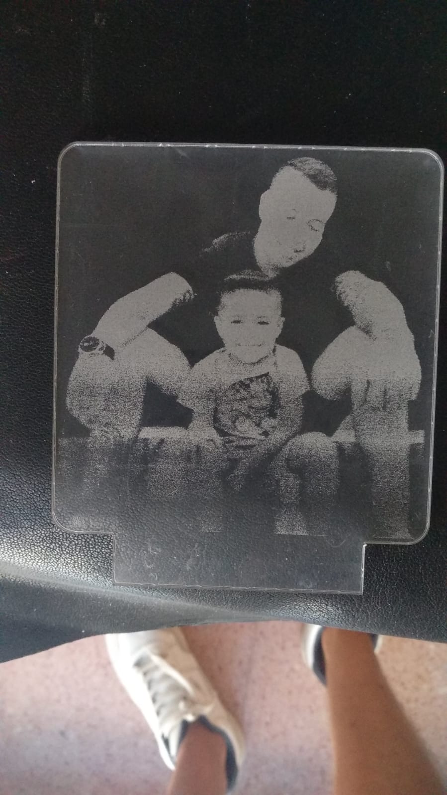

Hello, I have an Orion Motor Tech 1000W machine that, for no apparent reason, stops engraving sharply. I have aligned and cleaned the mirrors, cleaned the lens, and I’m using a 5200W chiller. What could be happening?

I assume you mean you have a 100W laser.
Have you made a shot on a test plate on mirror no.1? - How does it look…
A slightly more specific description of the problem will help in troubleshooting.
Don’t really see a sharply stopped image…
Maybe a clarification of exactly what’s happening.
I think @bernd.dk is advising you to check for tube resonance (mode) or TEM state, taken at m1. If it isn’t TEM00 state, your tube has a problem. You want’ a light color in the outer area getting darker towards the center. Not a hole or a black burnt spot.
