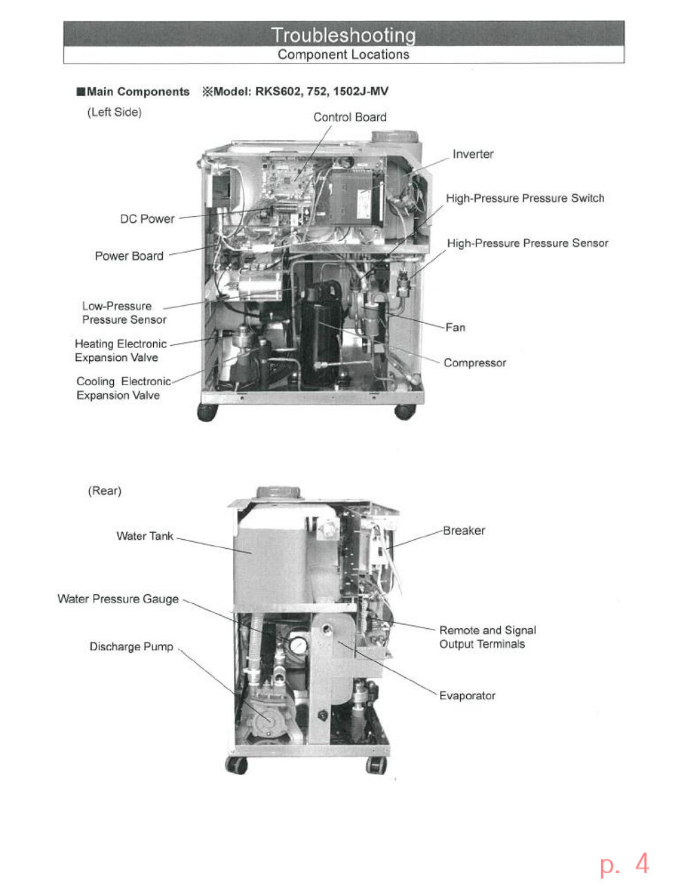

From the manufacturer
Not all manufacturers provide this type of detailed information!!! Not even at a professional level. As a rule, they recommend handing over the equipment to a brand representative for repair.
