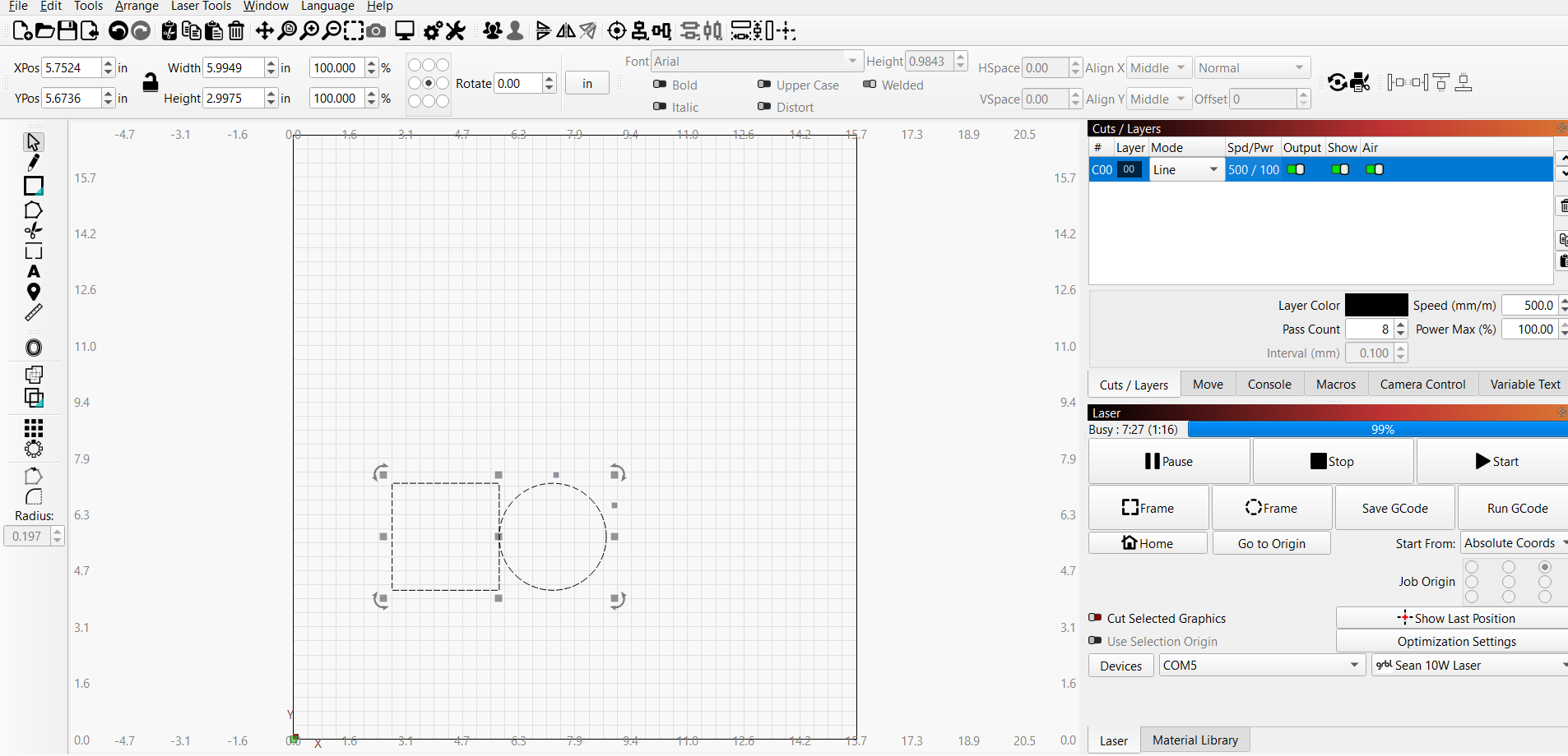

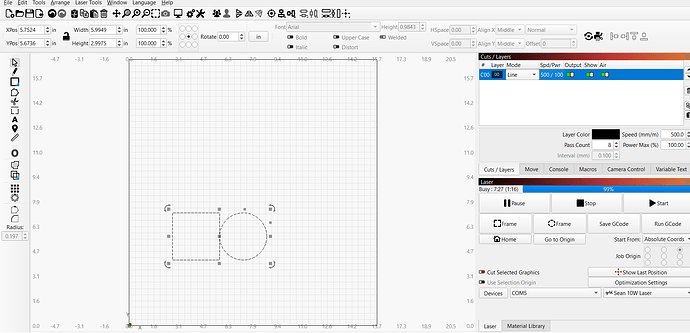

My lightburn did an update and now my laser isnt engraving or cutting. Im using an ortur LM2 and I even set the power to 100% and nothing. Sometimes I may get faint lines. It was working perfect prior to the update and its barely used.

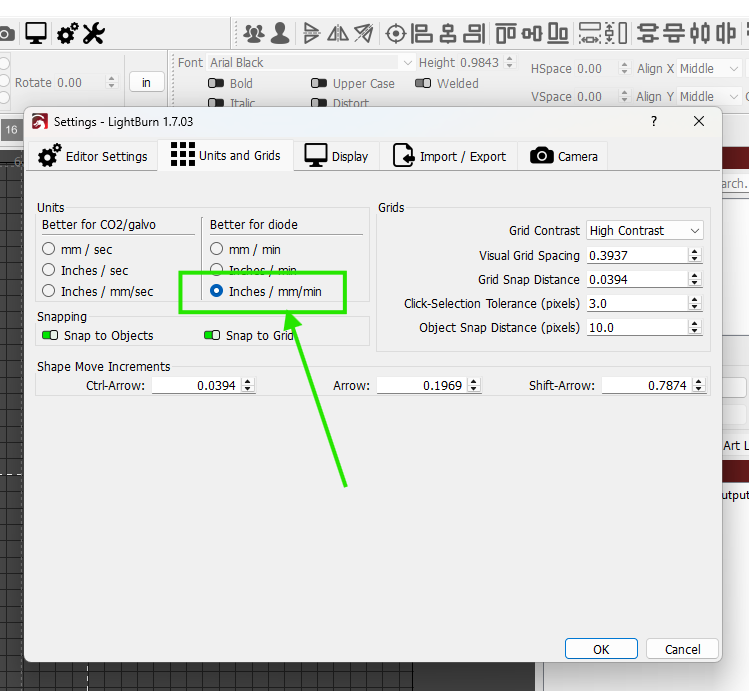

Check to make sure your units are set to mm/min.

They are set to mm/min. After further testing it will loose power as it moves around on the engraving area. If it does a straight line where it only moves front and back it will work but if it goes left to right or does a circle it wont engrave at all.
Check HERE…
