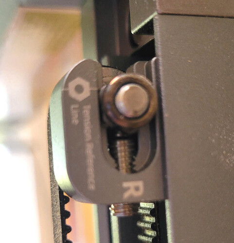

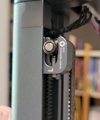

Hi Nicole,
Could you take a picture of each side of your Y belt tensioners?
Hi Gil, see attached.
N
You need to tighten belts a bit more
The little screw should be all the way in
Hi Gil,
Agreed, thanks for pointing this out! No impact on the problem I am facing unfortunately! I should point out that when I start the laser, there is no carriage movement at all, so even with a bit of a loose belt, the servos would not have had a chance to sense that. Something else is up…need an error code decoder ring or something like that… :wink:
