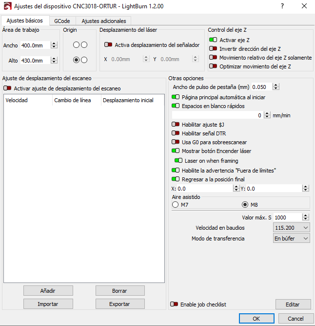

I’m trying to make a circle
GCode Generated
; LightBurn 1.2.00
; GRBL device profile, absolute coords
; Bounds: X182 Y196.5 to X218 Y233.5
G00 G17 G40 G21 G54
G90

; return to user-defined finish pos
G0 X0 Y0
M2

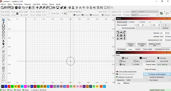

Sometimes he throws this at me
G90
G0 X-30.335 Y-7.911
M2
As I understand it is launching very high values at the beginning and negative values at the end of the job.
Any help or background on how to solve it, I’m very grateful.

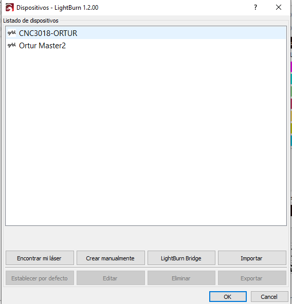

Return position after job completion is defined in Edit->Device Settings. Change value there.
is x=0 and y=0
Can you confirm you’re always using Absolute Coords?
Under what conditions does it give you the unexpected finish position?
If I always use absolute coordinates.
It happens to me when starting or ending a recording
Before I had a CNC3018 configured that works super well, I edited the dimensions so that it works like the ortur and I have already sent 2 jobs without problems
Is the return issue a problem with 3018 or the Ortur? I assume 3018.
Do you have limit switches on the 3018? If not, are you making sure to manually home the laser?
the problem is with ortur.
Can you check return position for Ortur Device Settings? The one you attached was for 3018.
Apparently it works fine sending jobs, it moves fine in x and y, and I no longer have alarms.

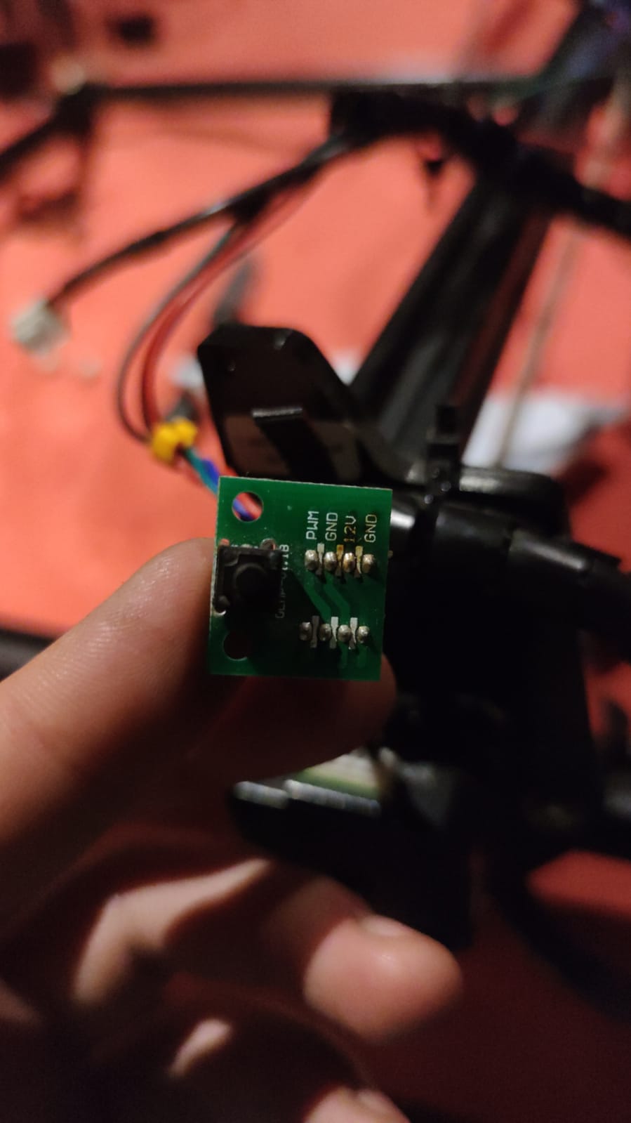

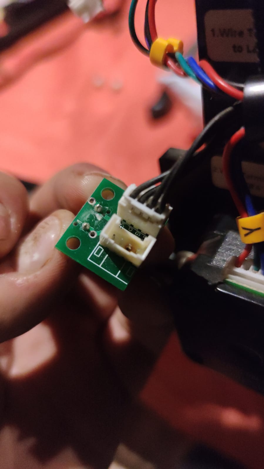

Now the advance laser turns off and it is due to a short circuit in the connection plate of the limit switch and laser.
Where can I get a replacement?
See if you can source one from Ortur. Else you could probably buy separate limit switch and adapter for laser.
Or, if the switch still works could you directly wire the two laser ends together and leave the switch just for limit purposes?
First I searched the internet for the serial number and I did not find anything about it and I already wrote to the people of ortur, also the board damaged the laser connection board.
The other laser that I have, even if I put 100% power, is not capable of burning the paper.
I will see how to connect everything without going through the plate.
Thank you
In what way is it damaged? I know Neje units were getting fried from back current from stepper motors being moved manually.
I do know that Ortur will sell the laser module board but may not be worth it if your module is fairly old.

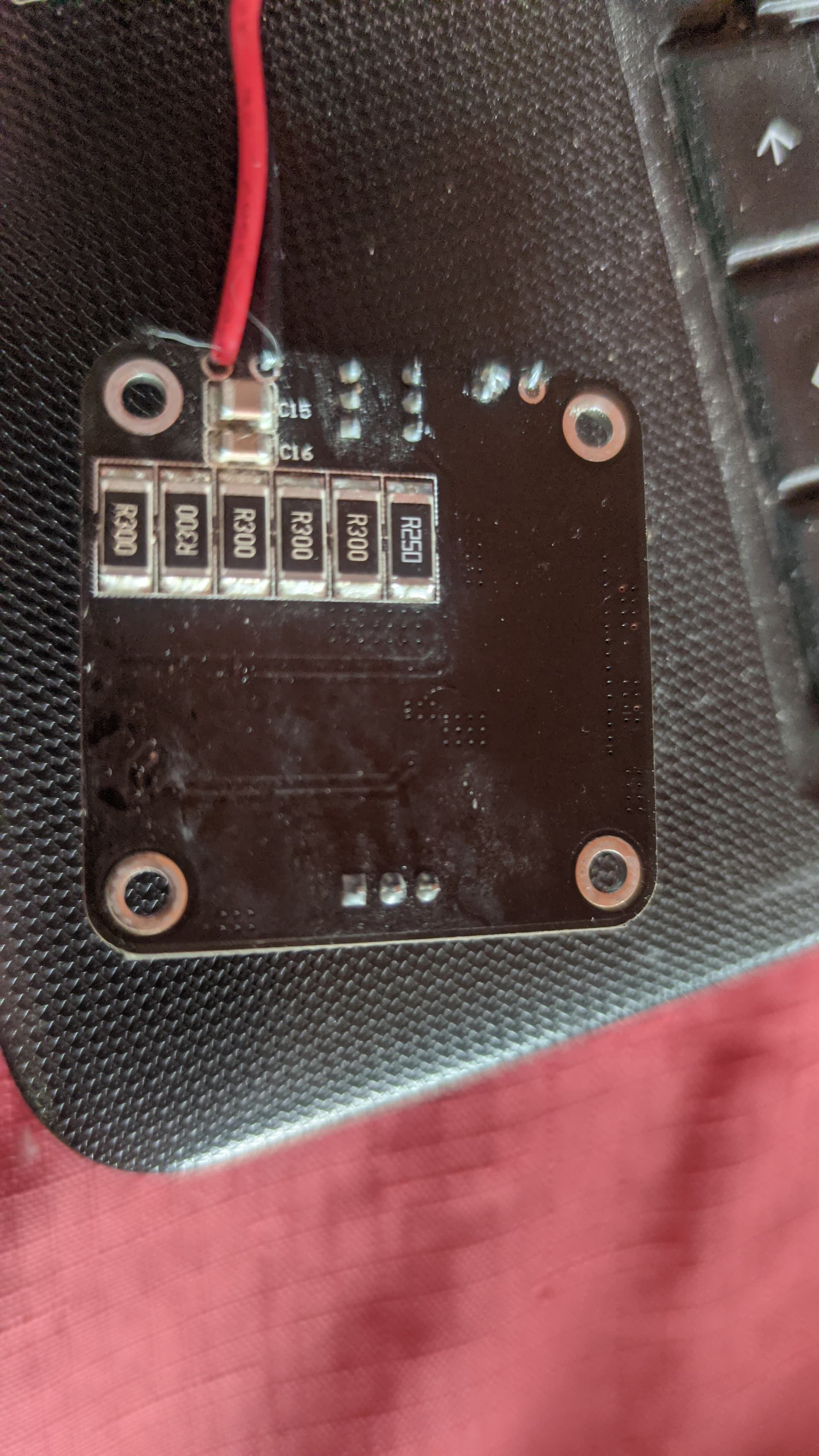

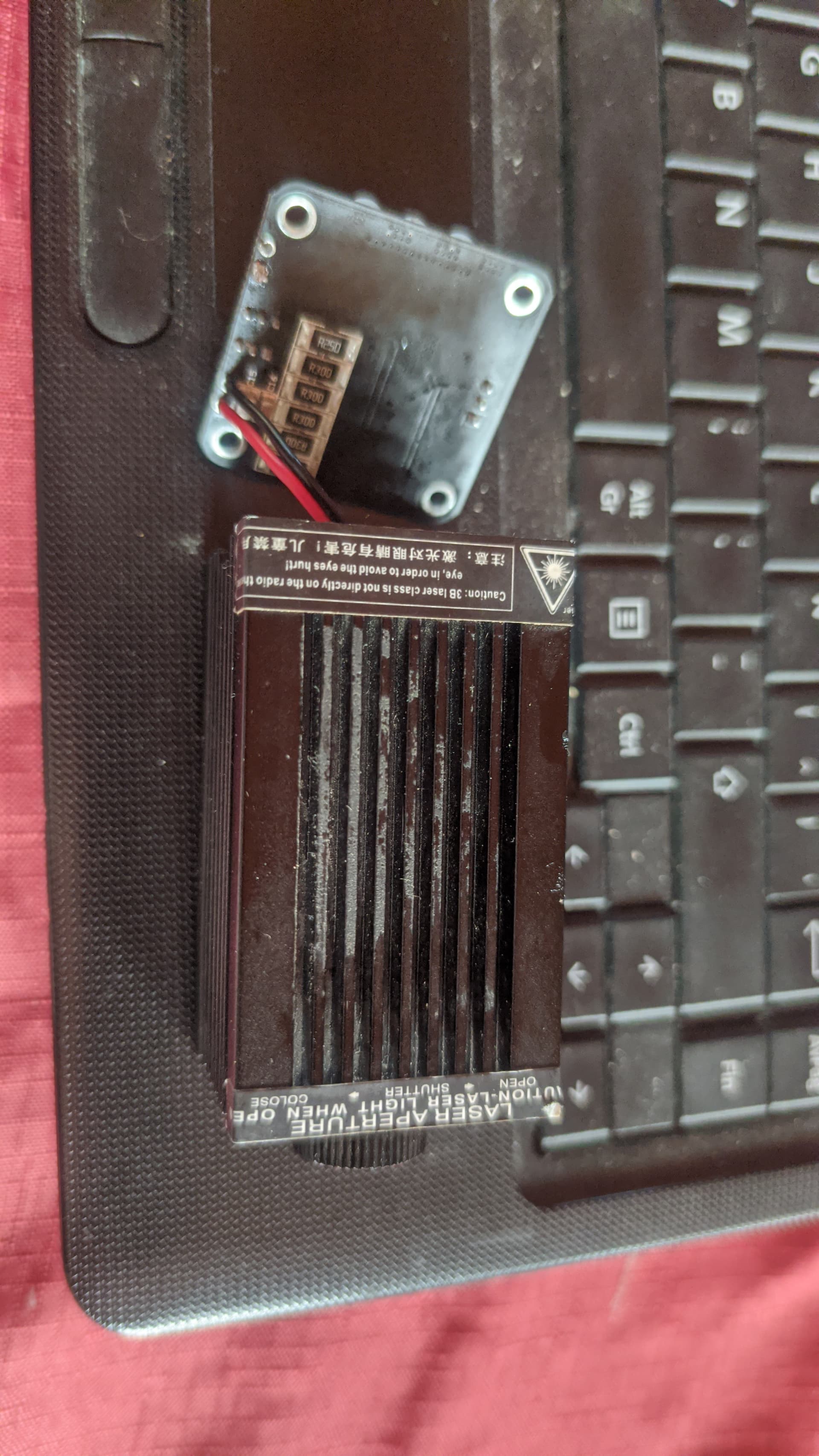

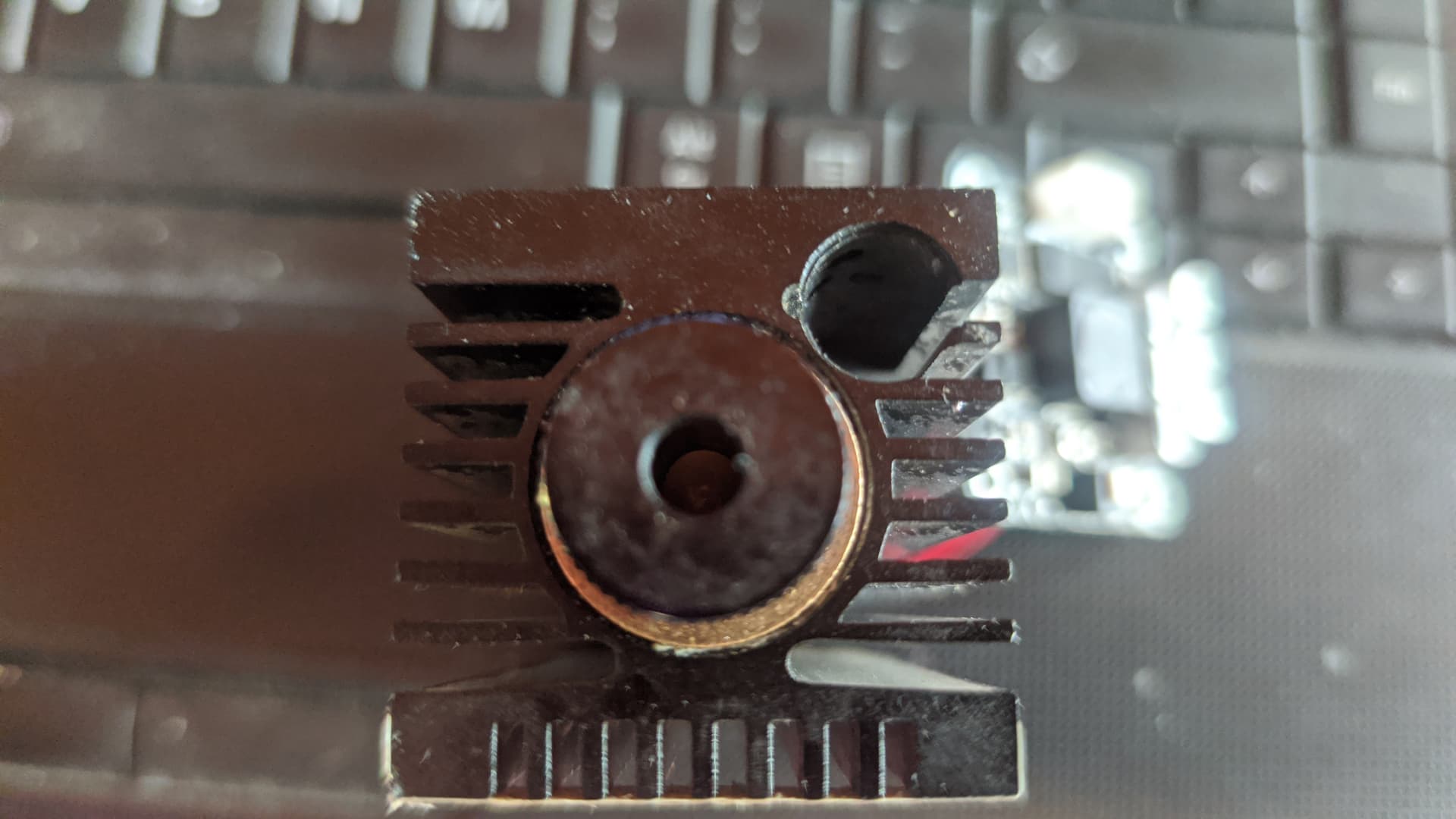

The laser model that I uploaded above, turned on this morning but it doesn’t turn on anymore, I noticed that when I “move” the connection plate cable a little it turned on and then turned off.

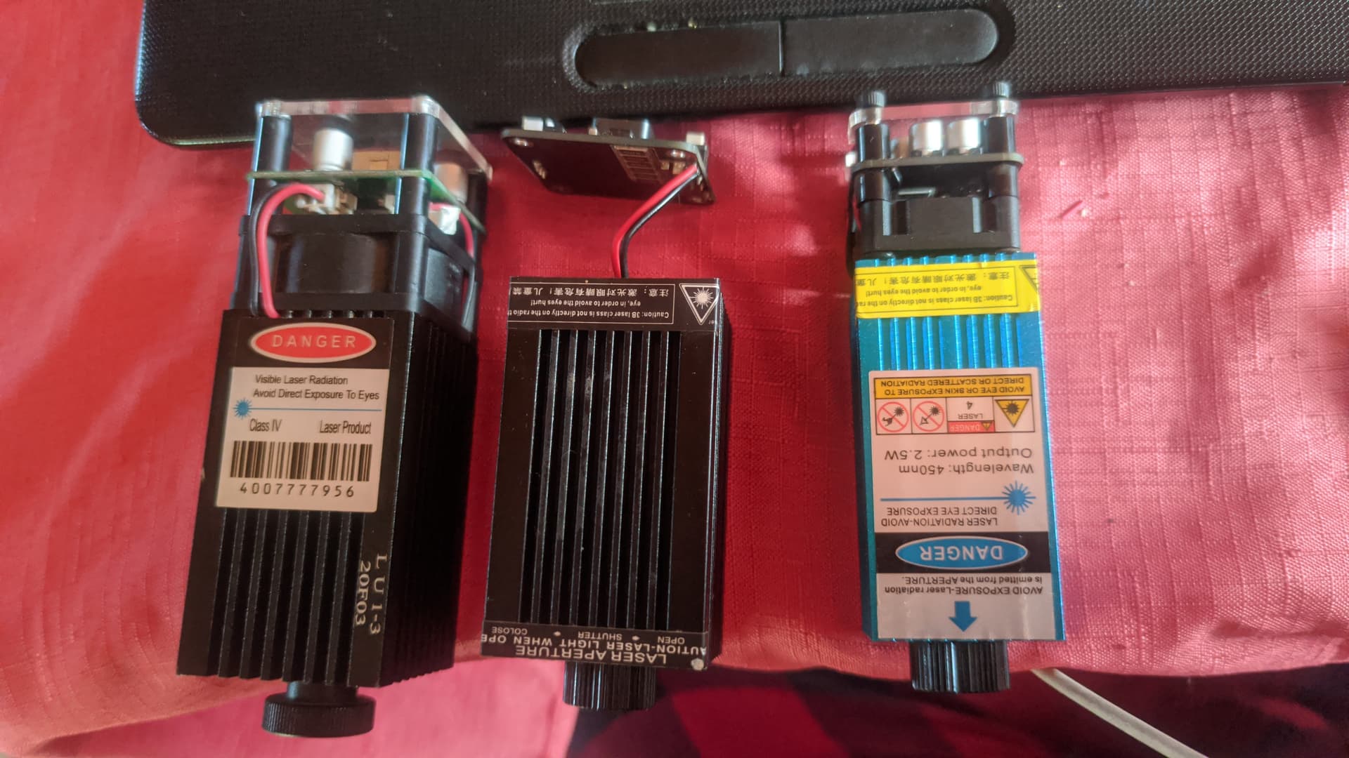

I have this other laser module
I connected it but it is very high and it is not able to burn the paper, then I remove it and send it to record with 100% and I manually moved it down, approaching a paper but it does not burn either.
I think it all has to do with the connection board, maybe it doesn’t get enough power.
You say I should buy a new laser?
No. I was saying that the board on the top of the laser module Ortur will sell replacements for. It may or may not be worth it to do so if the laser module itself is old since the diode itself may be fairly tired.
If the connection is not solid then this is possible. Try the laser module on the 3018 to confirm the laser module is working fine.

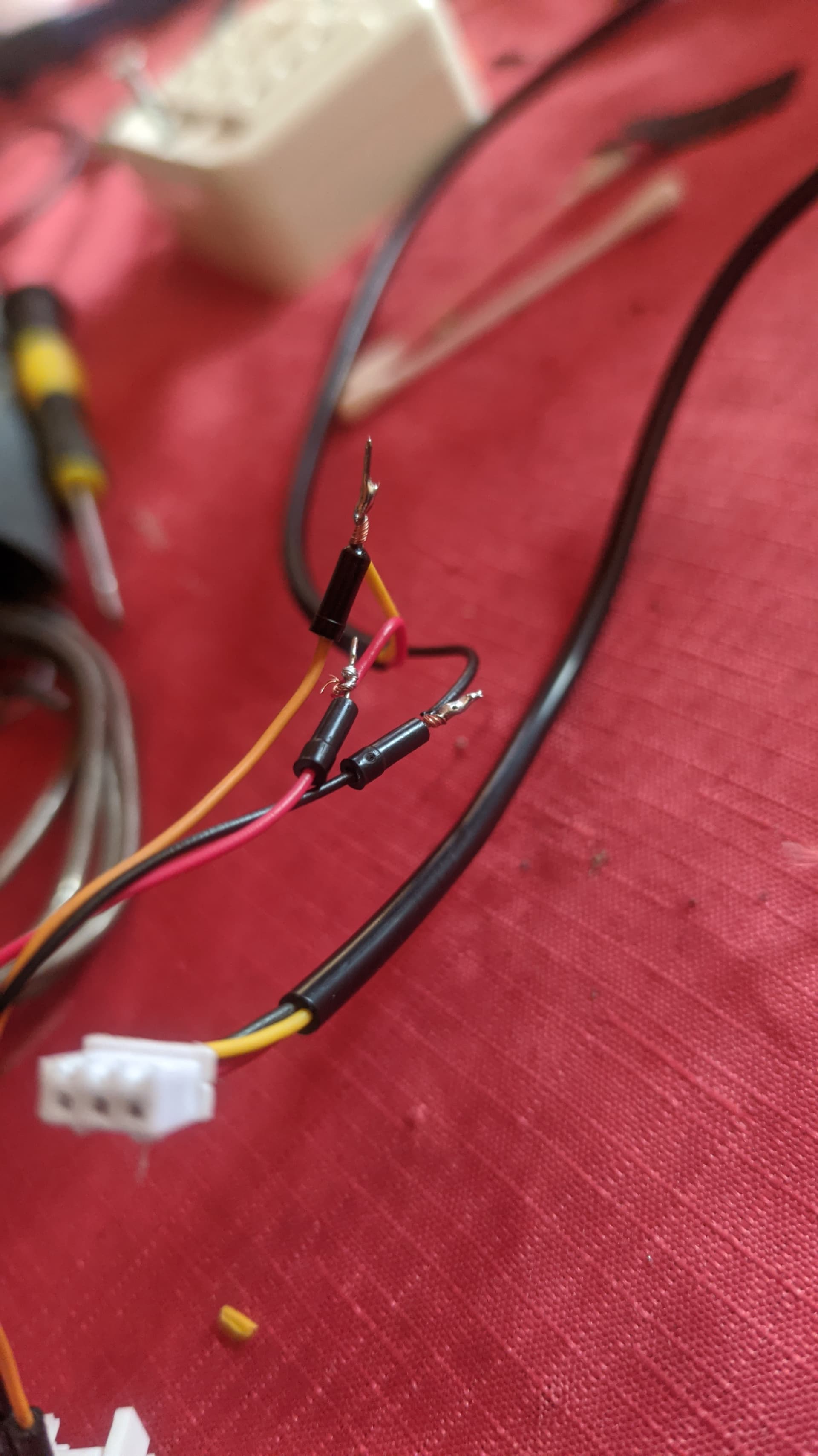

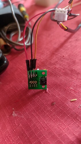

I found this page, where they disconnect the laser connection and only leave the connection at the end of the cart, I will try to do this later.
Ortur
Another day of testing, a direct connection is made from the board where the limit switch is, I have connected 3 cables 12V+(red) GND(Black) and PWM(Yellow).
Unfortunately, this operation has damaged my limit switch on the x axis.
With the help of a digital multimeter I have checked the 12v power between the red and black cables and after activating the laser at 100% I have measured around 2.3X V.
I have done the test in these 3 lasers
The first one turns on the fan and at 100% it gives a very weak light.
The second turns on a light on the board that gives power but does not turn on laser light.
The third one, this one came with my CNC3018, it turns on with a lot of power.
I can conclude that when the laser connection plate and the limit switch are damaged, the 2 lasers are damaged.
I’ll have to put a new limit switch on the X axis and make a separate connection for a laser.
Unfortunately, the CNC3018 laser is not suitable for the project I need, since I want to engrave on glass, but this laser has an output of 2.5w.
