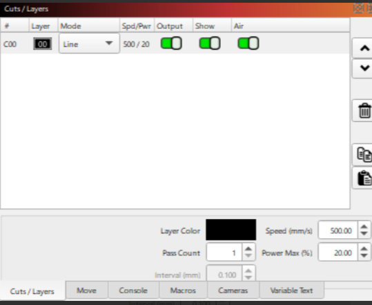

Completed the new update recently and my Ortur Lasermaster 2 Pro is not adjusting the speed. Ran through everything I can think of. Even made sure my computer had the latest updates. Removed the laser and added it back. Does not seem to be adjusting the power either. I can set the speed at 100 mm/sec and it looks like its running close to 4-5k mm/sec. Also, the screen has gotten so small I can’t hardly read it. Like it’s zoomed way out but all other programs and such are fine.
2

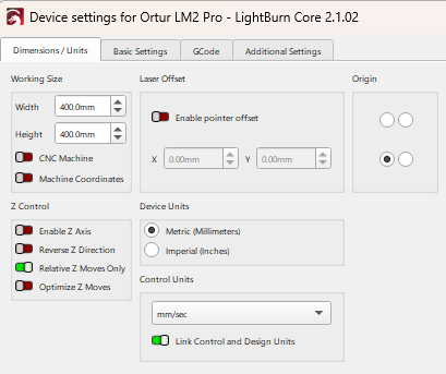

The speed is mm/sec, usually for a diode is mm/m.
You set a speed of 500mm/s = 30000mm/m it´s too fast for a diode laser.
Also read the docs to verify your Unit Settings with the update:
That was it! Thank you so much!
