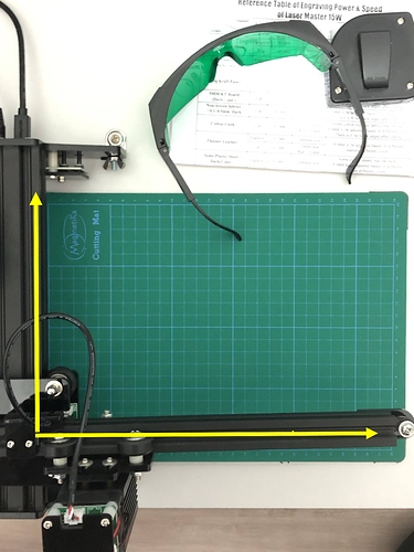

Hello
My Ortur came with an oblique (X?) axis… what is the best way to straighten / correct it?
Bad quality?
Thanks
If the Z axis is on the left, the focus changes as it travels. If the Y axis is on the left, the output will be skewed.
You may be able to loosen the fasteners that secure the carriage assembly and re-square, but your conjecture appears to be correct.
Poor quality control, poor assembly or poor design and manufacture or any combination of the above.
