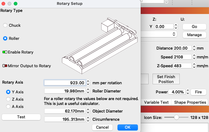

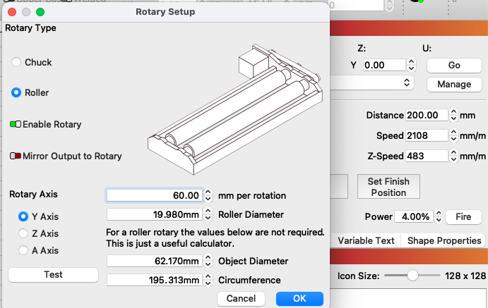

I got the rotary to move in the right direction, but I can’t get the setup correct in LightBurn. I measured the diameter of my rollers and entered that (19.98mm). Then I put in 60 mm per rotation as a starting point. I sent a command to move the jar on the Y axis 200mm. I measured the actual movement and it was 13mm.
The motor has a 16T gear and the rollers have 25T gears
25/16 = 1.5625 gear reduction
In the Lightburn forum I found this:
New value = Old value x Requested size / Actual result size
60 x 200 / 13 = 923
I entered 923 in the mm per rotation and moved the jar on the Y axis 200mm. It still only moved 13mm. I am stumped!
