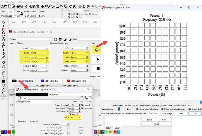

Have you tried going much slower like 12mm/s with 50%min and 60% max power?

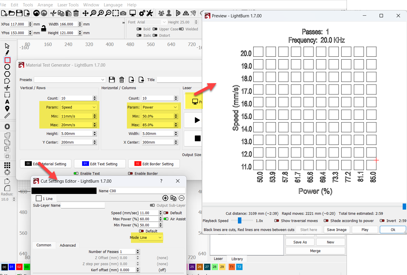

Have you tried a wider range of speeds and powers using the material test?
For example:

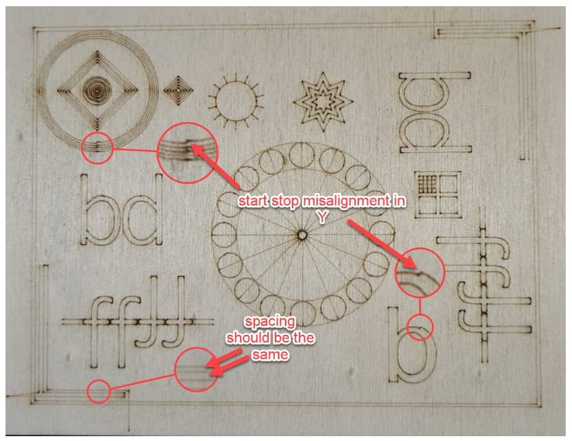

Regarding backlash, the test file attached here is good at showing backlash issues and which axis are involved (please disable ‘Optimise Cut Path’ for this test):
Test.lbrn2 (73.5 KB)
The pic below is an example of what the test result looks like, in this case from a machine which exhibited some noticeable backlash in the Y-axis;
