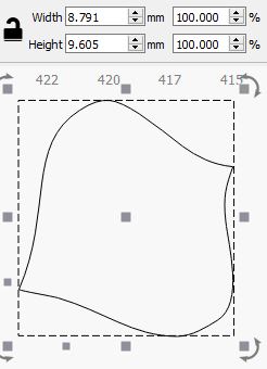

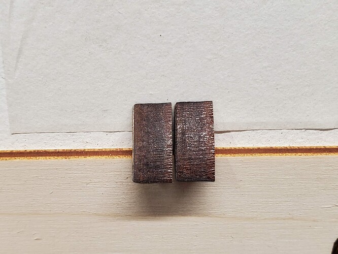

Oval Circles (kinda) when engraving. Why?

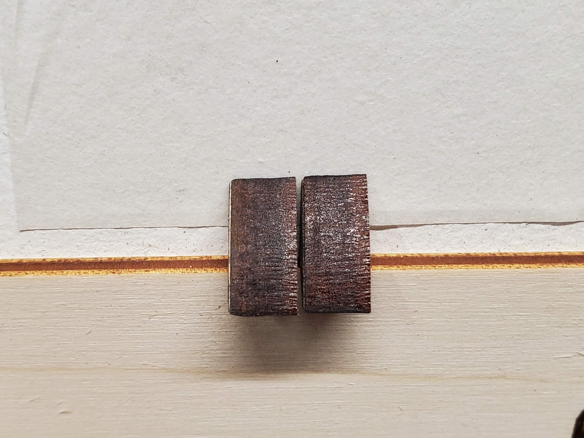

Here is the image of my kerf test. Based on the numbers it looks like I am at about 0.125mm. Am I looking at this correctly?
Hi.
Wow, the marvels of modern photography :grinning: .
I for one assumed at least twice that.
That IMO explains the surface roughness of the cut, but not all of the jagged edges.

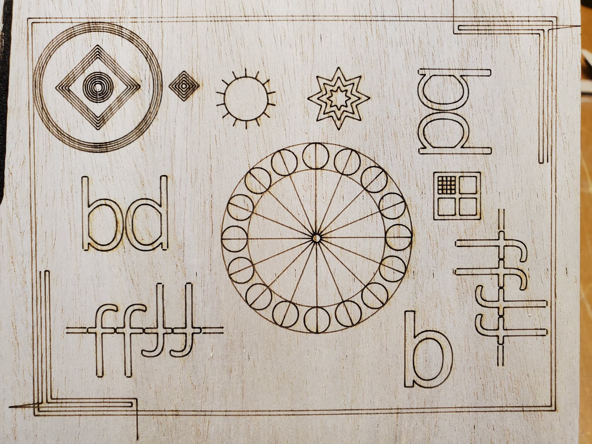

Regarding backlash, the test file attached here is good at showing backlash issues and which axis are involved (please disable ‘Optimise Cut Path’ for this test):
Test.lbrn2 (73.5 KB)
The pic below is an example of what the test result looks like, in this case from a machine which exhibited some noticeable backlash in the Y-axis;

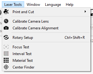

Would be nice if Lightburn were to put a troubleshooting tab with some tests to identify different common problems such as backlash and limit switch triggering.
Although they do not have those specific tests available, they do have some helpful ones already. Maybe they can add those.
Adding some tests to identify common problems would I think speed up being able to help people when having problems and posting on the forum.

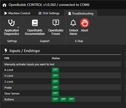

Openbuilds has a nice troubleshooter for open/closed switches.
I agree completely.

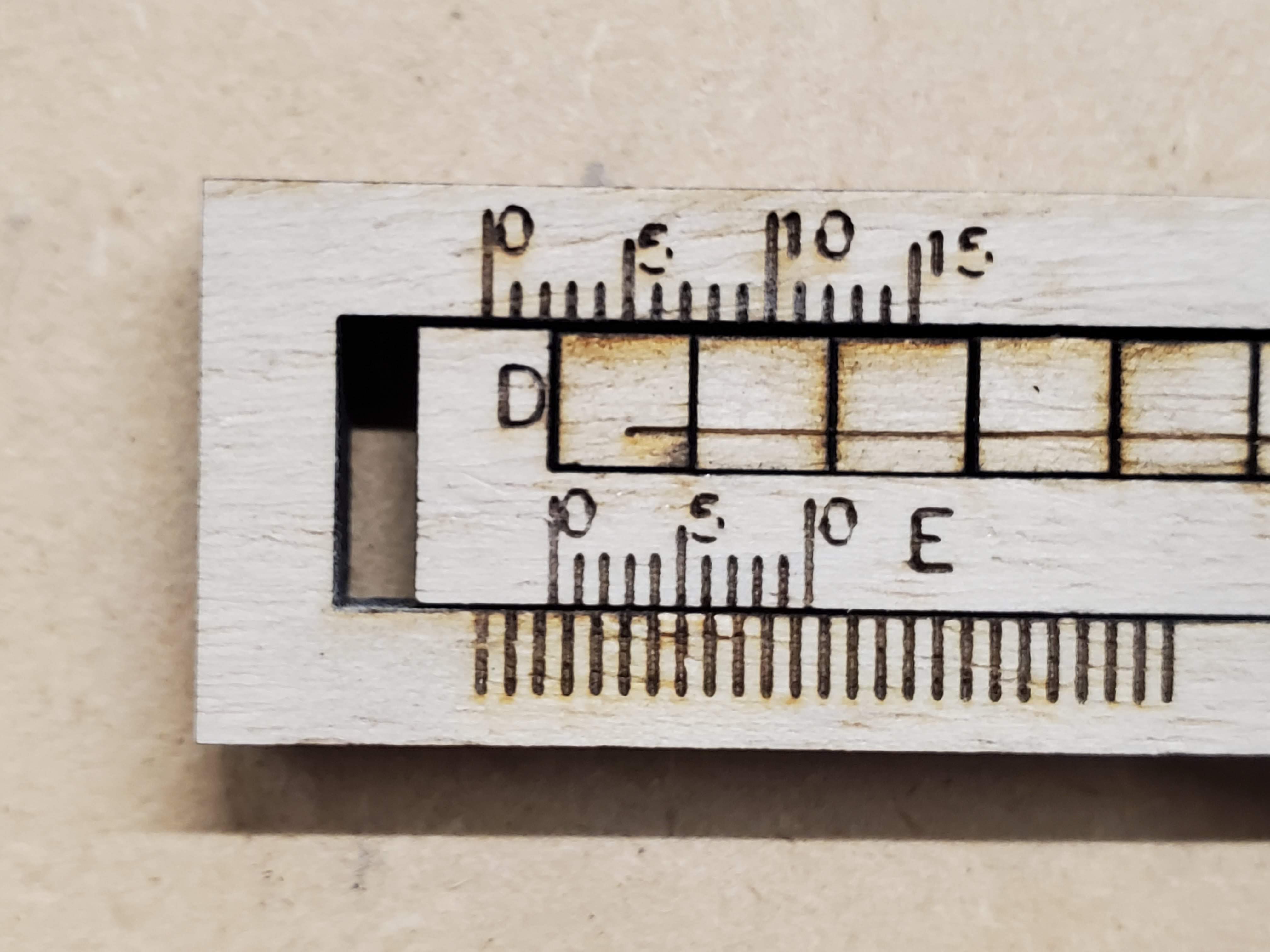

Here is my test. I am not sure exactly all that I should be looking for on this other than what is pointed out in your image. It looks better than I expected. How does it look to you guys?
Although I am a little perplexed on why the bottoms of some of the letters are missing their corners but not other parts that have similar corners?

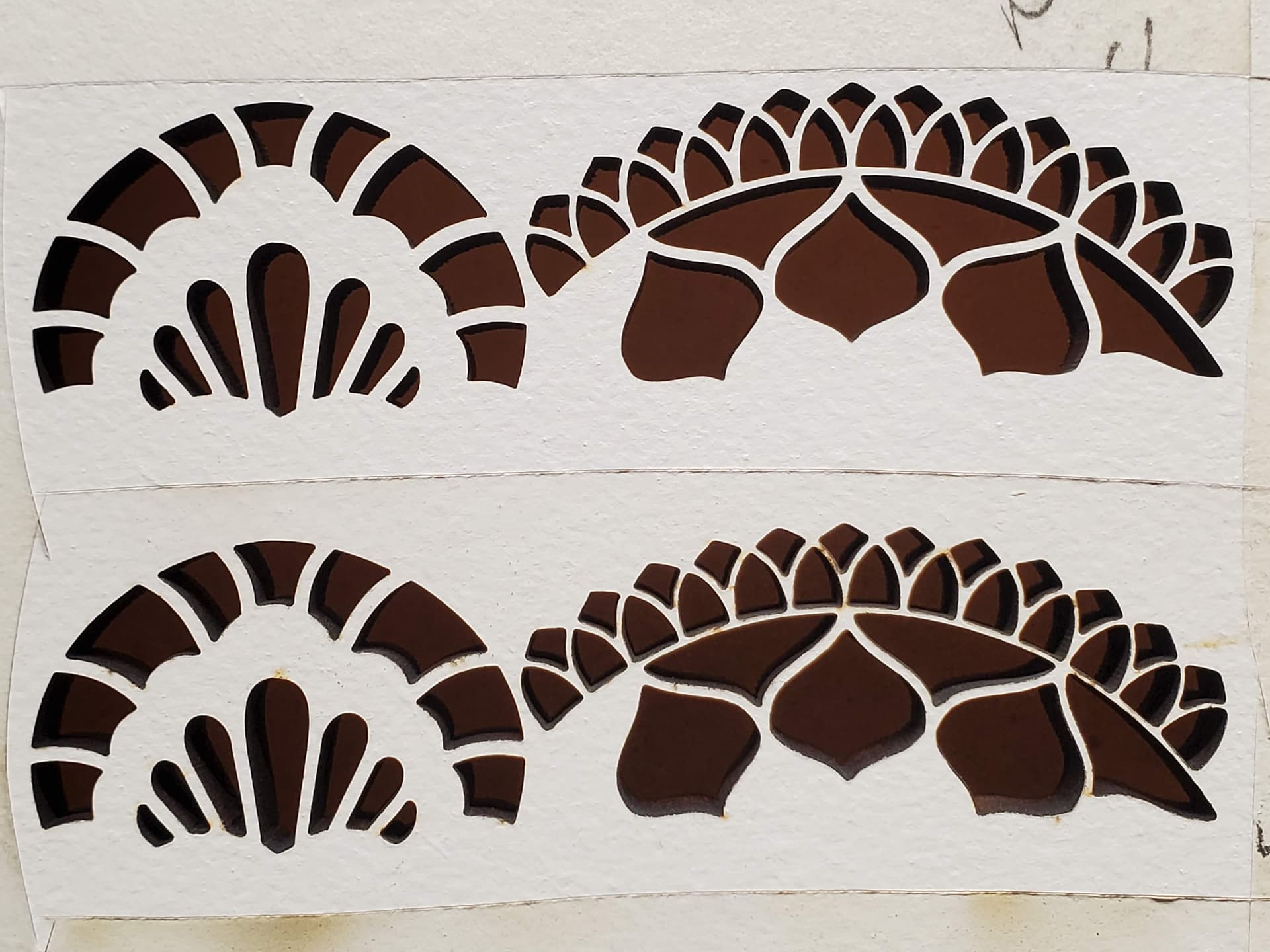

Here is a comparison of the difference between using the external flexible air hose and running the compressed air through the air assist nozzle.
The rest of the settings are the same:
  • Laser is focused at surface
  • Speed/Power is 14/60/45

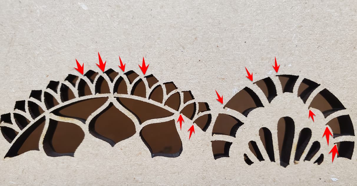

Notice the lines between the small holes. Quite a difference. These lines are roughly .75mm wide so it doesn’t take much to burn through them.
This is the back side of the last cut I did where the top edges were beautiful.
This is not a pretty cut. I would have to spend a ton of time trying to clean this up because it would be noticeable. I will do more testing with my power/speed/air to see if I can find a way to get this cleaned up.

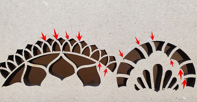

Also for some reason I am seeing a bunch of corners where the line seems to go beyond the corner (red arrows). Not sure what changes I made that would cause this other than more air assist pressure.
UPDATE: I realized that these corner issues were also happening on all other previous tests as well but maybe a little more noticeable after these recent changes. So it was not from what I did here. Not exactly sure what is causing it though.
The second thing I noticed after added more air assist pressure is the cuts do look way better. In fact I notice that the more pressure I apply the less shiny the cut edges are. I assume this is resin build up from the heat? And by applying the added air it cools the edges down much quicker causing less resin? This is nice because I do notice that the pieces will not drop out because of the resin build up at times. I think this was set at 25psi. Once I got to 35psi almost all the shine was gone. Unfortunately I had tossed these two pieces before the 35psi test :confused:
Anyway, it has been a good day so far of testing. I feel like I might be making some progress on dialing some things in. I just NEED to try and figure out the jagged edges on the bottom side so I can start making my pieces. :face_with_symbols_over_mouth:

One of the most important factors when a smooth operation is required is parallelism, 3.3.1.1 onwards on:
In systems with two parallel rails that has no tool loads (for example laser-, etc. cutting, printing, painting, etc.), one rail may be the dominant fixed rail, and the other end may have some mechanism that allow play if the parallelism doesn’t for some reason stay constant.
In any case, I for one don’t think that the issues You’re having are the result of play in the linear rails.
If the parallellism requirements are not met, there may be some binding happening, but without very precise measurements and measuring the friction of the rails over their whole travel, that’s impossible to tell.
Judging by this:
I for one don’t think You have backlash, binding, or play issues.
The missing corners You mentioned are indeed strange, but I don’t know enough about CO2 lasers or LB for that matter to even guess what’s the reason behind those.

Yeah it is strange. In fact if you look at the 0’s and 5’s in my image of the other backlash test I did you will see some odd things as well. Notice all the 0’s have the same odd shape and all the 5’s are missing the same parts. Obviously my machine has an issue with text. Just what I need, another issue to figure out :face_with_spiral_eyes:

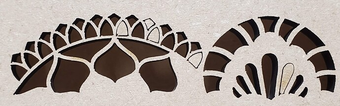

After further testing I FINALLY feel like I am getting somewhere :partying_face:.
I did more testing with different speeds/power/air and finally found a happy medium. It is not perfect on the bottom side but it is acceptable . Unfortunately I settled on a speed of 13 which is quite slow. This means that for this particular project I will have about 75 minutes of run time which is quite a bit more than previously. But I am saving time in other areas. And I went from 85 power to 65, so I am not taxing the tube as much.
I also tested air pressure up to 60psi. I found that 55-60 psi works best for 1/4" MDF on my machine. Maybe I should test even higher? :thinking: I just don’t know how much pressure my air lines/connections can take. I would hate for something to give while running a job.
Here is the bottom side using 13/65/55 settings. Most of the pieces fall out from the air assist pressure.
Although the edges on the bottom side are not crisp or straight or that clean, they are quite a bit better than before. Of all the testing and things I have tried I noticed the majority, if not all, of the improvement came from adding high air pressure to the air assist nozzle.
After reaching this point, I ran one of my large intricate jobs and it came out absolutely perfect :metal:.

These are once again one of those many things I don’t know nearly enough to offer any advice.
If I had to guess, on the 0’s there’s some kind of pulsing going on for some reason, acceleration/deceleration power compensation for example.
One dot and uniform width burn would make sense, two dots with reducing power burns make no sense to me.
The 5’s make even less sense, the curve is roughly the same as in the 0’s, but the result is completely different.
