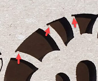

I suspect that you could get an even better result if you slow the speed even further, it will help get rid of these little cling ons:
For example, try slowing the speed @ power a lot more from 13/65/55 to 7/35/35 just to see what happens - slowing the speed should produce better quality cuts, which may save you time if you are cleaning up cuts later. Increase the speed (and power as needed to just cut through) until you notice the quality starts to become unacceptable.

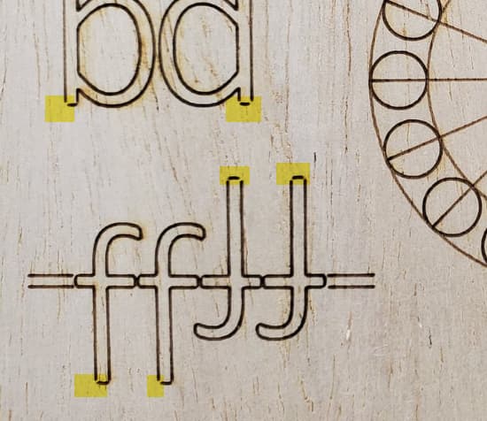

Your backlash test result was a pass with flying colours, but the other issue it raised (and the numbers in the kerf test) was that a number of the small radiused corners were not burnt. I’m not quite sure why…will be thinking about it.:face_with_monocle:
I may have to start a different thread on that if I cannot figure it out.

When You said radiused , that got me thinking.
Could it be that the radius is so small, and the path is so short, that the controller for some reason (perhaps lead-in/lead out power compensations overlap?) pauses the beam from firing.
But it doesn’t seem to affect all the more or less similarily radiused corners ??

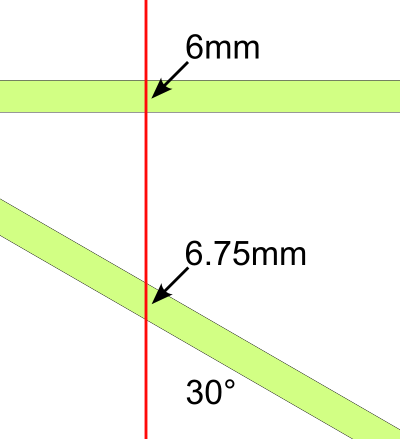

Yes I totally get the DOF. I am just trying to understand what doing a ramp test at cutting speed/power with the scale being at a decent incline will tell me exactly? And how do I interpret the results? Will I be looking at the back or the front or ?? What is confusing me is the laser will cut through at an angle. And that angled cut will be thicker than the actual thickness of the material I will be cutting.
I just went with 30° as a quick example. Not sure exactly how steep my ramp is.

That is an interesting thought. It clearly is a setting or something since I have the same controller as so many others and not all seem to have this issue. Maybe others that are more knowledgeable can jump in?

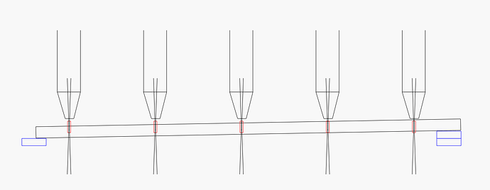

The vertical distance difference will be on the order of 10 mm, maximum, and the length could be 300 mm if that’s the piece of plywood / MDF you have on hand. The angle will be 2° = atan(10/300) and the thickness will be 1/cos(2°) = 1.0006 times the original material thickness = not a problem.
But, as @jkwilborn points out, you don’t want a cut, you want a line on the surface so you can examine the width scorched on the material to find the narrowest section. Paper will work when you throttle the laser down enough to just mark it, although you should tape it down to keep it flat.

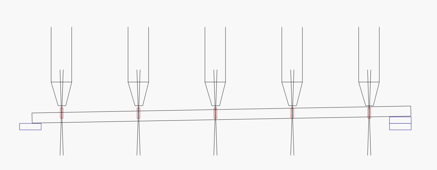

The ramp test I was proposing was to observe the characteristics of the cut (top, bottom, and middle) as the depth of focus (in red) slowly moves down through the material.
The jagged lines at the bottom of the cut are the result of the focus slightly flaring at the bottom (due to both the lens and deflections in the material), and so should improve as the depth of focus moves to include that area, but at the cost of losing quality at the top.
The ramp angle is very slight (1-2degs), the blue rectangles in this pic represent the rough height of a focus spacer you would normally use between nozzle and material surface, the ramp length roughly 300-350mm long. The ramp is lifted at one end by 1x focus spacer (just to avoid flashback) and at the other end by 2x focus spacers:
The reason for this test is to determine (by observation) the best overall focus height for cutting your job given your requirements and all the unique factors of your setup … your air, your MDF, your focus lens, etc.
As usual, make sure your optics are nice and clean before running the test and that your focussing lens is also correctly oriented (curved side facing upwards).
Another test I would recommend is to pulse a pinhole spot on a piece of scrap at focus height, then lower the z-table about an inch or so then pulse again, and check if the pinhole and the larger pulse spot are concentric. This is a quick test to see if the beam is perpendicular to your work (if not perpendicular - that might help explain (along with general flaring) those cling on artifacts on the underside at the very end of the cut).
