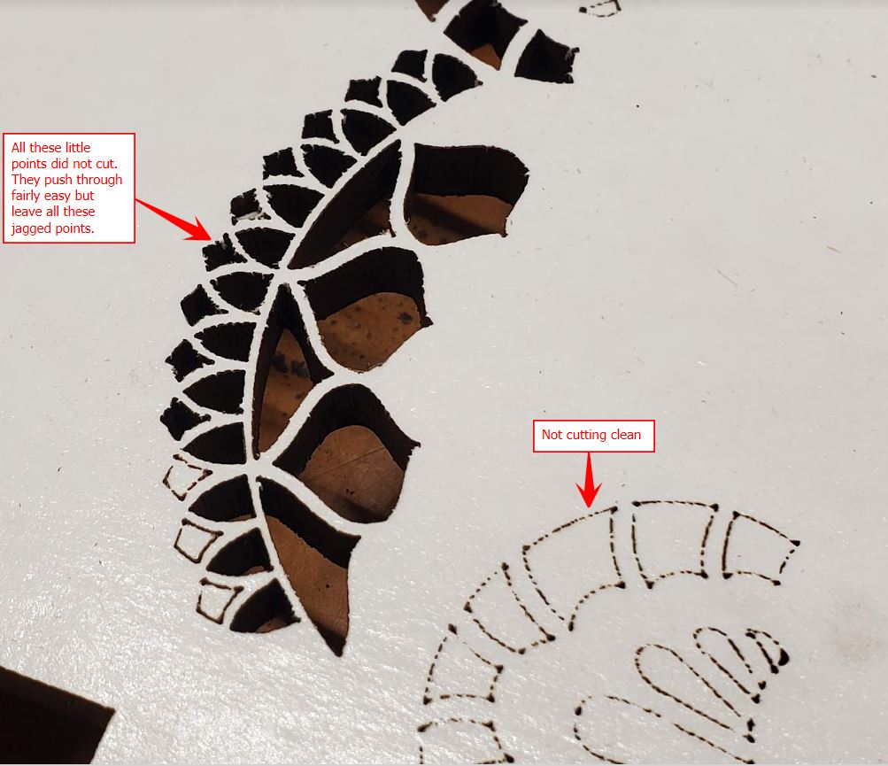

Well as some of you may have seen in another one of my posts, I am still having issues with the serrated/jagged edges that we thought was due to the kerf setting in LB.

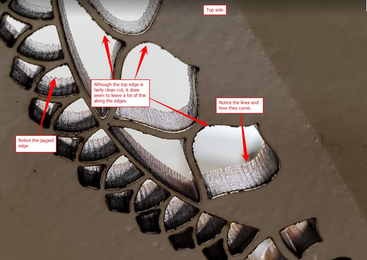

Here are some pics of my most recent cuts.
This is the bottom side of the cut. It has super thin double sided tape on it.
This is from the top side which had transfer tape on it when it was cut. I am thinking that the fuzzy top edges that I pointed out are because of the transfer tape. I just have not tested with out it yet to be sure.
Can someone tell me if those lines are normal? Should there be a jagged edge like that on the bottom side? This was set to constant power but it looks like it is pulsing, hence the dotted lines in the above pic.
Something just doesn’t seem quite right. But I am not well versed yet on lasers. I am hoping someone can help figure this out?
Any assistance is appreciated.

The jagged edge and the curving lines in the pic above look a lot like vibration patterns and those two examples have the same exact intervals.
If the behaviour is caused by backlash, the interval should change when the speed changes.
Obviously, if the dimensions of the shapes is really small, that may be just the normal cutting surface roughness that can be expected with laser cutting.

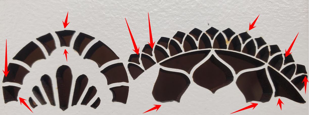

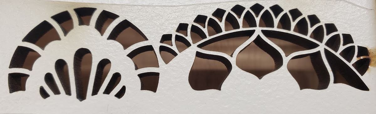

Here is an example of no backlash adjustment
Here is when I adjusted for backlash. Notice that pretty much every line is messed up. I pointed out many of the obvious ones.
What I find odd is I also tested this pattern using an external air supply blowing the surface of the material while cutting to try and minimize the residue buildup on the top side. In my testing I noticed that it too caused the lines to be wobbly. I had one test with low air flow and it was not wobbly but there seems to be a point where too much air caused it to wobble. Not sure I understand why or what is causing this. The air line was right near the laser nozzle pointing directly at the cutting point. Maybe I need to play with the distance, angle, and intensity some.

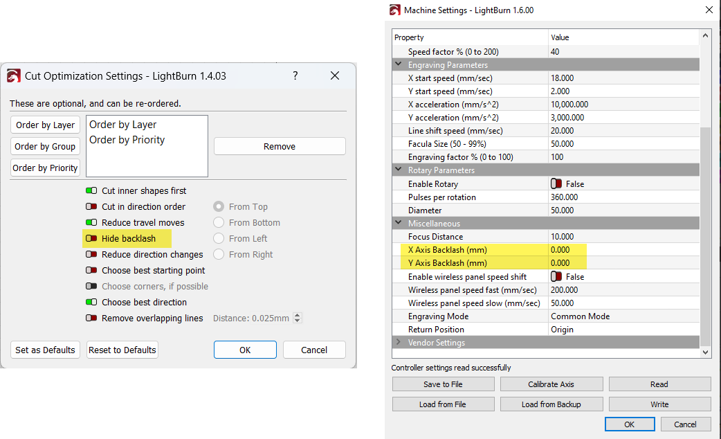

See pic below…what settings did you change for the backlash? There is a ‘Hide Backlash’ optimisation setting in LightBurn’s Optimzation Settings, but the Ruida controller has it’s own backlash setting which is accessible from LB machine settings but is not an LB setting per se, and I would not recommend it for addressing backlash (at least not without more testing, since the last time I tried using it I was not convinced it was helpful);

I use the Hide Backlash setting in LB always. Mainly to eliminate the very slight step in arced shapes where the laser begins and ends. In my work these steps are noticeable so I need to be sure they are not there. This works pretty good at that.
The Ruida settings are what I tried for this test. Now that I think about it, maybe I should have tested the Ruida backlash settings with the Hide Backlash turned off. :thinking: Anyway, the Ruida settings did not help.

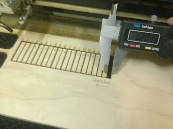

Is this an RF machines kerf measurement? .004" is 0.102mm. I looked at one of my 5mm sub flooring cut with 2" and my kerf appears to be ~0.250mm - almost 2 and a half times larger than yours? Mine is set for ~0.125 for each side.
A normal 2" lens produces a spot of ~0.205mm, so a kerf size of anything < 0.205mm, in this case, is rather unrealistic.
I tested it the rudimentary way like this.
Thinking I should run it again. Maybe I misread my calipers. I do know that when I set my kerf to .0025 in LB my pieces/holes were fairly accurate.
Is there a better/easier/more accurate way of figuring out kerf size?
That looks like it reads 0.204 but I can’t tell the units…
There is a nicer tool that @BillieRuben built … it has a vernier caliper built in… You should get the same results either way.
Sorry. That image was from a site that explained how to perform the test. It is not a picture of my test. :smile:
