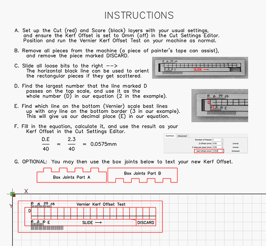

There has been a bit of a flurry of marquetry lately on the forum, and it prompted me to make a tool to help calculate kerf offset accurately and easily, while using minimal material:
I was inspired by @jkwilborn’s tool, but I added a vernier scale to make it easier to measure, without needing calipers! Just cut it, slide it, and calculate your kerf.
EDIT: You can download the new & improved version (following feedback below) here:
Kerf Test with Vernier Scale.lbrn2 (2.6 MB)
I recommend saving it to your Art Library.
I’d love any feedback you may have! :blush:

I struggled with the instructions. As a tool layer the lines were dotted, and thus hard to read plus I couldn’t put images on a tool layer. And as normal layers I was worried people would cut them if I didn’t have them set to not output, plus it was hard to see the annotations on the images. I could have used the notes function, but the instructions are rather long and I was worried folk wouldn’t remember it all/wouldn’t know how to reopen them, and the pictures compliment the instructions which I can’t add to the notes.

With my usual set of cut optimizations, the planner finished the vernier scales, cut the outline to drop the whole thing into the chip tray, then blithely (tried to) cut the squares.
So I twiddled the cut priorities to do the squares first, balanced some chipboard over a smaller tray, then Released The Laser:
The toast marks on the far right shows the beam is still too tight at the bottom of the smaller tray, but no matter.
The teeny squares tend to buckle upward when pushed together, so I held them down with a craft stick while lining things up.
The result agrees with my usual 0.2 mm kerf, so it’s all good!

Thanks for the file, my experience is the same as earlier posters. The first time I ran it (on 3mm birch ply) all the squares fell into the honeycomb, so I repeated with the 3mm ply on a sacrificial 6mm piece…the tiny pieces still managed to fall out as I moved it. Is there any reason they are soooo small? If it could be enlarged so that each piece is big enough to handle easily that would help (I’m guessing that a small increase in the block size may have a bigger impact on the size of the tool?)

Just wanted to check, were you picking it up with the painters tape?
Yeah, that was my thinking. I could maybe make them longer in the vertical direction. Or make the tool less accurate and have just 10 pieces. Maybe I could offer a few versions?

I made one with 6mm birch plywood. The vertical height was increased so the pieces don’t fall thru the grid. Was also wondering if different materials gave different results…
…so I used some 3 mm melamine hardboard to try another one, plus added a couple of slots to make the pieces easier to slide.
The one on the bottom covered with tape didn’t turn out so good, it wasn’t cut all the way through in places, so I burned another one.
It cleans up real nice with alcohol after laser cutting. I used painters tape to hold it together while removing from the laser and mounted it on a piece of poster board.
On both tools, the Vernier result was in agreement with caliper measurement but did show a difference between the materials which I didn’t expect.
One question though: this calculation determines the width of the laser kerf, so wouldn’t the offset to enter into Lightburn be 1/2 that amount?

Thank you so much for your comprehensive review! I like the idea of taller pieces a lot, and the trick about picking it up with tape! Glad to hear you’re finding it as accurate as your digital calipers too!
Regarding halving the result, I think you’re right! Yes! Thank you! If I found my kerf was 1mm, I would need the shape to be offset outwards by 0.5mm in order for the edge of the kerf to ride the edge of my shape.

A thought I had would be to cut the tool as is to determine the kerf, then cut a kerf adjusted version (two less cuts so the spacing would change). Then for future materials and thicknesses you just cut the square pieces, and insert them into the slider and measure the kerf of the new material.
I have not delved into the world of dialing in my kerf settings yet, but it’s my understanding (at least with diodes) that the x and y kerfs could be different. If this is true, then after cutting the kerf adjusted slider, you could just rotate the squares to measure the y kerf.
In my understanding, X and Y only have different kerfs when the laser beam is rectangular or there are mechanical gaps.
In any case, the only way I remember to be able to configure the kerf for different axes would be to separate all the horizontal lines from the vertical ones, group them separately and give a certain kerf to each of the groups/layers. And this would only work well on straight lines because on curves the kerf would never work correctly. :thinking:
