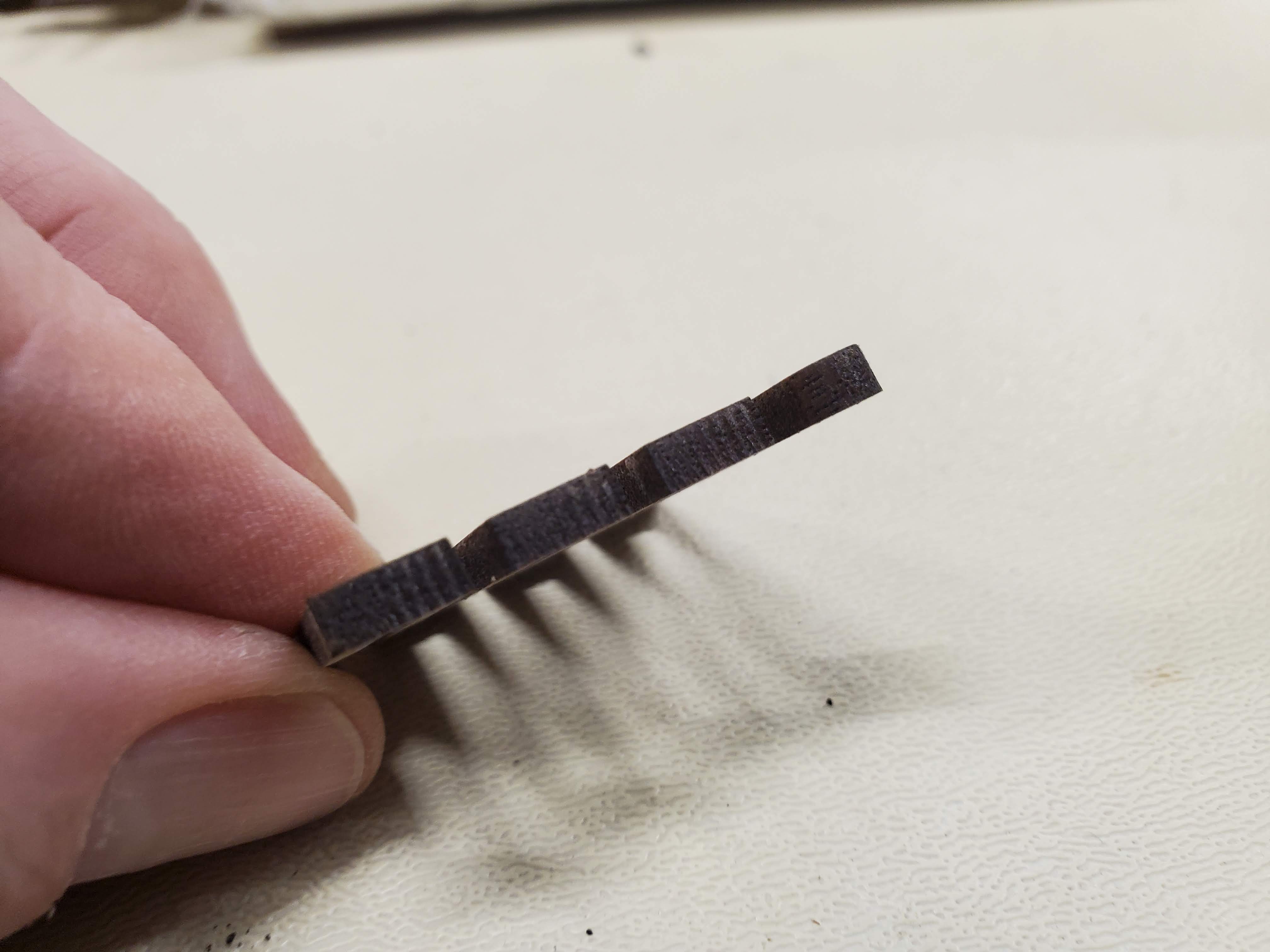

I wanted to jump back in this post because I have been noticing something strange. On some of my pieces that I am cutting I have noticed that the edges are quite jagged at times and sometimes they look stepped like the edge of a quarter. I will also add that I am seeing a step again where the cut starts and ends. This does not happen all the time but I do see it on all shapes, not just circles.
I tensioned my belts back when I started this post and it seemed to eliminate the steps where the laser ends the cut as well as the oval circles. Not sure what to look at now. The belts still feel OK, but I am not real sure how tight they need to be. To me they don’t feel overly tight but they are NOT loose. The two Y axis belts feel about the same but the X axis belt does not feel as tight because it is a longer span. Not sure if that makes a difference.
I will also say that if I try to move the axes by hand when the machine is powered off, there is quite a bit if resistance and tension. Not sure if that is normal or what.
Anyway, here is a pic of a test piece I cut out and you can see the stepped edge.
I would appreciate any guidance.

A couple of suggestions:
  1. Test this with another material to make sure it’s not related to the material itself
  2. Hold the material up to the toothed side of the belt. Does the pitch of the belt match the spacing of the ruffled edge?
The pattern reminds me of endgrain. The growth rings burn at different rates as density changes. Is this solid wood or ply? If solid, do those ridges line up with the face grain lines?

Lots of carbon there. Suggests you need to move faster and/or increase assist air.

OK so the stepped edges do not match up with the belt spacing at all. Not even close.
I have ran all kinds of materials from MDF to ply to acrylic to leather and now solid hardwood (Cherry and Walnut). The ONLY wood I have this problem on is the two types of solid hardwood.
[quote=“cggorman, post:44, topic:118804”]
The pattern reminds me of endgrain.[/quote]
I think this is part of the problem. But it only seems to happen when being cut on an arc or an angle. If I cut a square out of either the Cherry or the Walnut where the endgrain is cut perpendicular then it cuts perfect and beautiful (to the naked eye). It seems to have something to do with both x and y axes working together. Also it seems that it may be worse on some sides more than others :thinking:
Could this be a belt tension issue? Maybe one axis is too tight and struggles to keep its speed while the other axis is moving smoothly? When I move the axes by hand with the machine is off, it is stiff and I can feel every little step. But then again, I have not seen this issue on any other material. DOH!!!

After a bunch of calibrating, squaring, mirror aligning, bed leveling, belt tensioning, and testing power and speeds I thinking I am finally able to cut the hardwoods much better. After testing on some Walnut, which was the worst before, I think that the stepped edges do have to do with grain. I noticed that the Walnut has a bunch of tiny holes on the endgrain that a lot of the time run in a straight line. I think that with my power and speed settings too high before, it burned through the wood much more in those areas because of all the tiny holes, causing the stepped grooves.
If you look at this pic you can see the holes and some very fine grooves that follow the lines of holes.

Well I jumped the gun. Apparently I am still having the serrated edge issue. But now I am seeing it on some Baltic Birch plywood as well.
I have ran some tests and the slower the speed the less prominent the serrated edge is. At 15mm/s the serrated edge is pretty much non-existent, even under magnification. At 20mm/s I can start to see a tiny serration under magnification. At 25-30mm/s is when it starts to be noticeable by the naked eye.
I would normally run it at about 40 mm/s so having to run at 15-20 mm/s is doubling my machine time.
I don’t think this would be a backlash issue since both axes are running in one direction, not back and forth, while cutting a straight angled line.
It may be a belt tension issue but I feel like my belts are not too tight or too loose. I guess I will do more testing with this unless someone has any other thoughts.
In this pic notice the red arrows (serrated edges) and the blue arrows (no serrated edges) that are on the same angle. These were cut side by side but the serrations are not always in the same place as the other piece.
And if you look at the yellow arrows you will see very rounded points. I will mention that this is the back side of the pieces. The serration is more prominent on the back side than the front. In some areas there is no serration visible on the front but is on the back.

I followed your advice, kinda, and cut out two of the pieces, side by side, but made all the cuts in each one go the opposite direction from the other. You can see in this pic one is CCW and the other is CW. The results seem to confirm my theory that it may be random and not repeatable.
Actually the peaks are not almost 2mm. They actually change with the speed of the cut. In this pic you can see that the 40mm/s cut is about 1.1mm peak to peak, where the 25mm/s cut is only .75mm. Yes the serrations are very regular. But nowhere near the belt pitch.
