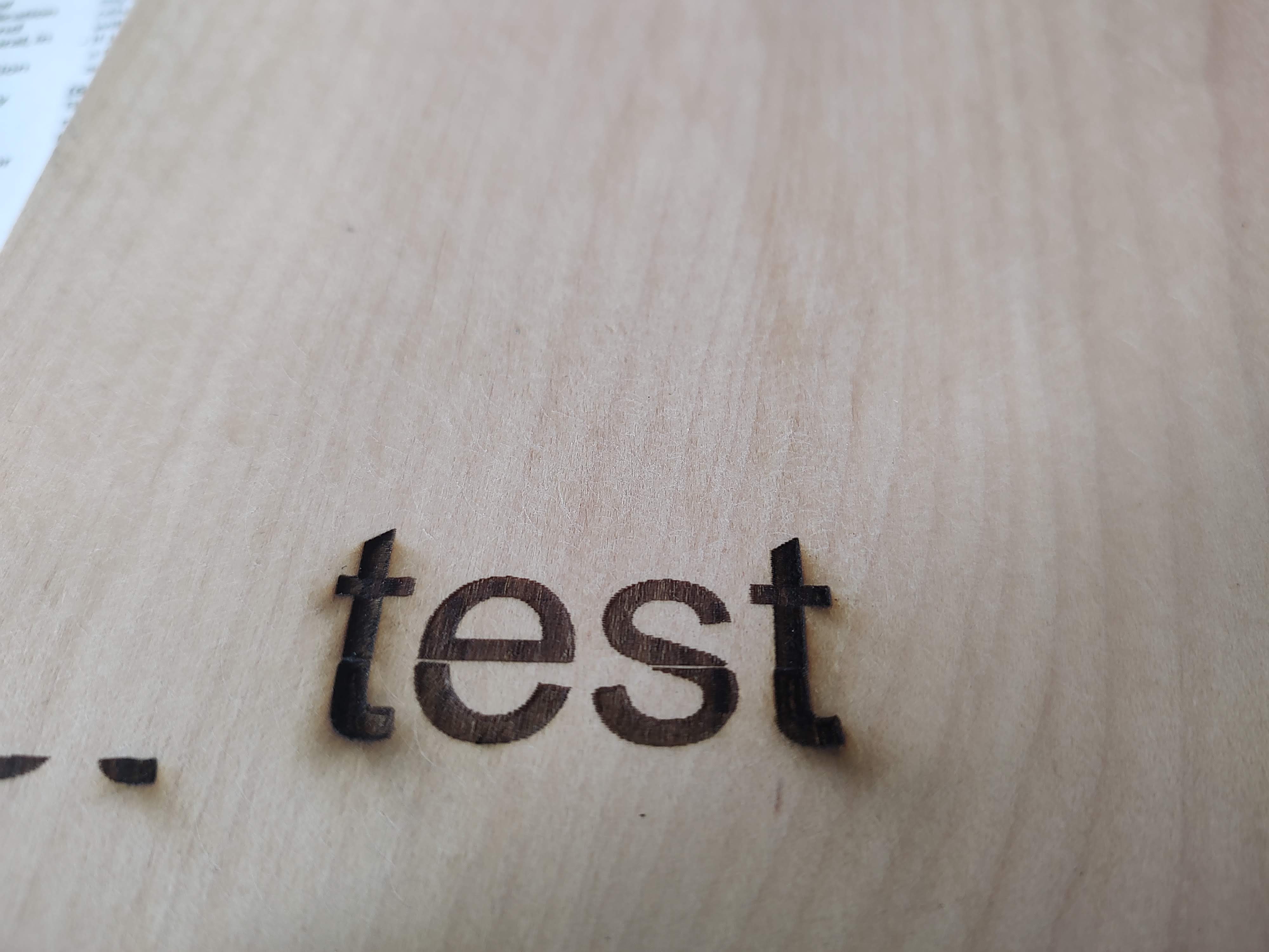

I am getting back into burning after a while. I upgraded my Ortur laser to the 10 Watt and i am seeing the edges of picture over burning. I attached a picture. I am guessing it is something simple.
  1. Disable Constant Power Mode if enabled
  2. Add Overscan option
+1 to the above… and consider Upgraded to 10w - at least double the 5w and almost 4x the 2.5 watt. Your power needs are much less with the more powerful laser.
Have your air assist turned on - that will also help with lessening the char.
Thank you, adding the overscan option worked.
