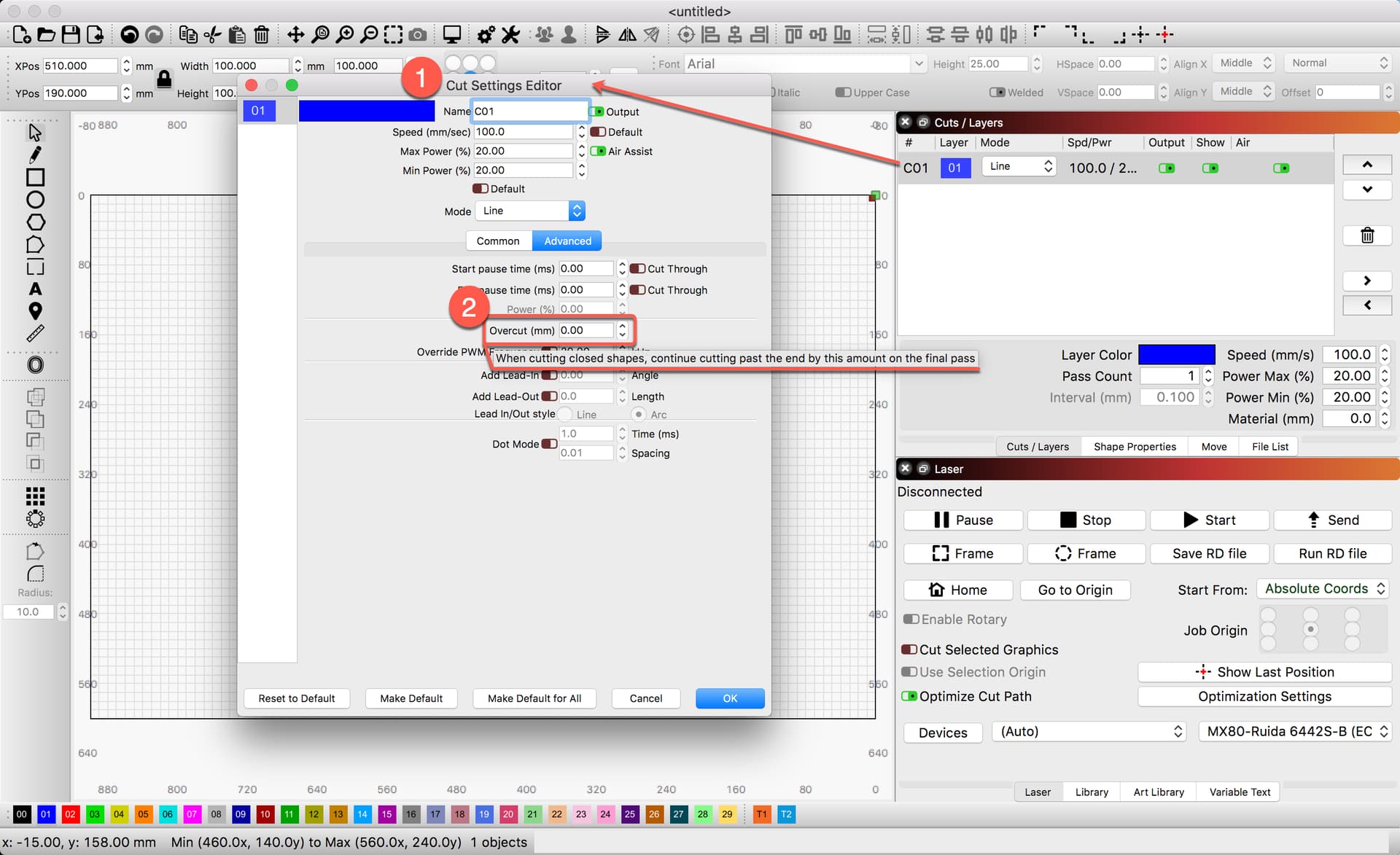

Hi all I just wanted to know if there is a tool that when you cut a circle from a start point to when it finishes is there such a thing to over cut by say 0.2mm. When I’m cutting a small circle in leather they are hanging on by a nat’s knacker and I have to poke them out.

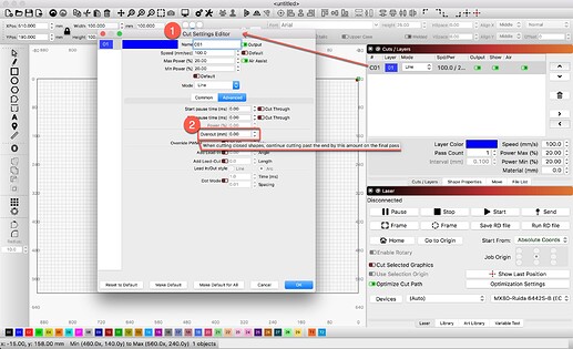

There is. Double-click the Layer to open the ‘Cut Settings Editor’, then choose the ‘Advanced’ tab and about halfway down that screen you will see ‘Overcut’. ![]()
