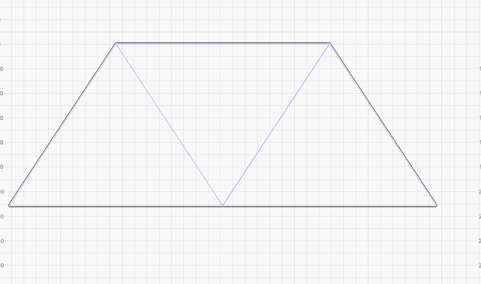

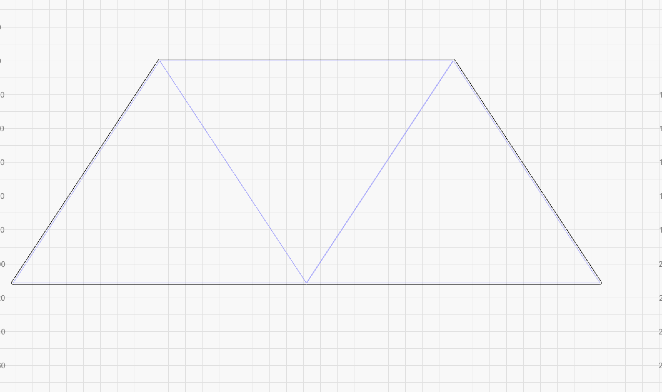

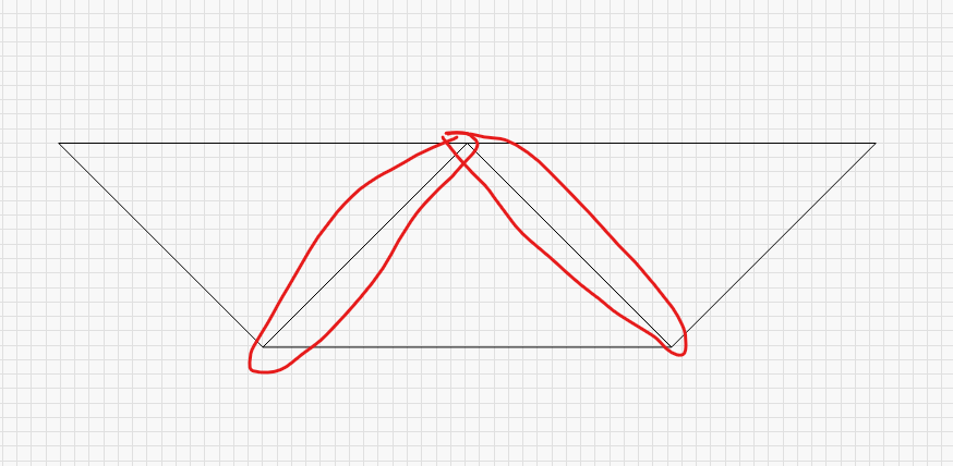

Good morning. I have literally hundreds of these to apply to an engrave design in various patterns. What is the easiest way to remove the overlapping lines where the 3 triangles touch so LB doesn’t try to engrave each line twice?

I will give the 3 shapes an offset (outer edge only) with 0.1 mm distance and then delete the 3 triangles. If necessary you can reverse offset with the distance you used in the beginning, if you can live with 0.1 larger final shape, then you are done.

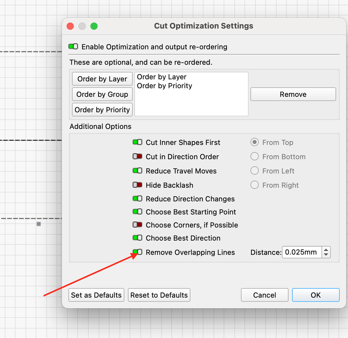

understood, however I need all the lines engraved so can’t delete the triangles, just don’t want them engraved twice.
oh dang! Never saw that, thank you!
