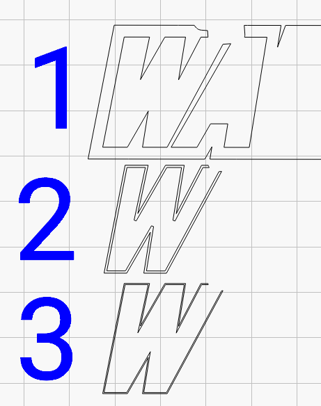

The example you have sent has approx. 130 duplicates and more open lines than I have hair on my head. I don’t know if it’s an export problem or just a bad (drawing technically) design.
But that can be done. Lightburn finds and deletes the duplicates, but all lines that need to be connected to being used as Fill layers is manual work. That should be able to do for a small hour.
Hello, to eliminate duplicates you must ungroup everything, then select everything and press ALT+D and it will eliminate all the duplicate lines and shapes. But in your file there is a design error, since there are parts that form 3 different objects, that is why they are not eliminated with ALT+D, look at the example of the letter W, you have an outer contour joined to the rectangle that contains the word complete (1) Then you have an interior contour (2) and finally you have an object that has an interior and exterior contour (3) which is the latter. And the same in the rest of your design. But it is, as they told you, a design problem.

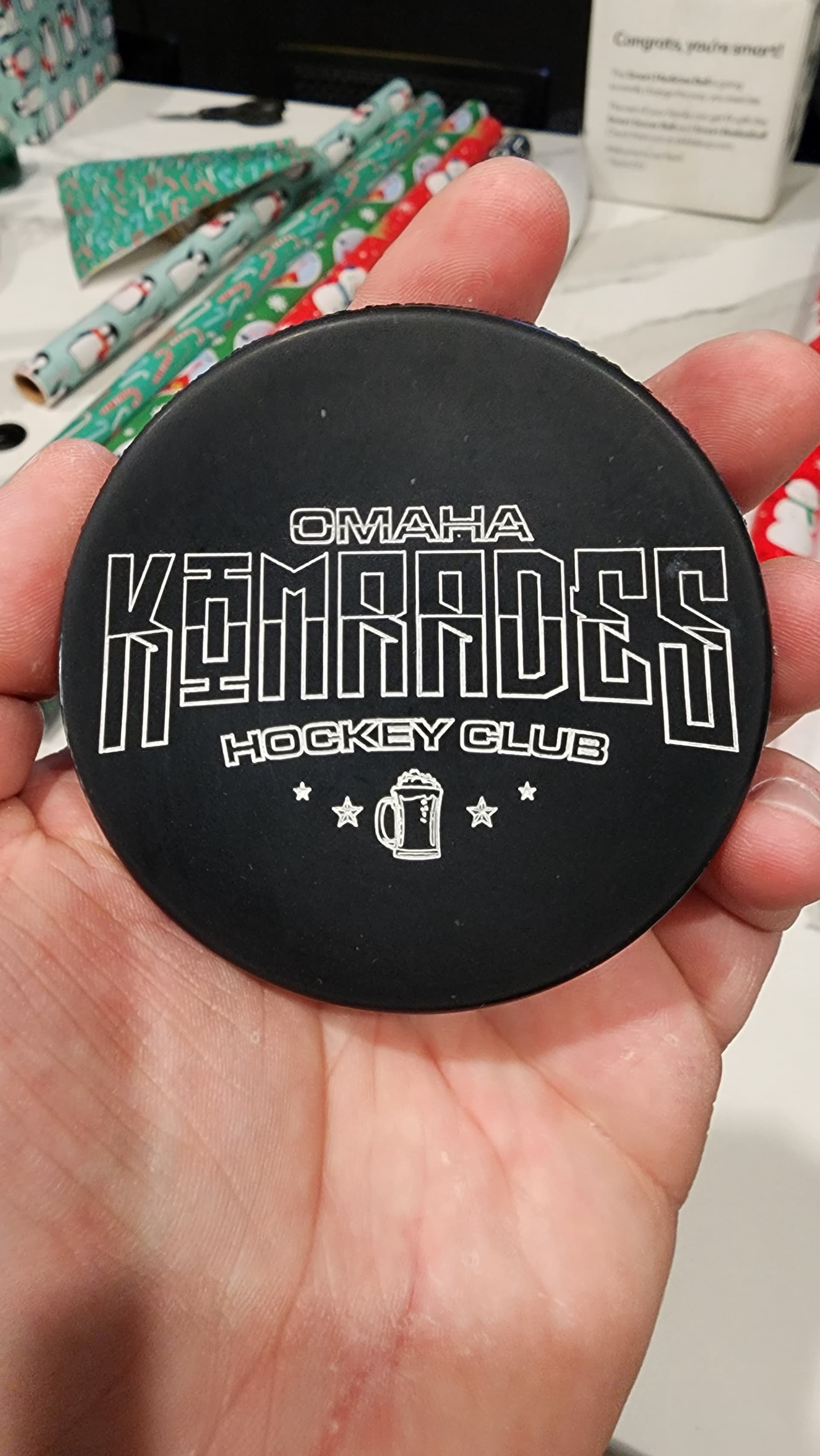

Im burning onto hockey pucks then color filling them. Heres an example.
It is a horrible drawing technically. Its my bros hockey team, they use the file for screen printing.
