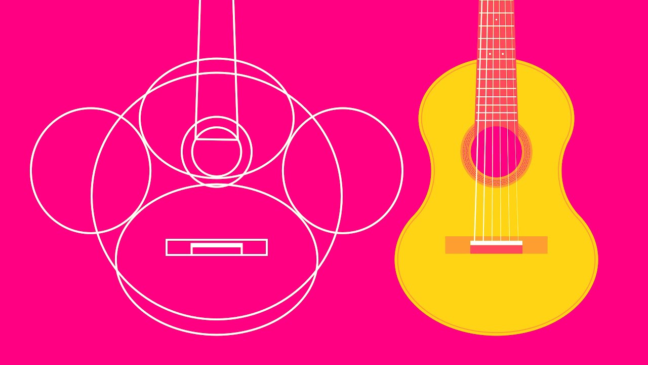

Does anyone know of a way to edit overlapping lines like this video?
I can do it by making some half circles and using the boolean tool a bunch of times, but it looks a lot quicker in the video.

Circle
Offset
Offset
Duplicate and move copy into position
Select everything and convert to path
Draw line between centres (used as an aide to trimming)
Use node editor to trim unwanted segments and break where needed. “Auto-Join” segments together then use “Close Path”
I’m sure someone else will come up with a more elegant method but that’s what I came up with.
