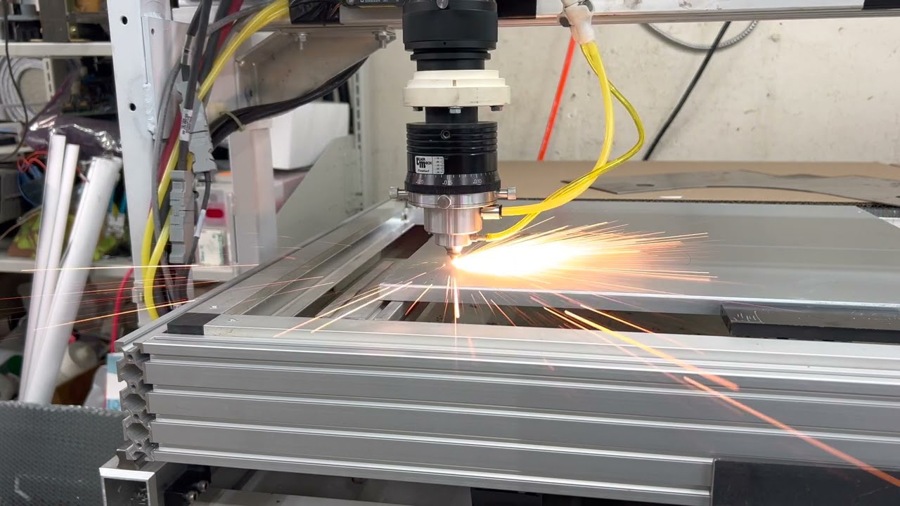

Ive started using Lightburn with the laser I built, I ended up installing a Ruida RDC6445GT to control the system. My laser (Coherent Diamond E-150) supports up to 100khz pwm freq and the controller does as well but the PWM override will only allow me to go up to 100khz, is there a possibility of getting the software updated to allow me to enter frequencies past 50khz?
It actually does matter with this laser, frequency and duty cycle on this laser have a large effect on peak power output which affects material processing quite a bit.

This isn’t a Chinese laser. It’s a good ‘ol made in America Coherent RF laser. It’s not like the cheaper rf lasers where it just puts out a rf signal proportional to the pwm duty cycle. This actually has a pulsed output with peaks around the 375-400w range with a 150w average power. When you start getting to the 100khz range you start seeing the rise time of the laser being about the same as the rep rate of the rf pulse and you start getting into a semi-QCW operation. The Coherent lasers we use at work are operated into the 200-300khz range.
The ad for the controller lists it as capable of 100khz and I checked it when I got it with a scope and it worked. Ruida RDC6445GT5 CO2 Laser Controller System Panel for Engraving Cutting Machine | eBay
It may have been 60khz, I’m not sure. I just know it was not 100khz. Right now I have the laser set to 100khz on the controller itself and use the override if I want to set it lower.
If anyone is curious the manual for the laser is here. https://drive.google.com/file/d/1X0ux0STuvRMXnVk5X2sOfueFIMhvk-O_/view?usp=drivesdk
Video of the laser cutting 18ga steel:

This is merely a software limitation for lightburn, the box that you enter the parameter into is just set to not allow anything past whatever frequency it is currently set at. Just like the lead in/out box does not allow you to set anything beyond +/-90 degrees,

In the video, how much power is that commonly for an 18G cut operation?
Good luck
It’s hard to say what would be normal for 18Ga steel, on a commercial system they would be cutting with big CO2 or Fiber laser or even the new direct lasers. Talking 1kw or more. I have cut up to 16awg so far in steel and stainless, if I use air as an assist gas im looking at about 2mm/s max cutting speed. If I use oxygen as an assist gas I can cut 16-18 awg at about 25mm/s. I can probably cut thicker because the oxygen is doing the real work of cutting. Ive heard of cutting 1/4" steel with oxygen and 200w. The only issue with oxygen is fine detail, small details can get overheated to a point where they catch fire in the oxygen. But if I use air and go slow it works out. One possibility is mixing air or nitrogen and oxygen to adjust the oxygen content and control it. There is a lot of experimentation to be done to find optimal settings.
