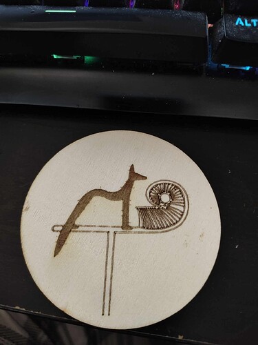

I have a very simple diode laser attached to a 3D printer, it works great but I’m having some trouble with the “overscan” function which appears to be leaving small trails / lines outside of the bounds of the image. I wasn’t sure what it was until I turned overscan off, and it appears about 90% better (though I obviously know the trouble it can cause to have overscan turned off as well).
I have very little to no knowledge about what I’m doing admittedly, I’m only doing basic things, I’ve not gotten very deep into the settings. My confusion is that it doesn’t happen on every pass, just on ‘some’ of them, so adjusting overscan length for example I’m not sure is a wise decision.
Does anyone have any advice? Maybe it’s not even overscan, maybe it is something else and overscan is just affecting it.

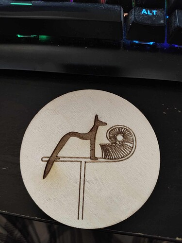

Attached are images with overscan on, and overscan off. Edit: I should mention only the dark figure (jackal) is printing in an image mode, the rest is in line mode, but I did a copy of this where the whole thing was an image and it all had those artifacts all over it.
It looks like you’re getting the artifacts regardless, unless those bits on the back of the front legs are also in your design?
The reason you’re seeing more of it is because with overscan on it’s travelling past the boundaries of that shape.
I reckon this is probably a failing power supply for your laser source, so it’s switching off and on when it shouldn’t be.
The bits on the back of the legs are not part of the design, no. That’s why I mentioned it seemed 90% better if nothing else
There doesn’t appear to be anything wrong with the power that I can find. The laser is of course powered by the 3D printer, and the printer works as a 3D printer without any issues
Are those artifacts in the preview in LightBurn?
No definitely not
And, again just for clarification, the design has no issues with line or even offset fill, it’s mostly just image and fill that have this issue which is what led me to believe it’s something about the overscanning
Then it’s definitely machine-side. There’s something squiffy. Maybe connection, maybe power, maybe loose belts, but definitely machine-side.
