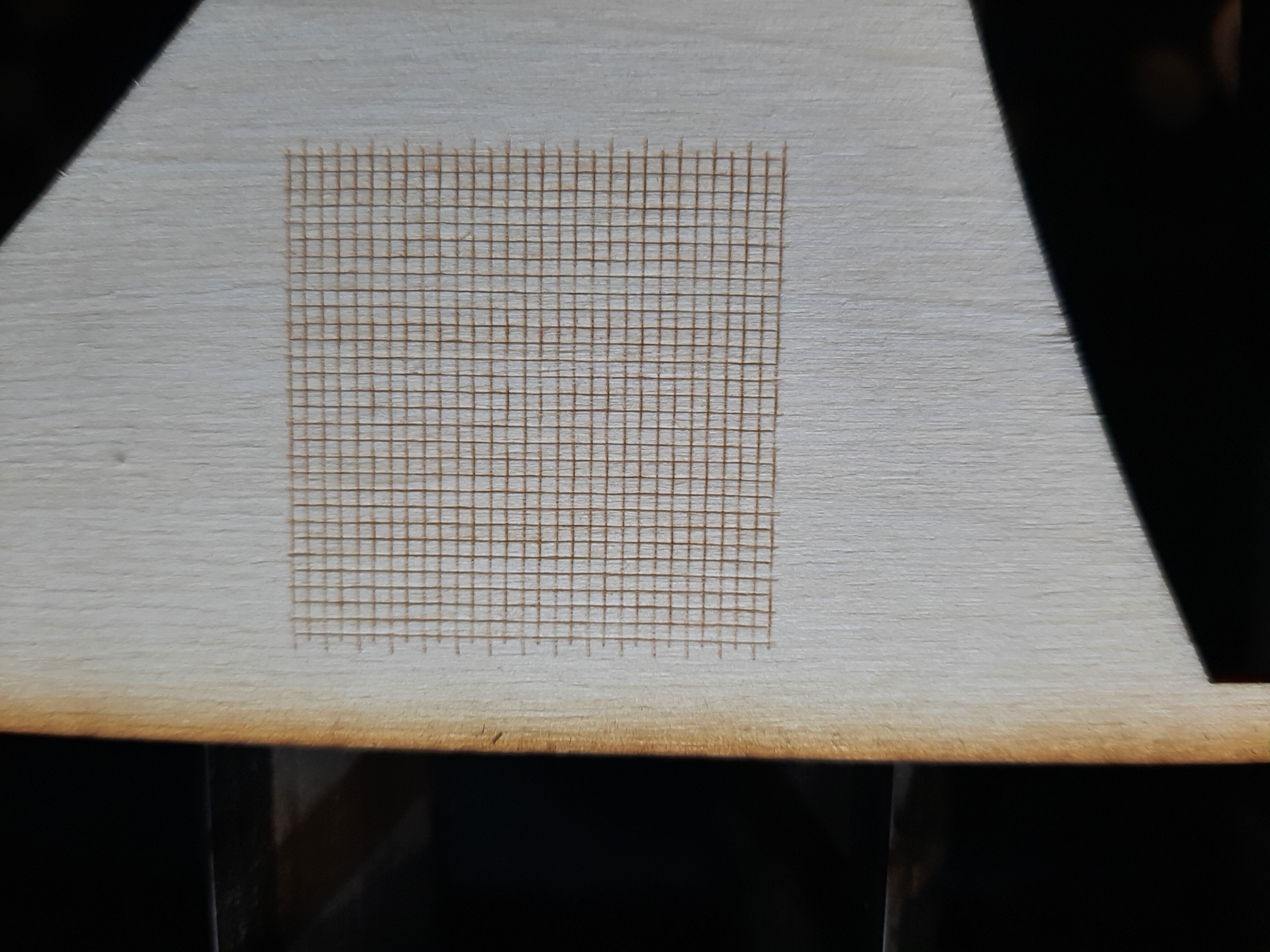

The issue I am having now is what I belive to be overshoot or backlash. It has progressively gotten worse as I use the machine. All the mechanical parts are in order and the only things that are left are the software, hardware, laser psu and belts.
This is a 30mm x 30mm square at 500 mm/sec.
X left to right seems fine maybe a bit off but Y top to bottom is way off.
Looking for a place to start as these machines and controllers are new to me.
Any help is appreciated!
500mm/sec is your problem. That’s way too fast for the cheap steppers, drivers and LPSUs in those RedSail machines.
As a comparison, I use name-brand hybrid 3-phase steppers and still get artefacts at 500mm/s.
You are overshooting the start point in both directions.
Reduce power and do the same job at 100 and see what your results are.

The outline of all squares was at 100 mm/s. The infill speeds progressively got faster.
Thinking out loud. Seems that the laser starts early and ends early no matter what the speed is. Which would leave me to belive either this is some kind of slop or slack mechanically or that the laser response time is faster then the controller thinks it is. Am I on the right path here?
X is better then Y but X is still off just a bit and in the same manner.

It’s a timing problem, as you can see how it grows the faster you go.
Belts should only be ‘softly tight’ - they shouldn’t vibrate if you ping it. it’s not a friction belt, they should only be tight enough that the shoulder doesn’t ride up the crenellation on the sprockets.
I can’t comment on the Moons driver - never seen one.
Assume that your CNC components are fine (apart from a bit of wobble you can see in all those images.) the problem is the timing of the lpsu initialisation voltage lagging the controller and CNC components. Say you have a two-millisecond delay in reaching initialisation, at 500mm/s that’s a millimetre out. With movement in two directions, that’s 2mm out overall.
You can work it out by measuring the gap and dividing it by the speed, if you want, but you can see it, so measuring it is only useful if you want to add an offset.
A better, more powerful PSU/LPSU would sort most of that, but it’s a combination of every component from PSU(s), LPSU, driver, stepper, rails, bearings, mirror, lenses, tube, cooling, that affects the way your machine works.
If you have a ‘combo’ power supply that supplies the steppers, controller and tube, that is the most likely cause of your problem.

@Bonjour @pauldg123 Actually. This is fill mode. Just a 5 mm interval so I could see what was going on. The box/perimeter is line and there for reference to see which way and how far the fill passes were off.
After some testing. Offset scanning adjustment seems to be my cure (still need to fix the wobble). Problem is it’s changing X and Y at the same time. It will be okay 99% of the time as most engravings are done with X axis moving at high speed. If I wanted to do the cross hatch, which I like the look of, the offset scanning will be off on one axis.
