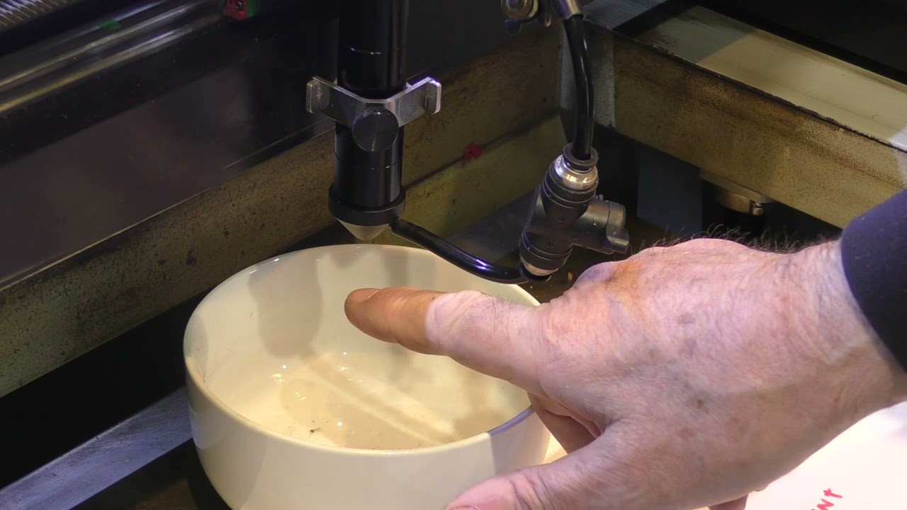

I have great respect for Russ Sadler, so I thought Iā€™d post this video. He claims itā€™s for a co2 but if you watch it, the information is applicable to all lasers and he does admit that. The only effect is a change in the lasers frequency.
He speaks about lenses and shows one that is opaque, if you have a visible light laser, then it will be opaque to that lasers frequency.
What/how the material is affected is based on frequency of the laser. Itā€™s a good video that I 100% agree with and wish more people would watch itā€¦ If I remember right itā€™s about 30 minutes.
I agree with Tesla, in that I believe it resonates with the materials molecules causing the damage, but thatā€™s my view.
