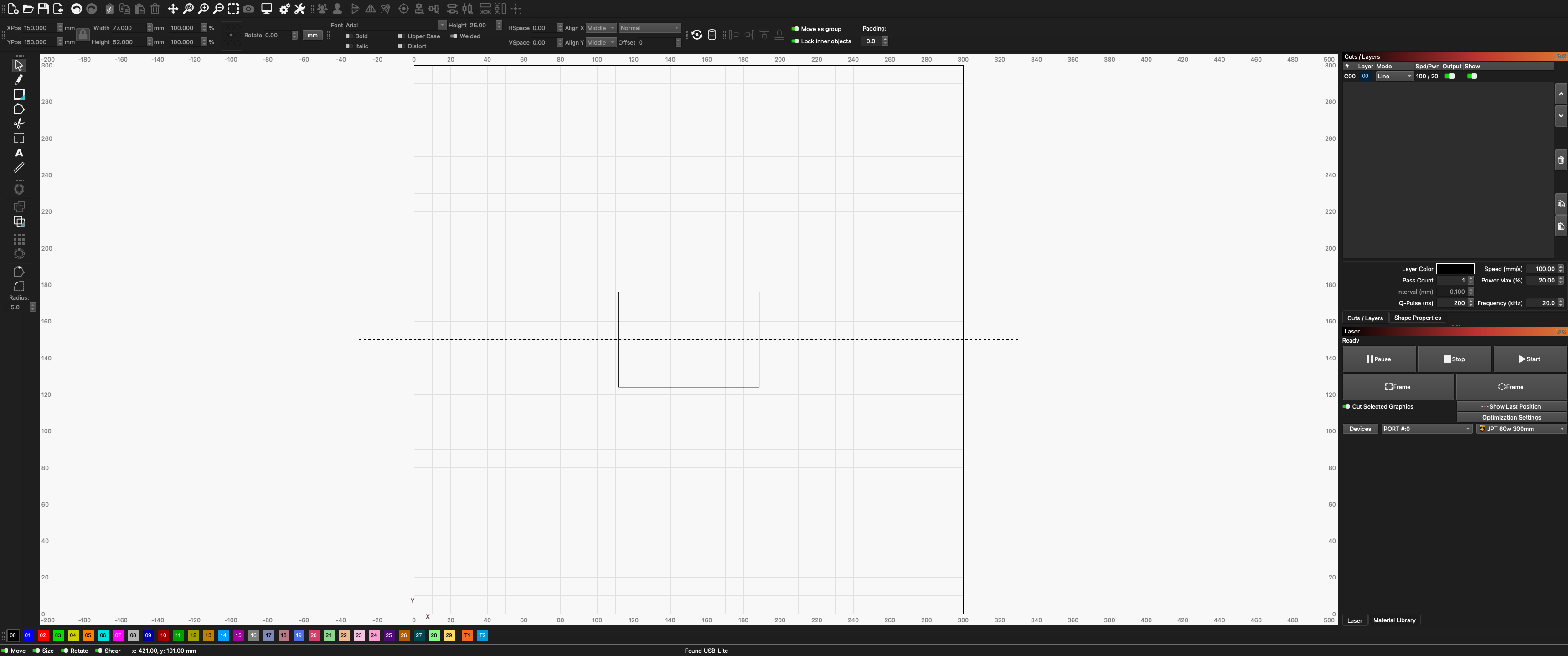

Have been using lightburn on my Mac on Windows for about month no issue. Yesterday I ran a project thought the Mac and when I returned a few hours later to run another, Lightburn will not frame or fire the project. Absolutely nothing changed but the hours time between jobs. I hooked the laser to my laptop and it works fine. I do have to use USB-C adapters with the Mac because it doesn’t have USB-A ports, but they’ve been working fine for weeks. Not sure how to get it back up and running. It shows connected and even runs the timer if I hit go, but nothing come out of the head.
I have
*manually selected the port
*reset everything
*swapped adaptors
*checked permissions (not sure if I missed one)

Can you show us a screenshot of the entire LightBurn window while running a job?
The Mac is the one with the issue. I had been running it on the Windows laptop without issue and thankfully I had that handy to complete the job.
As far as the Mac is concerned I transferred the User Bundle a few weeks ago and it’s been working fine up until yesterday. Im not super familiar with how to take a screen shot, but it looks and acts identical to if it was working like it should. The only difference is that it will not frame or fire the laser. The dialog box comes up as usual and if I hit start it will act like it running the job and run the counter as well, except nothing is being output at the laser head.

The notice “Found USB-Lite” on the bottom of the screenshot is promising.
If you have any other devices connected, remove them temporarily for evaluation
Does the status in the Laser window change from “Ready” to “Framing”?
