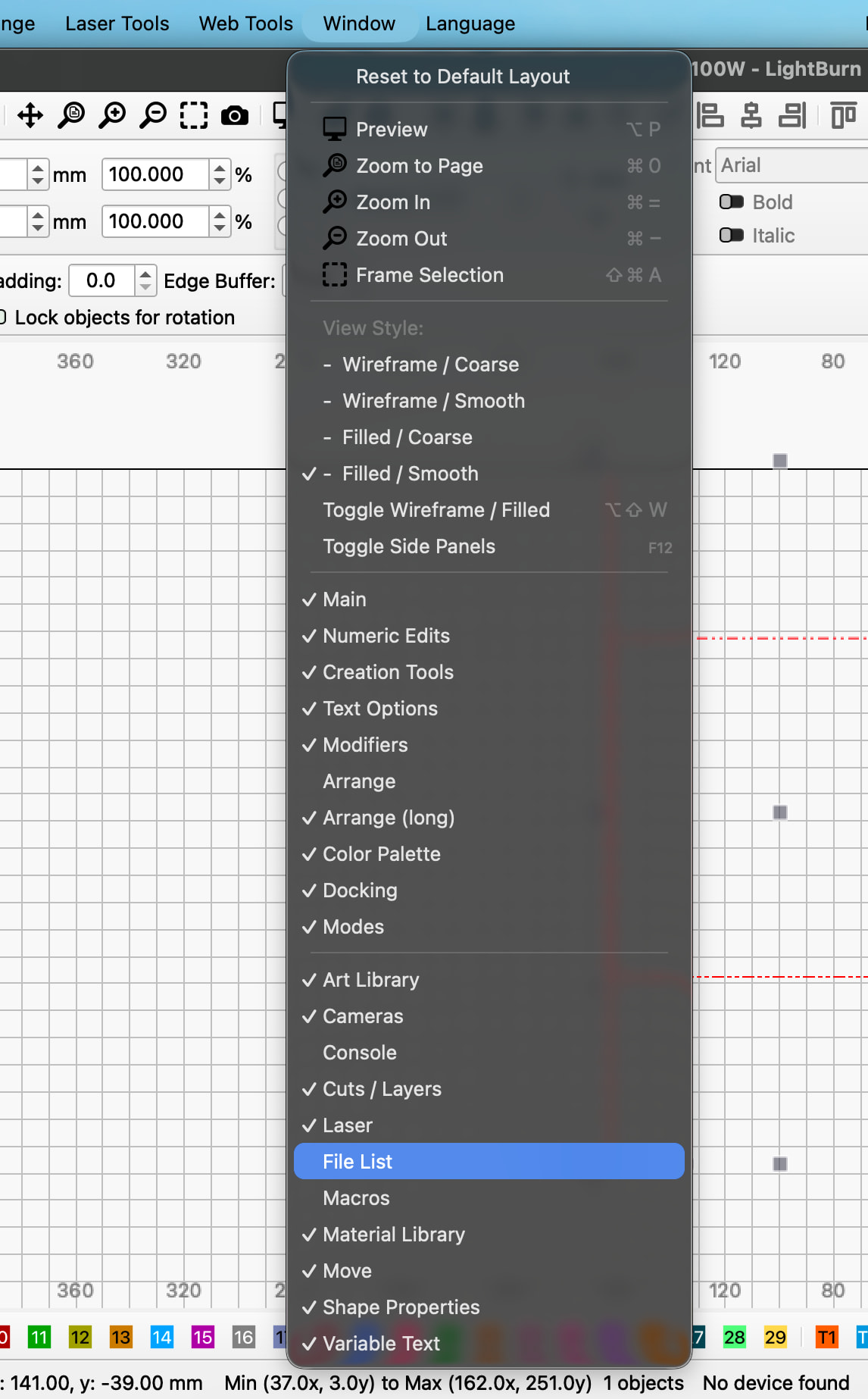

It may be that your controller is full. They have a limit to the number and size of file they can hold and start doing strange things when full.
The easiest way to clear it is with the File List in Lightburn.
No files loaded. That was my first thought, but I don’t have it storing files, memory gets wiped when powered off. Even checked on the panel itself, no files loaded. It only seems to do this when sending fill to the laser. Line goes right through no problem, but fill sends a couple items, then errors, laser does those and parks like job completed.
