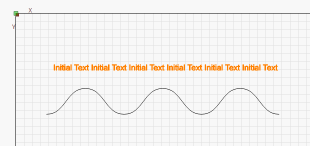

I have a web app that I am building that generates various shapes in SVG. I have an option that copies the SVG markup to the clipboard. If I paste the clipboard contents into Lightburn it adds the shapes correctly but just does not let me use the Apply text To Path option. If I save the clipboard contents to a SVG file and import it then the Apply text To Path works. This is a sample of what I pasted and was also saved to a SVG file.
<?xml version="1.0" encoding="UTF-8"?><svg xmlns="http://www.w3.org/2000/svg"><path d="M 0 120 c 60 0 60 -80 120 -80 c 60 0 60 80 120 80 c 60 0 60 -80 120 -80 c 60 0 60 80 120 80 c 60 0 60 -80 120 -80 c 60 0 60 80 120 80" fill="none" stroke="black" stroke-width="1" /></svg>

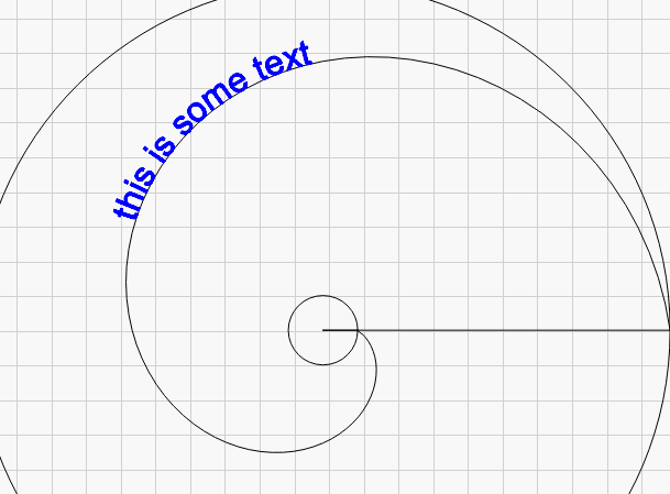

Some time ago I wrote an SVG spiral generator for Lightburn which allows you to save the SVG to a file or copy it directly to the clipboard. I’ve just tried pasting the generated geometry into LB and after ungrouping everything I had no trouble applying the spiral path to some text. Is your path part of a group?
Marcus raises a good point - By default, we group imported files, but it’s an option that can be changed in the settings.
no, my is not part of a group. Attached is an examp
wave|0x0
le of what I am pasting from the clipboard
Apparently that is the trick, paste the SVG, select it in Lightburn, ungroup and use the Apply text To Path. I was not aware that it was added to a group when pasting which I guess kind of makes sense now.

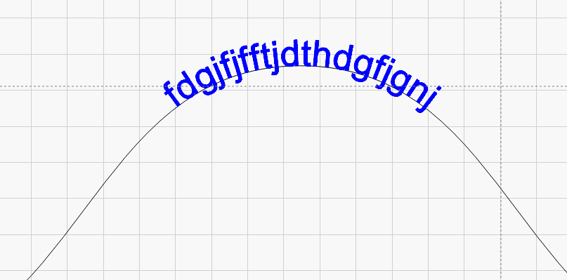

That’s interesting… I copied the SVG posted in your last post, pasted it into LB then applied path to text. Seems to work for me:
