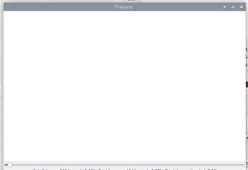

How does it look in the preview (alt+p) ?
The preview looks correct, including the missing 2 rectangles that I mentioned.
No issues with that.

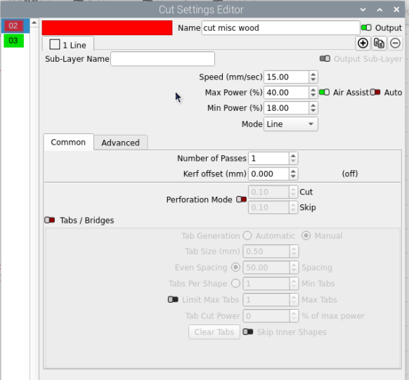

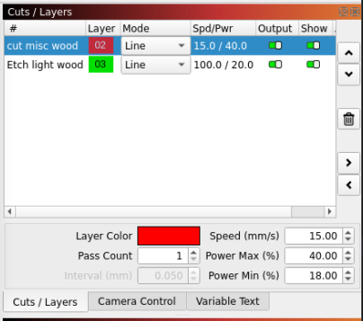

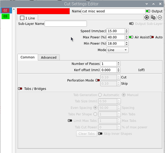

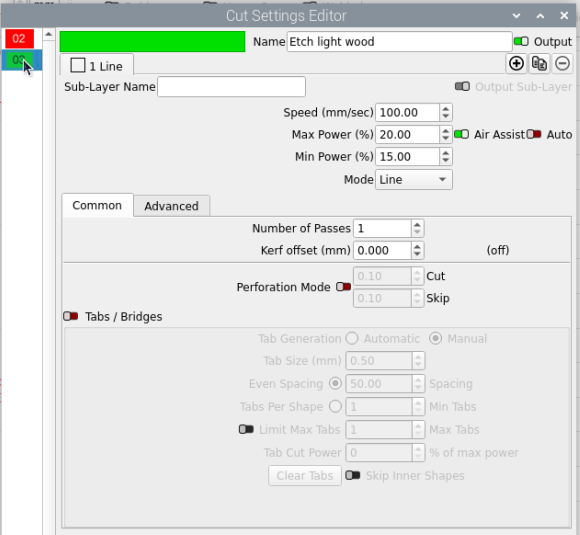

Show us a screen shot (not a cel phone picture) of your cut setting and layers settings.

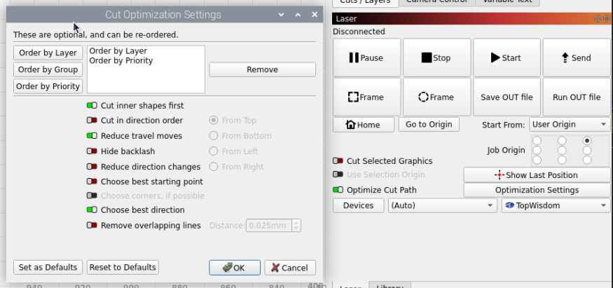

Do you have “cut selected objects” turned on? Your photo shows only the red dashed line will cut, the red solid and the green solid lines will not cut.
Optimization settings are at the defaults:
No, it’s turned off (see screenshot). I only selected that line for this photo to highlight that it’s not connected to the red curve above it, in case that might be part of the problem.
My settings are as close to the defaults as they could be. I installed LB on this particular device yesterday. Imported the SVG, ungrouped some parts to remove unwanted text, rotated it to portrait to fit my material, adjusted the cut settings, hit “Send” and manually started it from the laser cutter.
