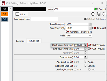

how to pause the job between engraving and cutting (to activate air-assist)?
Is it possible?

In the ‘Advanced’ tab for a Line Mode layer in Cut Settings, you can add up to 10 seconds pause (9999.99ms) before the cut starts, like this;

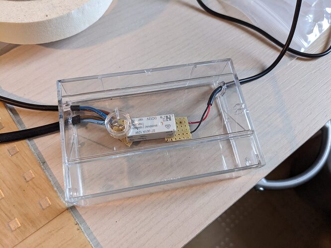

Could you please elaborate on how LightBurn control the relay?
I use the M7 or M8 output driven by lightburn
I have pictures of my system if you want.
Thanks! I was wondering about the hardware parts.
So you used the expansion board (14$) and your motherboard’s dedicated M7 or M8 socket.
Here the whole sketch:
thanks
My Air-Assit is powered by 230V, so I took a 230V relay (12v coil). The power is low, so I made a light assembly, but sufficient, and which works well.
