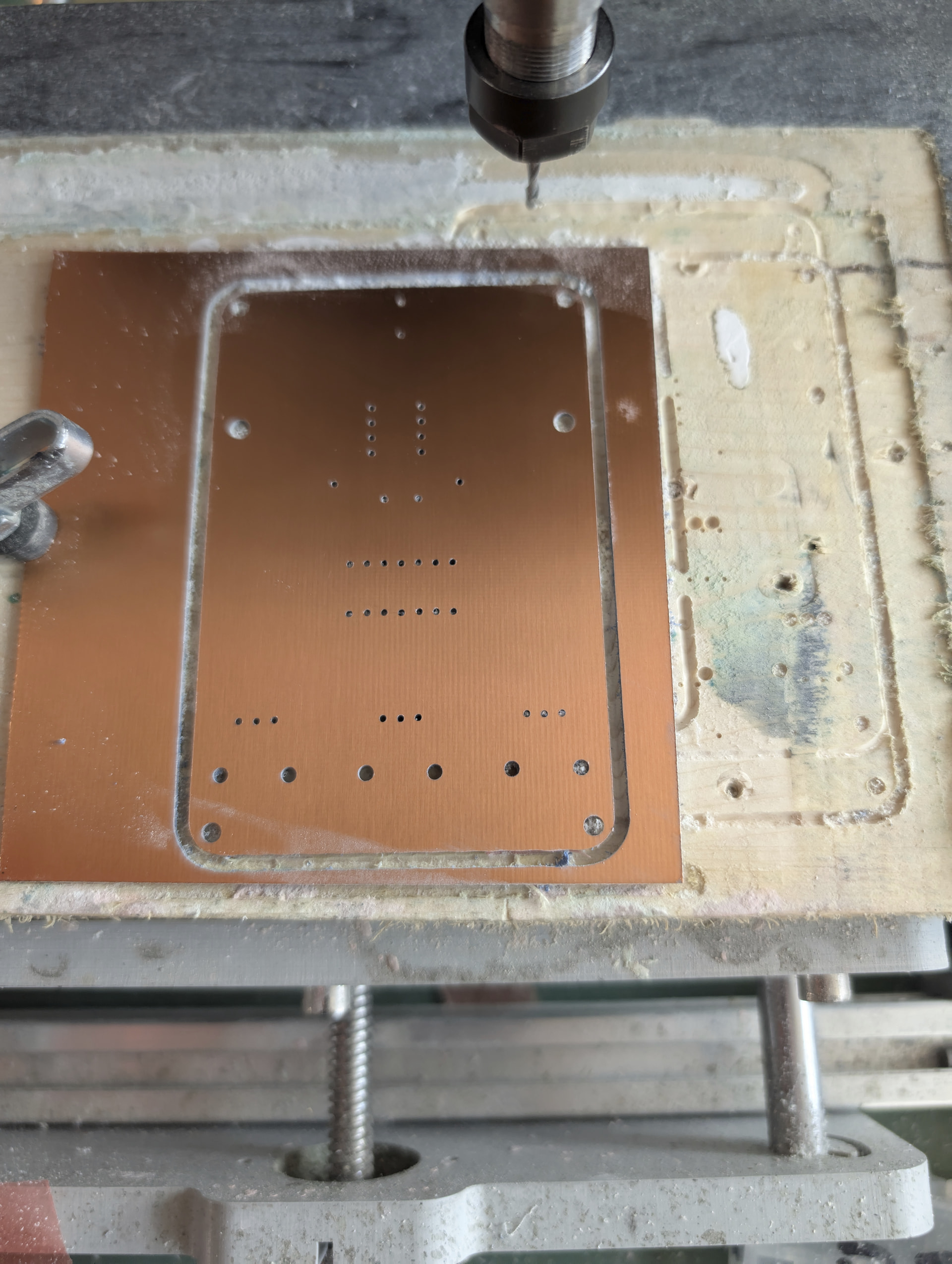

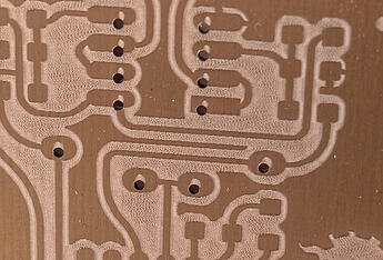

It’s been a while since I did this, but I still wanted to share the pictures.
Drilling holes and milling the outline with MillMage:

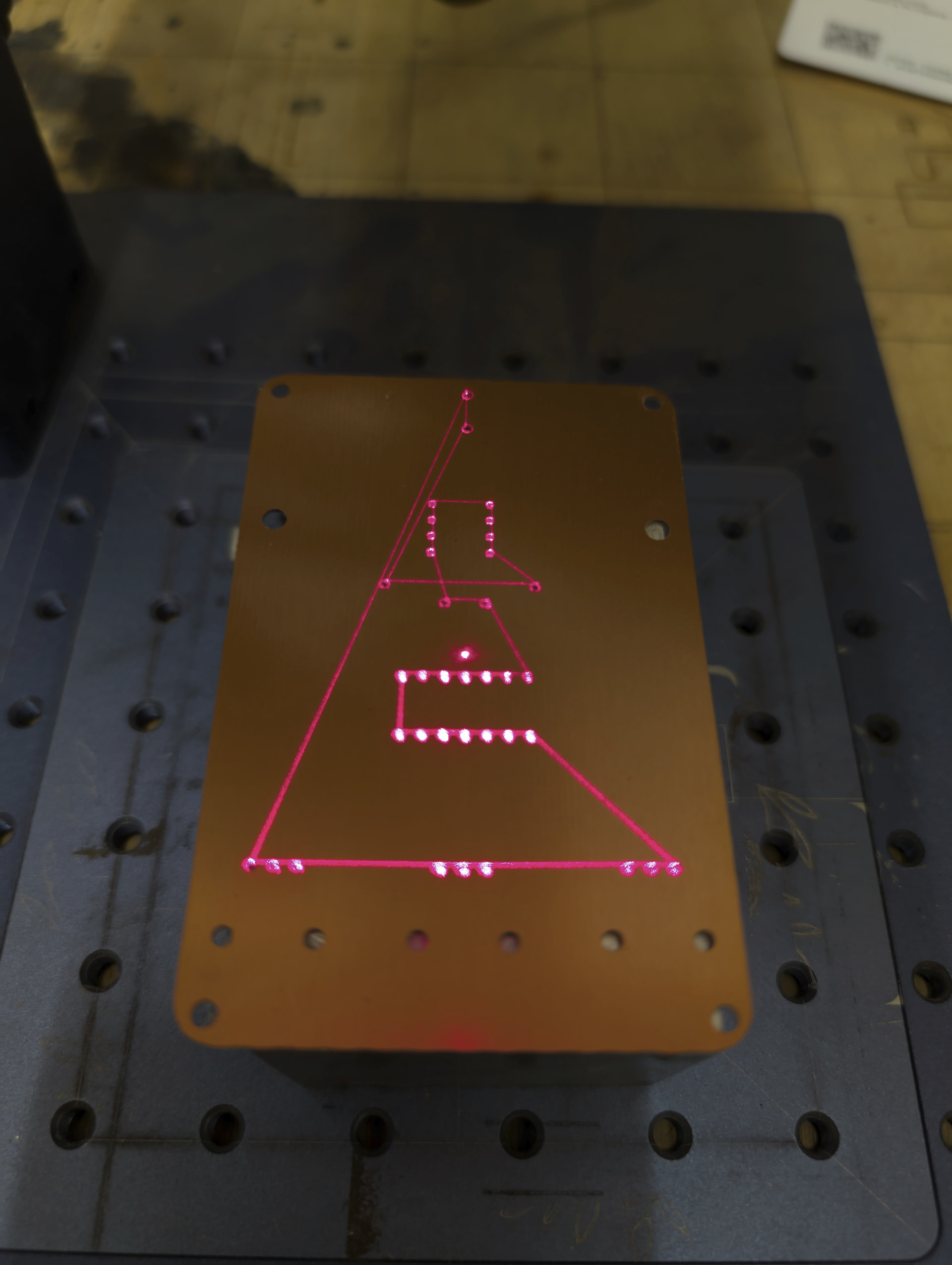

Aligning the design by framing only the holes:

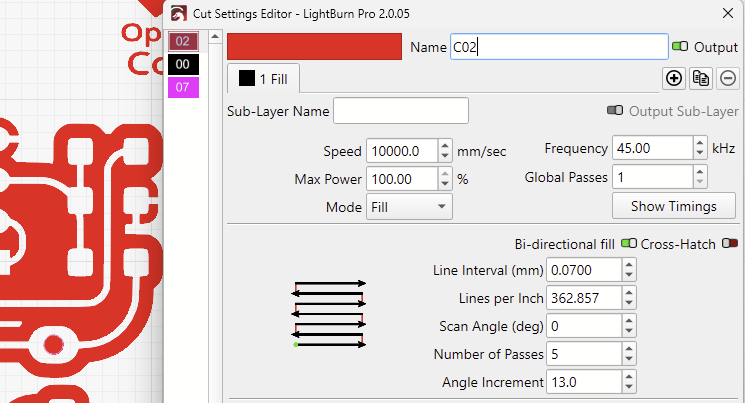

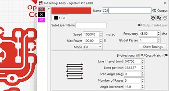

The UV lacquer comes off easily, so the settings aren’t very important.
This is what I’ve used:

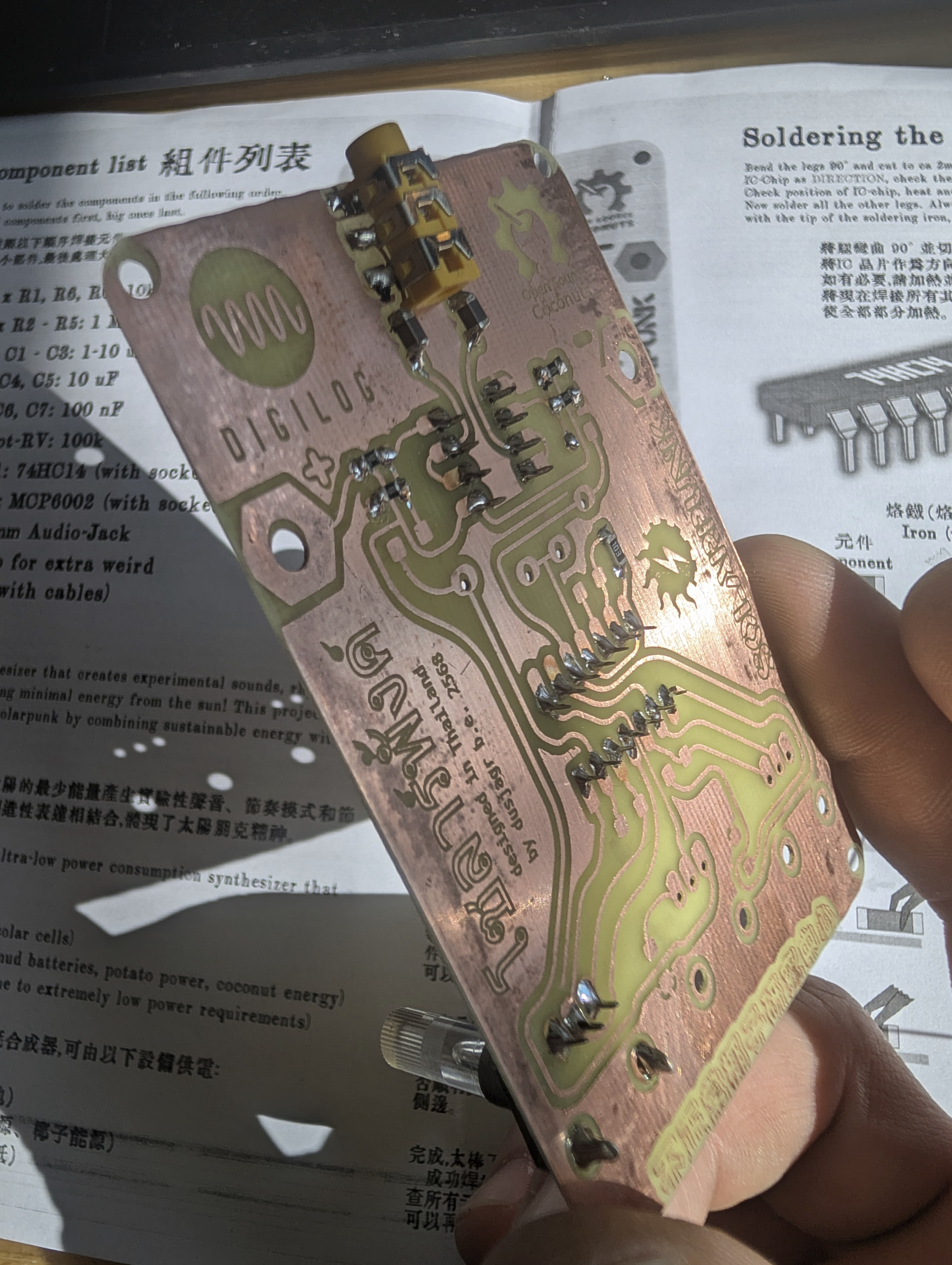

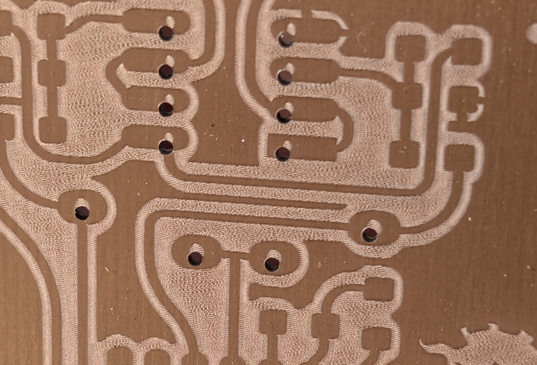

It looks terribly unfinished, and I didn’t place the holes neatly, but still got crisp outlines after the bath
A little buffing with a Scotch Brite Fine pad before soldering would have made it look a lot better.
