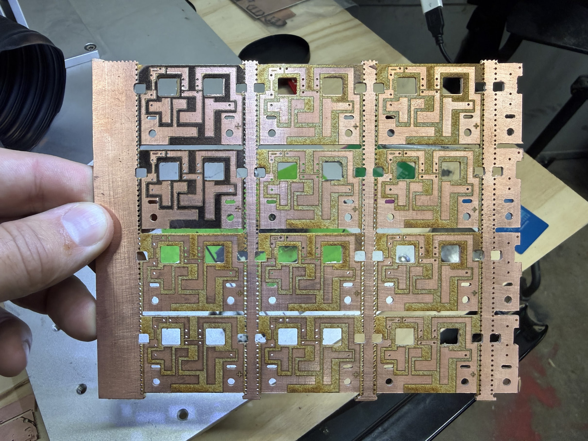

I have had success with PCB etching but it has taken using a MOPA Galvo Fiber laser to really be able to etch and ablate the copper in a way that is consistent. This process uses both MillMage and LightBurn to do the full process of drilling, routing and removing the copper.
Laser Used: 50w JPT MOPA Galvo
Line Settings:
  • Speed: 750.00 mm/s
  • Pass Count: 2
  • Power Max: 100%
  • Frequency: 25khz
  • Purpose: Create a cut line in the copper to separate the copper that will remain and copper that will be ablated in the Fill Layer Process.
Fill Settings:

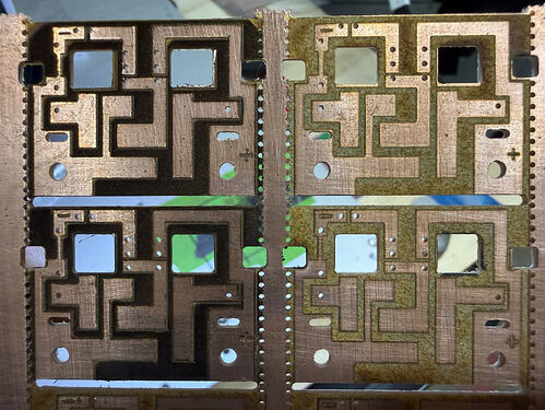

  • Pass Count: 2 (single pass will leave a charred look, second pass cleans up the area)
  • Power Max: 100%
  • Frequency: 25khz
  • Line Interval: 0.0250mm
  • Lines per Inch: 1016.000
  • Scan Angle: 45deg
  • Angle Increment: 90
  • Purpose: Ablating and removing copper in the areas that need to be non-conductive.

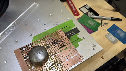

Focus is very important to maximize the strength of the beam. Copper is one of the harder materials to laser etch. I have tried doing this exact same board on a GWeike 50w BSL Fiber but was not able to get a consistent line cut or etch. Make sure to proper ventilate or filter during etching as you are vaporizing copper.

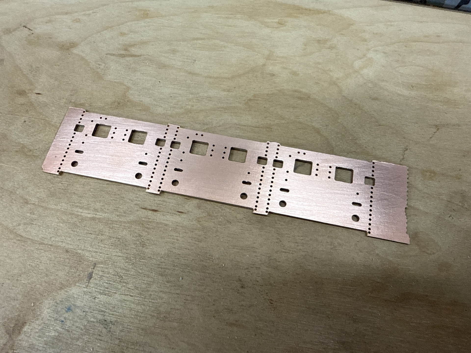

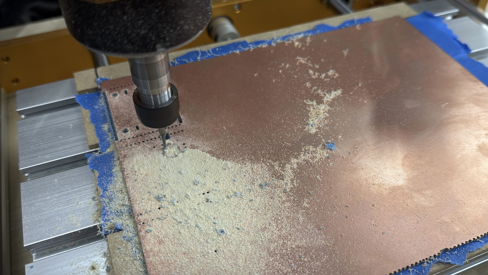

Drill and Routing was done with MillMage on a 3018 Pro CNC Router using a 1mm 2-flute drill bit (Union Tool NEU1.00MML009W) and a 1.5mm Burr End Mill for PCB Routing. The 3018 Pro CNC Router is the perfect little machine for fine work like this. Make sure to have proper dust collection as the burr routing will generate a very fine fiberglass dust that easily travels through the air. Outside of doing a vacuum table the next best hold down I have found is using painters tape on the table and back of the PCB board, then applying super glue between the tape layers to hold the PCB down for cutting. A vacuum table would be the most ideal hold down method but I have not gotten around to cutting a vacuum table yet and sourcing a vacuum pump.
Other hold down methods I have tried with PCB routing…
  • Basic clamping: Issue here is the boards have a tendency to pull up in a burr end mill. On the edges it was fine but cutting a larger area (e.g. 150mm x 200mm) the middle would pull up into the bit when milling.
  • Carpet tape: Carpet tape is a 2 sided membrane tape that typically is reinforced with threads running through it for reinforcement. It is very sticky and work great for holding down an object to the bed of a router. The But… It sounds great until the bit gums up and/or you have to remove the adhesive. Other applications this is a good technique but when it comes to PCB routing and the style of end mill you use, it is very easy to gum up a burr bit with a style of adhesive like carpet tape. Also there are issues with flatness to the table, especially if you get a bugger of adhesive which is not uncommon on the edges of the tape.

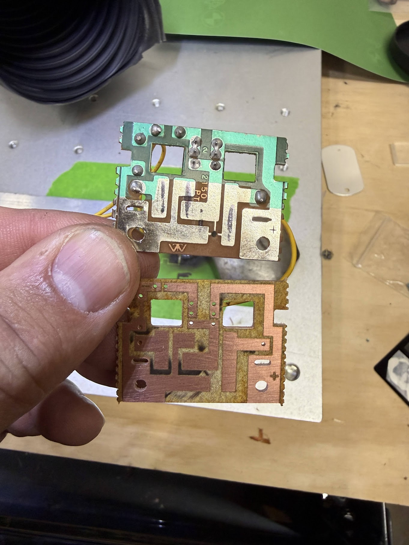

Side note… you may be asking yourself “what is he making?”. This is a replacement circuit board for a 38 year old kids train set that I had as a kid and am restoring to give it a second life. I am reproducing the original circuit which is very basic. Hooks up to a motor, switch, LED w/ resistor, 4 C-cell batteries. There is a slide circuit that reverses the polarity of the motor to change it from forward to reverse. I have modernized the circuit so you can run an inline resistor on the LED or if you want to go old school you can cut a trace and do a through hole resistor. Also the switch through holes have been adjusted for a modern version of the switch.
Original board: Top, Modernized version I created: Bottom

This boards perimeter, notching and holes made alignment/scaling easier in this project when framing the board on the galvo through LightBurn. I have another project I am just starting that will show batching of boards and with that one I will be adding alignment markers to help align the boards between drill/routing and lasering. This board I posted here is replicating a 38 year old PCB so I calipered all of the pads, holes, etc and CAD’ed them out. The notching on the boards made aligning processes easier between MillMage and LightBurn. Also it was CAM’ed out in MM and LB on the same base drawing. The next project, which I will be posting as well, will be honing in more on a project out of KiCAD brought into both MillMage and LightBurn to then create a set of PCB’s.
