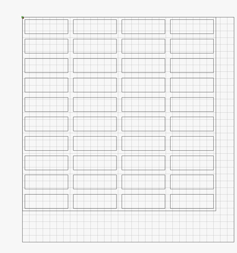

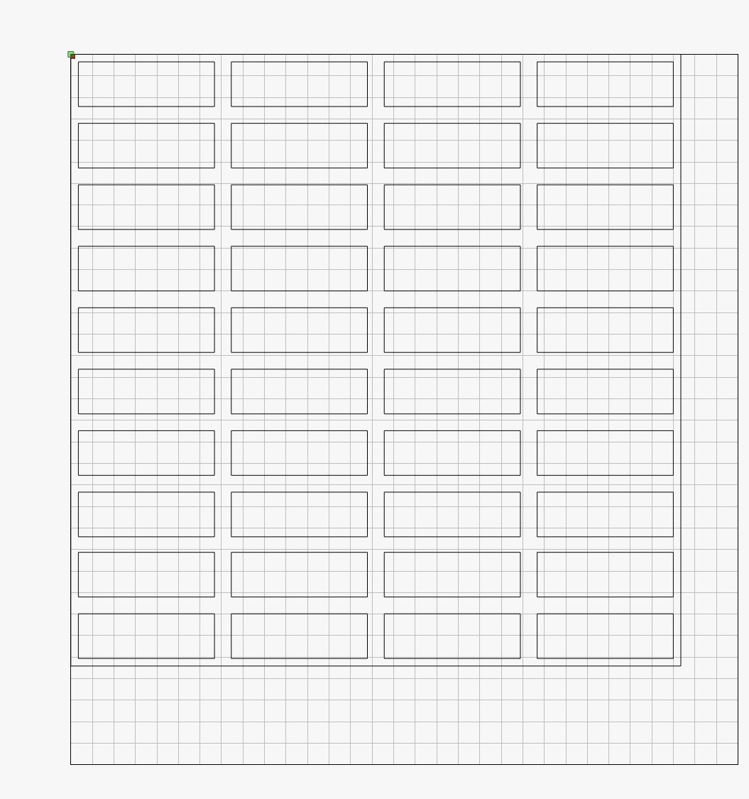

I have made a file in Adobe Illustrator, exported it as an SVG. Imported it into LB. Created a width x height total square, enlarged it slightly and of course centered it all. Here is what my LB looked like.

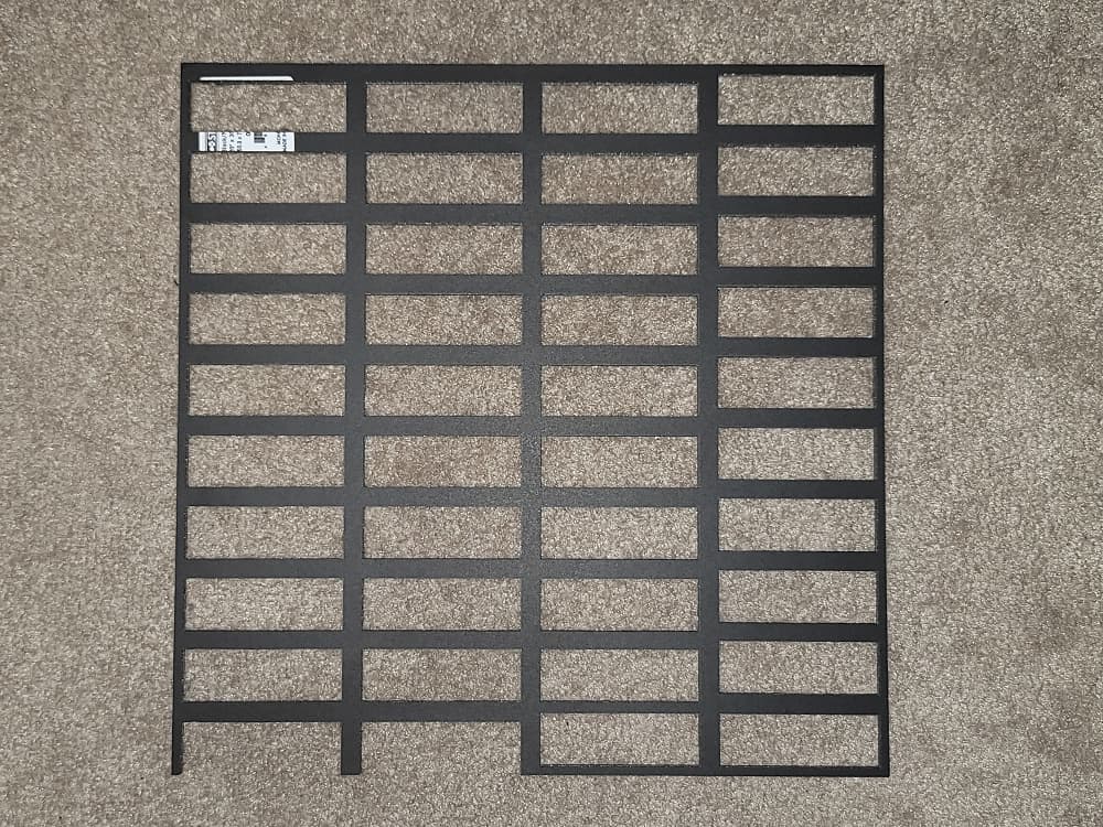

When it cut out, it looked like this,
The perimeter spacing is 3.5mm however the spacing is actually 3mm (thinner parts) - why is this not cutting as actually 3.5mm? The same for the right side. When you start looking around there is a whole host of issues.
Column one is too low, and the entire column was shifted down into the perimeter below, causing it to cut incorrectly.
Column two is too low down, same thing.
Column three is good, but the spacing at the top is 2x what it’s measured to be, and correct on the bottom - but only for the fact that the vertical spacing of column three at the bottom, is now wrong. Notice the gaps as you go down, they get thinner on the last two gaps.
Column four is doing it’s own thing, but it’s the correct distance from the perimeter top, right and bottom sides.
How can all these cut so wonky when the file is perfect?

This is likely not an issue in the design as far as alignment is concerned. This is most likely a mechanical issue possibly coupled with a configuration issue.

From what you’re saying i tend to think the issue is purely mechanical, not configuration or design related.
It seems like you’re missing steps somehow. Your speed in the design doesn’t seem excessive so I assume this is not the issue unless there’s something specific to your setup. I would suggest first checking your belts for proper tension, particularly on the Y-axis. The belts should be taught with no slack but should not be stretching. Check for any binding as well. The laser head should move very smoothly and with little force.
While you’re checking tension examine the belt teeth to make sure none are damaged or missing. Make sure you’ve got good engagement with the pinion on the stepper motor. Double check that the pinion has solidly attached to the stepper motor with no backlash. Recheck the grub screw to make sure it’s well attached.
