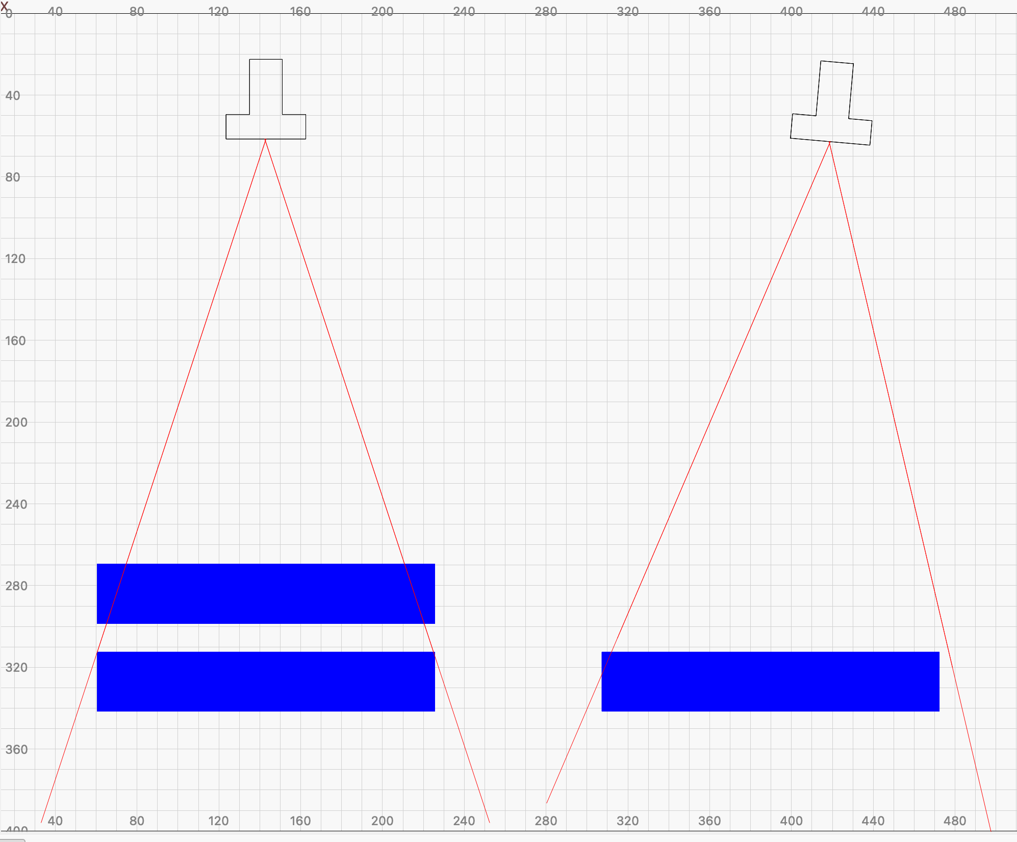

No, that’s not possible. It’s not a simple calculation. In theory you could create a calibration like this, but you would need a more complicated calibration procedure beforehand. With the calibration as it is, you only get a relationship between image pixel and workspace coordinates. The height makes this three-dimensional. So you require exact positioning in 3D space and beam angles of the camera optics. It’s possible in theory, but since people already need an explanation of obvious facts (like your video gives, no offense), 99% of them will fail to accomplish this calibration.

Sometimes it is easier with a simplified sketch to explain what is happening and why a static height and angle are crucial for precision with the LightBurn camera system.
In the example on the left you can see the (exaggerated) influence of the height and on the left the influence of the angle orientation in relation to the result.
Some height and camera angle combinations are less exposed than others, but the problem is always the same.
