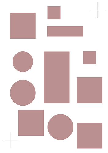

Design Workflow:
1.I design files in Photoshop, export them as PNGs, and convert them to SVG.
2.Print from Photoshop without scaling (verified physical dimensions match design).
LightBurn Setup:

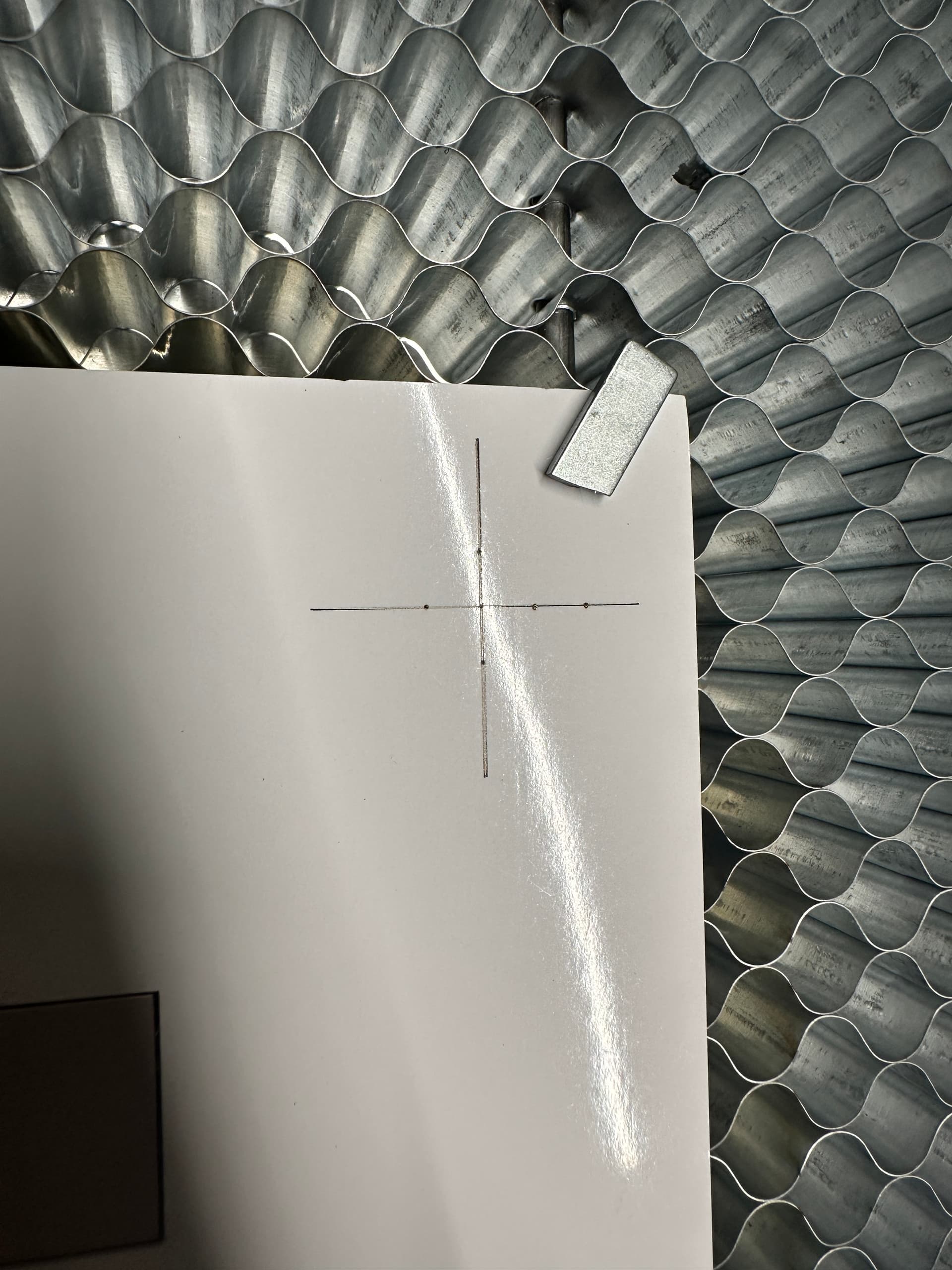

1.In LightBurn, I import the SVG, ungroup it, and use the console’s jog controls to align two crosshair markers with their target positions. I pulse the laser to mark the center (not using the red dot pointer) and save these positions for quick relocation.

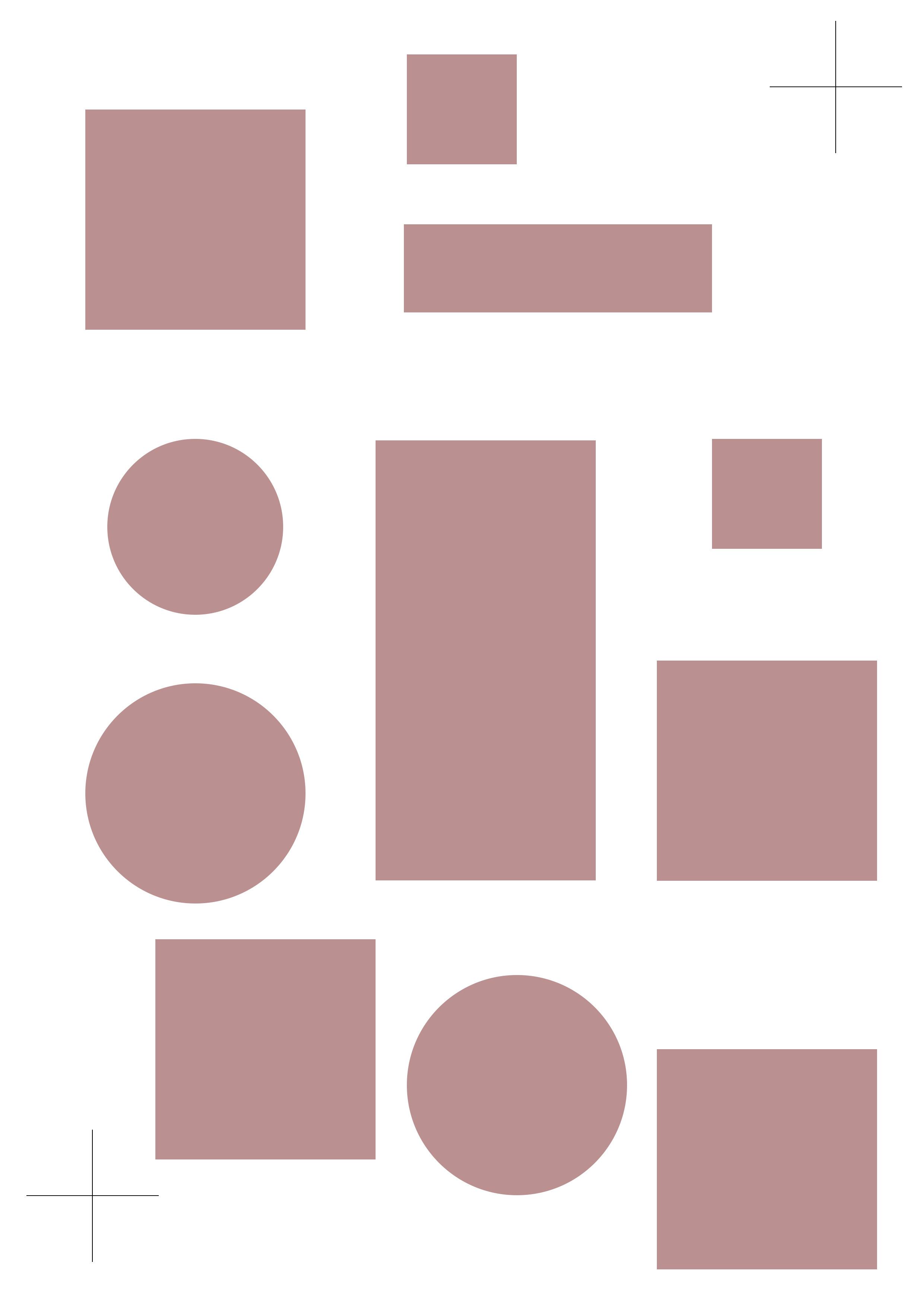

2.After homing the laser, I set the first target position (top-right corner). Then I home again, set the second target position (bottom-left corner), align output to targets(no scaling)
3.The cutting starts from the absolute coordinate position. After cutting, the final pattern matches the design dimensions perfectly, but it consistently shifts toward the top-right. I’m at a loss for how to resolve this issue.

The first thing that comes to mind is do you have laser pointer offset enabled? That would account for a consistent drift if you’re using the laser itself for alingment and not the red dot. Disable pointer offset and try again. Also, don’t home the laser during the print and cut setup. You can home it before starting the process, but not again during the process. I’m not sure if this is causing any actual problems, but it is more movement tn=han necessary.
Step 1 = Pulse the laser.
Step 2 = Home the laser
Home should be the first thing you do before anything else. After it is Homed, never reposition the laser using your hands. I am not saying you do this, but I included it for the benefit of others.

Something that I missed in your original post. You state that you’re homing between setting the targets. That is not a correct workflow. You should not home the machine after setting any target.
Just verifying that you are only using the move arrows to move your laser head, not ever moving it by hand, correct?
