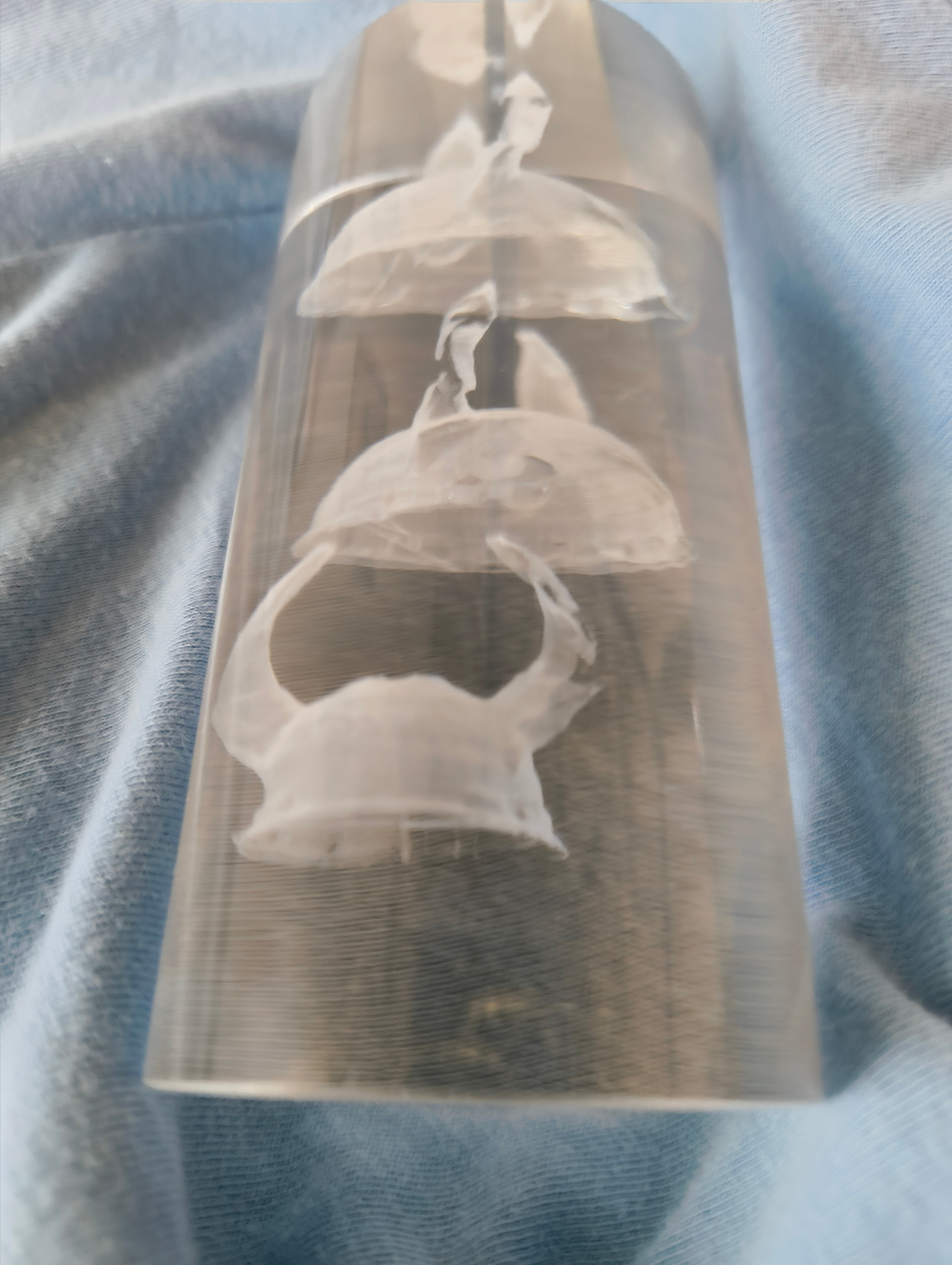

Everyone likes a picture, so have a Jab helmet (or 3) in bubblegram form. Still getting some settings dialed in, but starting to look good!. The cylindrical test piece is distorting them a bit, but have more on hand.

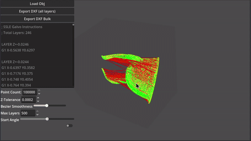

What did have some success was writing code to generate bubblegrams from 3d files. The approach I took was implementing a full physics simulation of how a galvo laser works. It’s far from performant, but is certainly a cleaner workflow than the previous described approach. Fine control over the slicing algorithm and adaptations that are specific to different fill strategies make good quality easily achievable. I even wrote one algorithm to account for a fixed speed z move, which may allow some testing sooner rather than later for lightburn stuff.
edit: sorry for the vid quality, forgot you couldn’t upload mp4’s here and imgur isn’t playing nice.
sliced in my program, from an obj mesh. red are the jump moves, or moves that fall outside of the tolerance to the mesh surface. green → yellow is how close the lines conform to the mesh surface. right now, only green lines are exported.

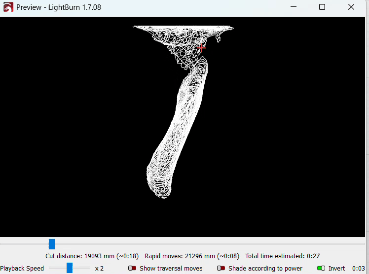

rendered in lightburn preview. All cut optimiztions off, to preserve the order generated in my algo seems to work, as the jump moves and starting point per layer seem to be preserved.
