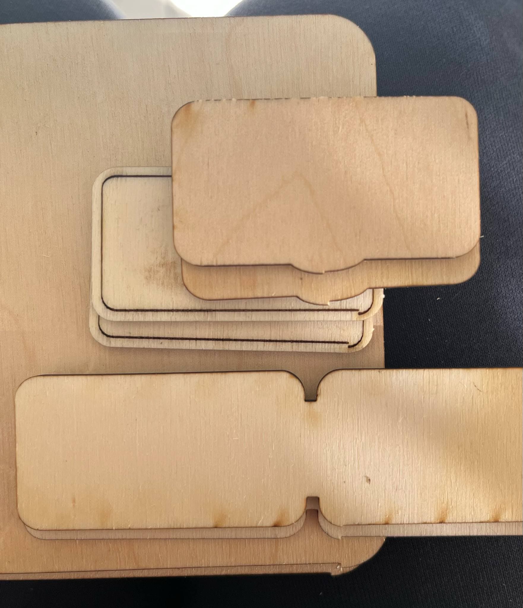

Phecda (20W) is not at all precise
I have a problem with my Phecda (20W + air system)
I’m using Ligthburn with this config file
Look at my test :
r/ELEGOOPHECDA - Help me to fix my Phecda
As you can see, i have some problem.
  • Text are weird
  • Some of cutting circle are OK
  • 1500/100 | 200/100 are NOT OK
  • All of engrave are NOT OK
How is it possible ?
I try to block my wood (it does not move). I don’t think there’s any problem with the slide or friction.
Have you some idea to help me ?
Thanks !

The circles are a sign of incorrect mechanics setup, check it carefully again (here are some hints: Guide to mechanical adjustments and maintenance) It’s mainly your y-axis that is not working correctly.
That’s mechanical problem.
Start with:
  • Check if the all frame is tight, then check for loose belts and screws from motor pulleys.
  • Check for residues on the rails too.
That looks like at some point you have a problem. Mostly on X axis at 100% power and Y axis at all “engrave” test.
For the text, il you lookt close at 300, 600 or 3000 there is a difference with other zeros :wink:

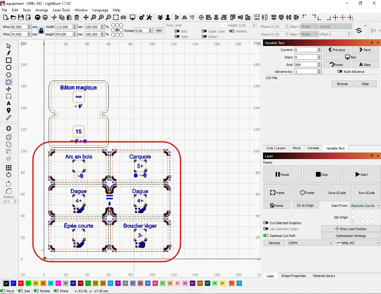

I tried to fix my machine.
It wasn’t straight at all.
But after fixing it, I have a problem
I tried to cut 2 times.
Once by putting my sheet of wood in landscape, and once in portrait and reversing its position on Ligthburn.
But the offset is EXACTLY the same.
It looks too suspicious to me for it to be a problem of belt tension or something, because each element isn’t cut in the same place in terms of X/Y axis.
Is it possible i have a problem with my driver of something else?

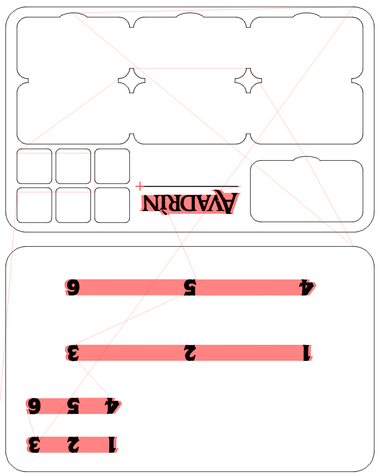

How does it shows on preview window?
Are you willing to share the file for for analysis by those who can help?
Hey @Kuth

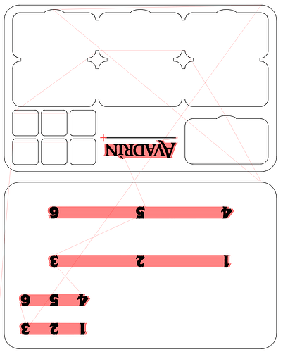

Here the preview mode :
Here the files :
player.lbrn2 (123,9 Ko)
equipment.lbrn2 (153,6 Ko)
So the drawing seems perfect to me, with no reason for what is happening.
I found some open shapes (outlined in red) that, although I don’t think they justify the problem, I would close them.
