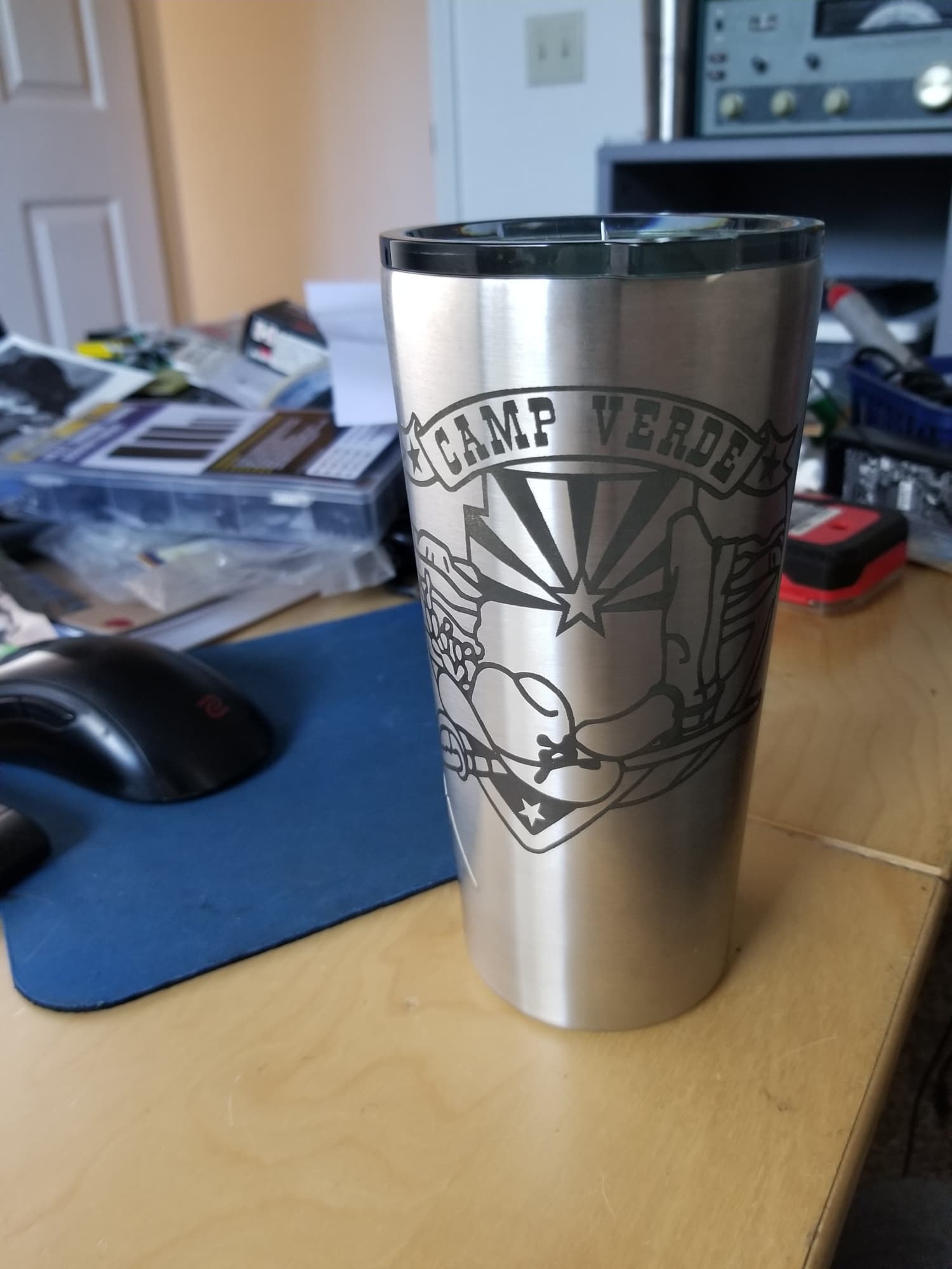

Anyone know how to burn an image on a tumbler? Basic powder coat tumber. I want to put a dog as an image. Will it work the same as wood engraving image? I know I can test but didn’t want to screw up yet another tumbler… ![]()

I use black tape, low power on the fiber and co2 rotaries I have to see what it’s going to do before I waste another mug… This is fiddly, as a more powerful laser usually has a more difficult time with extra low power… I run mine about 9% which is dead bottom and may not lase, depending on temperature…
This is my PiBurn… on a OMTech China Blue using LBT100 spray.
