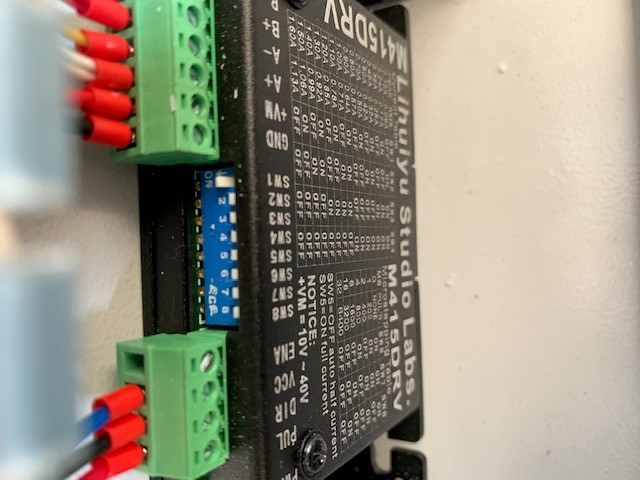

I have connected a PiBurn rotary to the dedicated rotary plug in our 100 Watt Blue & White laser. We have a switch on the front panel that turns off the Y and activates the rotary plug.
I have set the steps per rotation at 16000 (6400 steps x 2.5 PiBurn gear ratio) and set the roller diamter to 63.7.
I created the 10mm wide x 100mm long test rectangle per the PiBurn manual. I marked a tumbler with a start and end mark 100mm apart.
When I frame the job, it will make one complete rotation on the tumbler and continue to the end mark.
No matter what changes I make to the settings whether in machine settings or in rotary setup, nothing makes a difference on what the rotary does.
The only thing that will change what the rotary does is if I change the rectangle size to 10mm x 25.4mm and then it will move the 100mm from the start mark to the end mark on the tumbler
Any input would be greatly appreciated.

The 6400 steps came from the microstepping table on the driver based on the dip switch positioning.
dip siwtches
Microstepping table

I believe the your machine is looking at 6400 steps/rotation of the motor. If you set it for the 6400 (no gear ratio) and the ‘motor’ does not turn one complete turn and return, that’s a problem.
I’m suspicious that the motor type might be an issue…
At this point, it’s pretty clear the steps/rotation is in question. You have a very nice machine, maybe the motor differ…?
