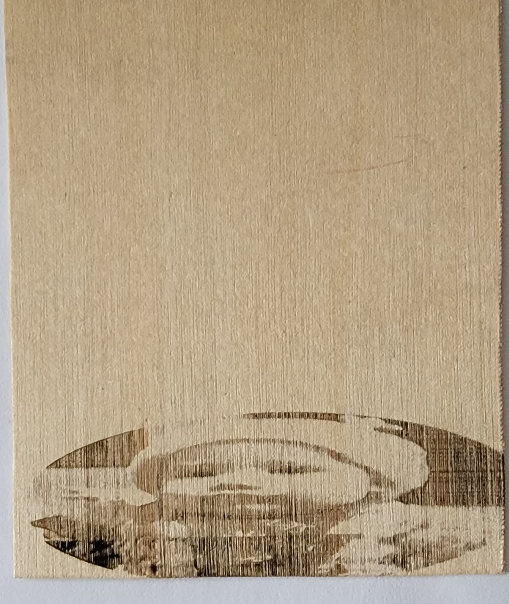

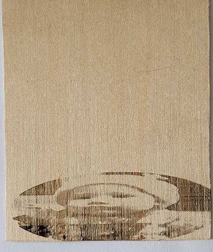

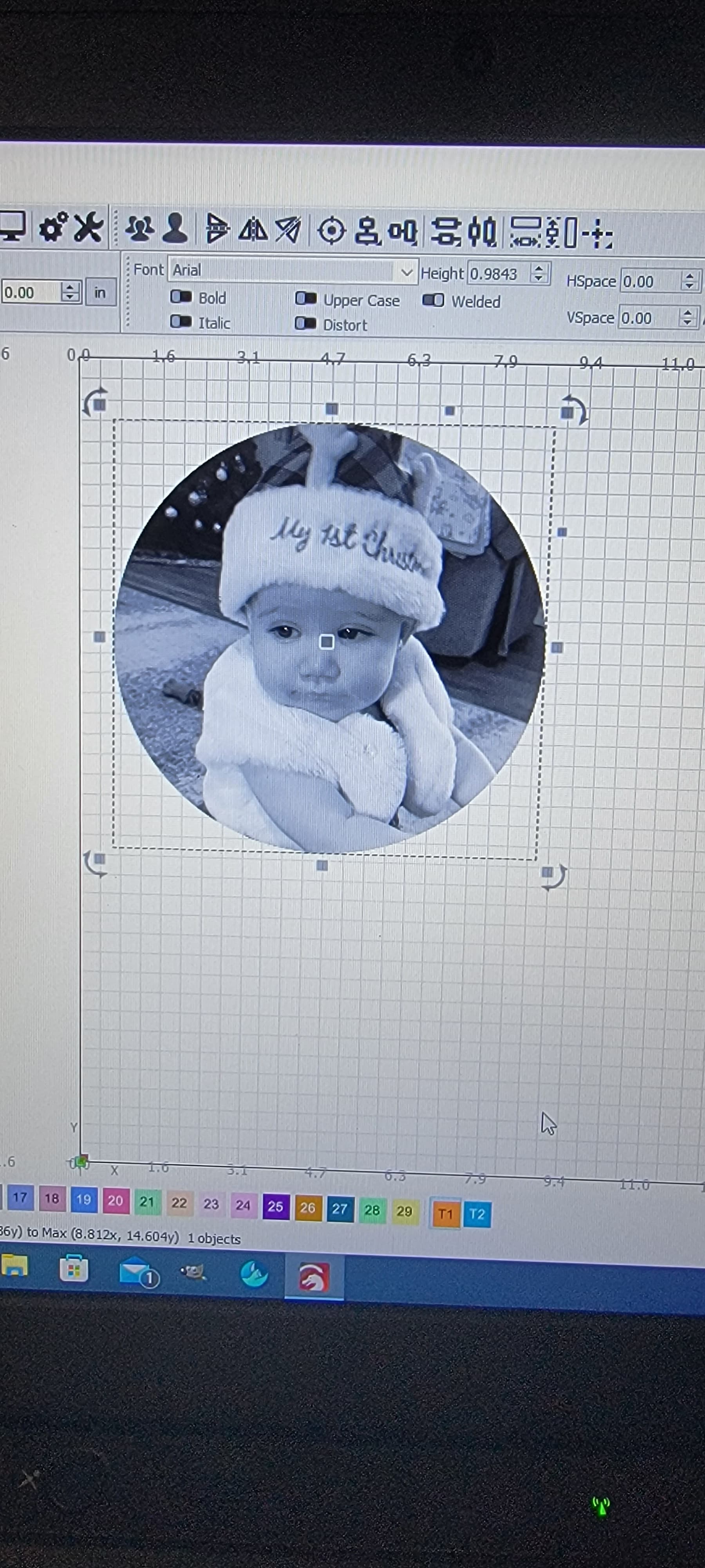

I’m just learning how to mask pictures, so i now have my picture masked the way that i wanted, but when it engraves the picture, it becomes distorted. I’ve checked the belts and screws and everything seems to be snug, I’ve been using my Ortur laser master 3 for almost a year and i haven’t had this issue until now. I’m attaching these 2 photos to show what the picture looks like on screen and engraved. Please help this somewhat newbie to laser engraving.
Do you have rotary enabled? If so, disable it.
Yes i do, I’ll disable it and try it again. Thank you
That seems to have worked. Thank you so much for that information.
