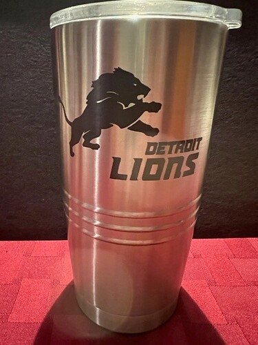

I bought the R3 roller and did not find it very useful. The rotary chuck is a much better design. Especially if you are engraving products that have a tapered design. Ive been doing wine glasses, glass tumblers, and stainless steel travel mugs for a while and it does the job
Those projects look great, well done!
