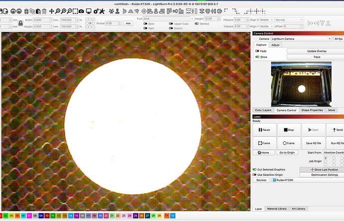

This is the image from Lightburn’s Camera Alignment Wizard. See the curvature of the lines? I don’t think I selected the fisheye option in the Calibrate Camera Lens utility . . . so it suggests to me that the camera is not directed at an exact 90-degree angle with the work surface . . . and accomplishing that, it seems to me, would be tedious with the lid closed.
OR would this “aberration” be “fixed” once I use the alignment procedure, aligning the lens with the targets printed on the work surface? I know that I followed that routine once, but didn’t get the results for which I was looking.
ALSO, is it possible to MANUALLY focus the Lightburn 8mp camera? Again, this seems like it would be difficult to do without trial-and-error since the camera is only properly positioned with the lid closed.
I’ve toyed with the idea of cutting a “lens-sized” hole in the lid of the laser. I can always cut another cast acrylic piece for the lid . . . but I’m not interested in rushing into things.
If it is before calibration then it is “normal” with a curved image. What “irritates” me a bit about your image is that it should be a larger area of your work surface, it will be adjusted later in the process but of course cannot be larger. That is, if it is the max view of your camera, then your mounting height is not high enough.
As long as you have your entire work bed covered, no matter how distorted it looks, it will be adjusted during the calibration process. As I said, my camera is not placed 100% in the center either, but I have approx. 5cm of coverage beyond the machine bed. On a daily basis I have a deviation across the machine bed of approx. 1-1.5 mm, but with a little fine-tuning, if I need precise placement of letters on a pin for example, then I’m at sub mm level.
Remember to put the height of your test piece into the chart, and when you print/engrave the 5 target discs at the end, you may not move them, they can’t (usually) be reused either.
