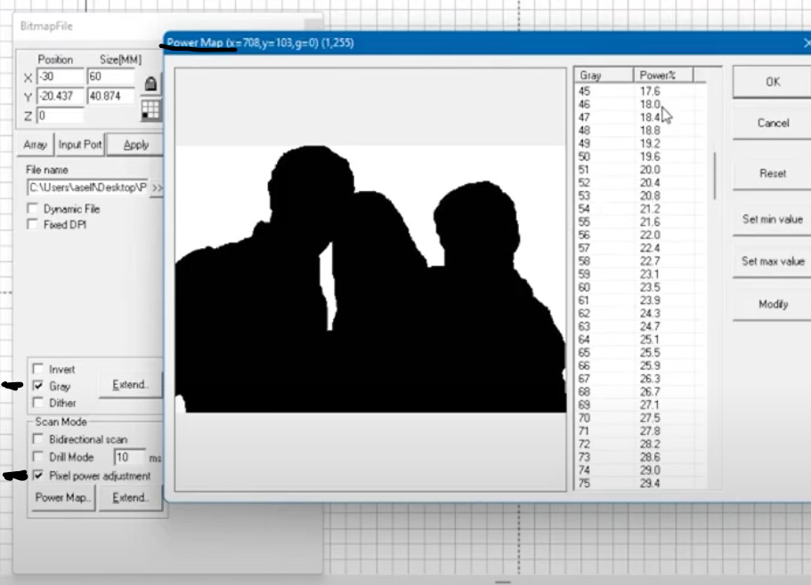

Watching a 3 year old EZ Cad video on photo engraving, is there a LB fiber laser equivalent for this? Seems like similar to depthmap.

The power map hits each dot once with varying power depending on the greyscale level.
Or am I missing som?

I think EZCad2 refers directly to a power change.
I’m a thinking, this is how a grayscale works?

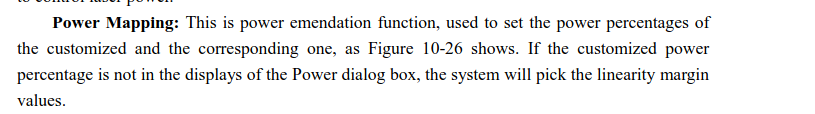

From the EZCad2 users manual (from OMG laser).
