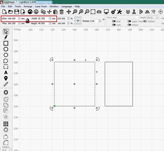

I feel really dumb right now but I can’t figure out, in a simple way, how to place two shapes next to each other with the edges perfectly aligned.
To achieve this, I drew the shapes, aligned them horizontally and resorted to mathematics to calculate where the center of the second shape would be knowing the both individual shapes dimensions and exact position of the first one through the value in the toolbar (upper left corner).
First shape - Width 36.7, center pos. 140
Second shape - Width 25.2, center pos. 180
Doing the math the center of the second shape is 170.95
And this is how I solve the problem. But I am convinced there is a tool or other way to achive the same but in a much easier way.
Can anyone bring the light to me? :roll_eyes:

I think the easiest approach in this case is to use object snapping.
  1. hover your mouse pointer over the corner of one of the shapes until the pointer changes to a reticle with 4 lines
  2. click, then drag the shape to a corner of the other shape. The shape should snap when sufficiently close.
  3. release mouse
This depends on “Snap to objects” being enabled in Edit->Settings.

Alternate to the method described above you could do the following. Let’s assume you want to align the left shape to the right.
  1. select both shapes
  2. align top or bottom as you see fit. If shapes are equal heigh then align horizontal center would also work
  3. select left shape
  4. Go to menu Arrange->Dock->Dock right
Thank you @berainlb

I just did this. It look’s what I am looking for. Or at least works pretty good.
Let me do some more tests and this can be a pretty good solution. :+1:

  • Object Snapping works fine if other alignments are not an issue at the time.
  • Dock works better if other alignments are an issue at the time.
