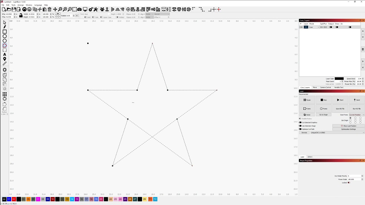

I did the circular array for a 5 point star. Took forever to figure out how to delete the lines inside the star. I’m still not sure how I got rid of them it but it worked.
Using the node editing tool, hover the mouse over the interior lines. Press the ā€œTā€ key on the keyboard to trim the line.
Faster still:
Create a hexagon with the same center, width, and height, then just change the number of sides from 6 to 3.
