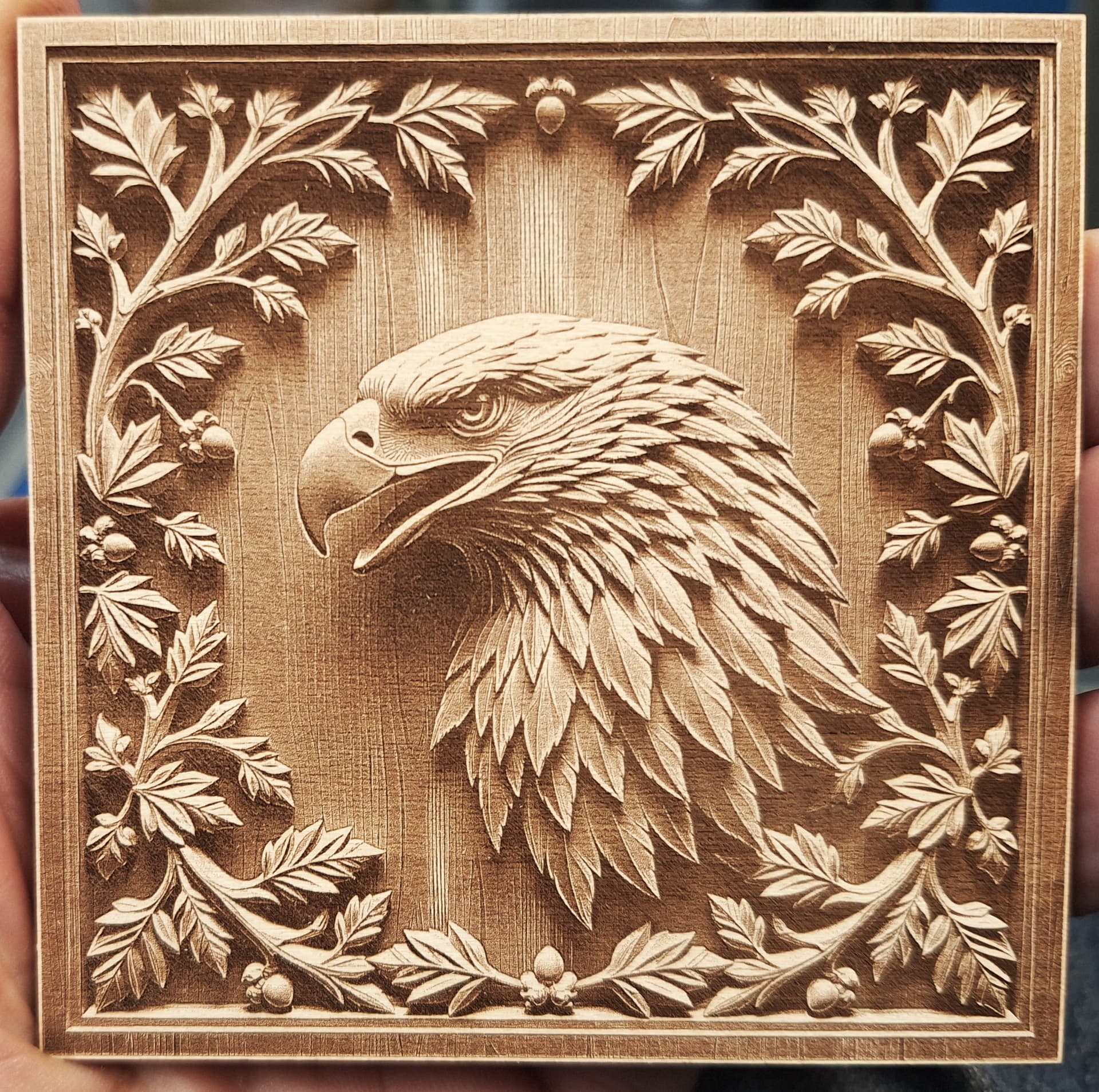

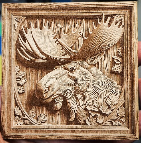

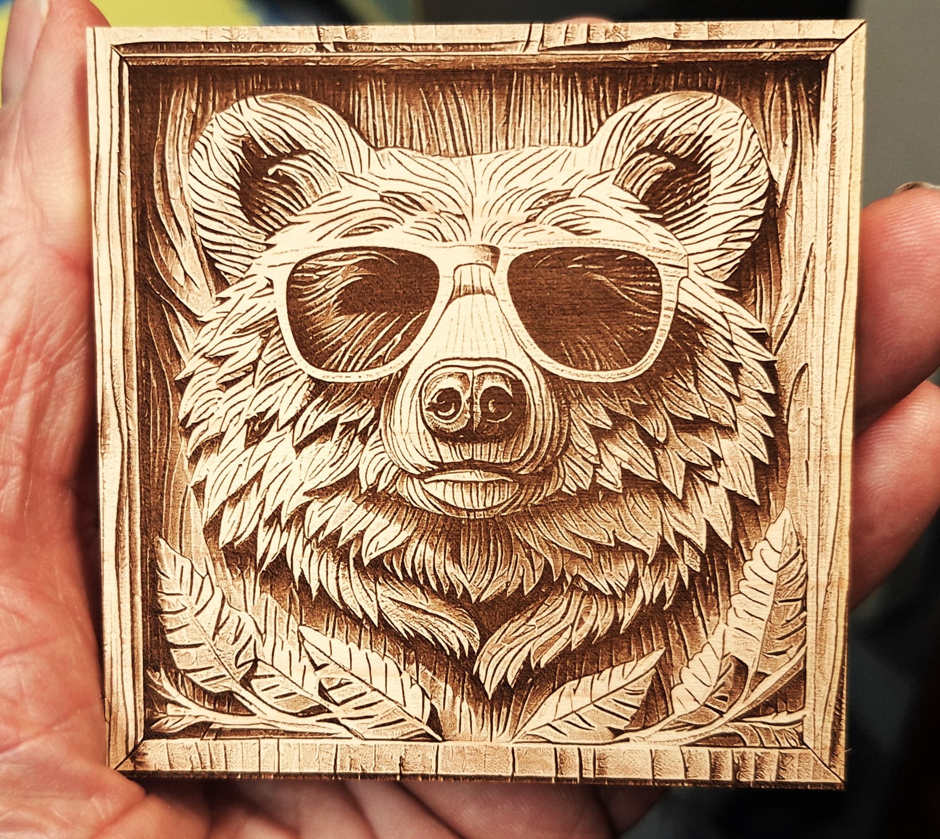

Playing with 5 watt uV on wood
Playing with Maple veneer wood
5 watt UV
120/45/6
LB stucki dither 423 DPI

Wow…
I should get a UV…
@Colin I got for wood
only a hobby
But Amazing stuff >>does not burn
I’ve got a 15W UV that I bought at the beginning of the year. It’s absolutely amazing the darkness and consistency you can get on wood with the UV. I can almost get black on some woods. Kicking myself for waiting so long to get the UV machine.
Great looking work there!
@sutick Thankyou ..yes they do a nice job >>but very limited in engraving size
Wow that’s incredible. I’ve never seen LE work so clean and sharp as this before. I can’t imagine how much it took to get dialed in to this level. You did awesome.
@AJR0679 Thank you

That’s some impressive work. That moose really pops! Is that one piece, or is it layered?
NoI mage from copilot AI
Can you share a few of your prompts? I can never get AI generated images to do what I want. :face_with_steam_from_nose: So, it would be nice to see what works for you since they look great. :grin:
@AJR0679 ..Thank You :+1:
They’re not mine
