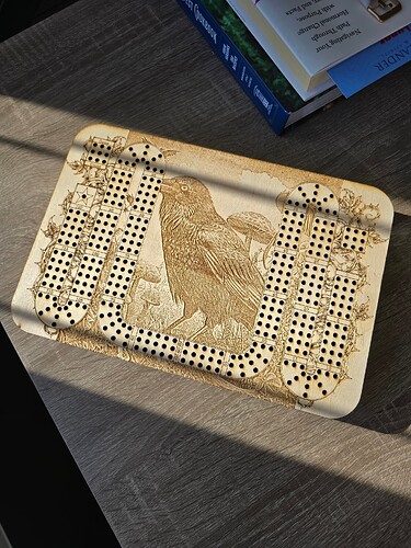

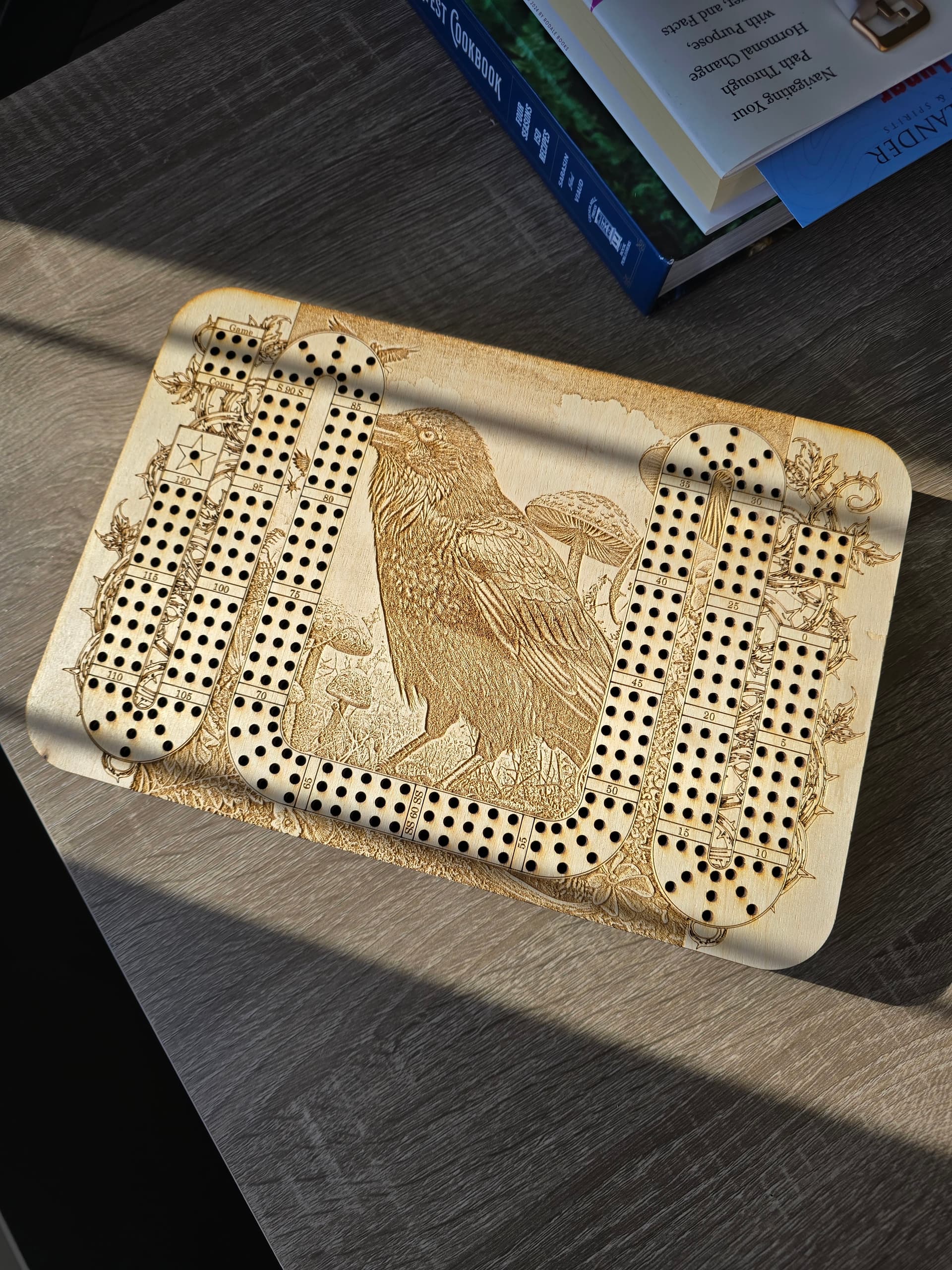

Why I believe this is that I can cut a materials card test card out of 3 mm baltic birch in the upper right section of the bed and get items the results I’m expecting.
I can cut super tight lines (1 mm wide left after cut) through with complete drop out and no pieces hanging on, just lift the sheet and everything is left on the bed.
But only on 3/4’s of the bed. My front right corner will not cut through at the same settings as the top left corner.
I have spent close to four days @ 6-8 hours learning and adjusting and reading and adjusting and watching and adjusting and nothing seems to cure it except raising power or lowering speed, of course this leaves me with differing results from one corner to the other on the diagonal.

I’m a little surprised that you can get the relatively nice result that you see in the last picture (if I understand it correctly). It shouldn’t be possible with a 3mm deviation from the squareness.
